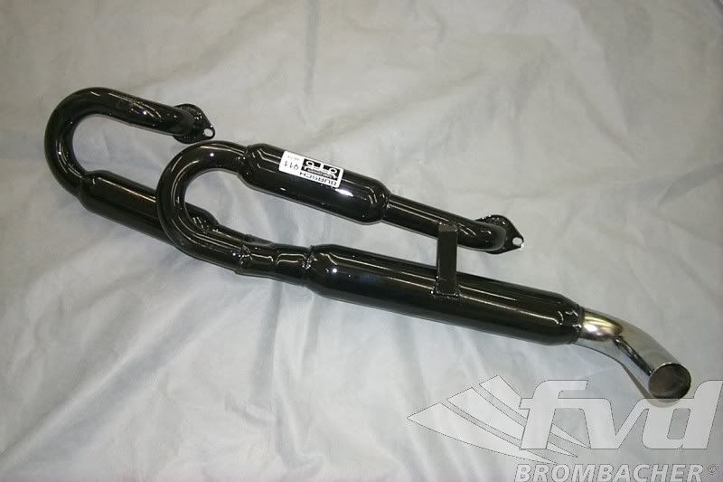

I was listening to some of your videos of the car auto-crossing and really like the deep growl of the engine. I note you mentioned it has a Bursch exhaust. Is it this style, with the glass packs or a different style?
Thanks
