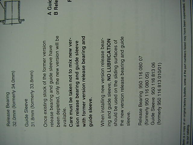

Got the new TOB and old starter gear installed on the new PP. Anyone spot mistakes? The inside of the new TOB is splined (?) whereas the old one is not. Curious.
Think I'll have the flywheel lightly resurfaced. Cleaned it with scotchbrite but there are some marks from the rivets or rivet relief pockets that are a bit stubborn.

The flywheel looks pretty good. I'd leave it alone. Just be sure to clean the stepped area above the clutch disc contact surface. This stepped surface is where the clutch housing seats.
The release bearing looks good. DO NOT put any grease on the inside diameter of it. It's plastic and does not require grease. But do put a LIGHT swab of extreme pressure grease or antiseize on the release bearing ears where the fork contacts it

I'm lucky that I acquired a small lot of Porsche specialty tools a while back. Two of the tools are the crankshaft seal presses for front & rear seals. They work fantastic.
Is it just me or is there a crack on the inside of the TO bearing as seen in your picture???
Non, c'est toi
Holly caca, It's a big one.

Originally Posted by JJ 911SC View Post
Non, c'est toi
Not positive I got your point...
Nor am I positive I know what the inside of the TOB is supposed to look like. Anyone care to chime in on this?
It was in reference to what zippy_gg thought was a crack inside the TOB (post #113) but I check PP and it got the same so it must be normal but I don't remember seeing it when I install mine. I'll check my photos.
