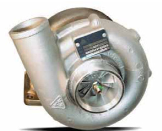

Banned
Location: Rockwall, Texas
Posts: 8,559
GS, I recommend you add one of these to your "to do" list!
Old 12-26-2014, 09:54 PM
gliding_serpent's Avatar
Join Date: Oct 2011
Location: Nova Scotia, Canada
Posts: 2,151
only one???
1997 BMW M3 (race car) with S54 engine swap "The Rocket"
1984 Porsche 911 3.4 Carrera
1973 BMW 2002Tii
2016 Ford Focus RS
