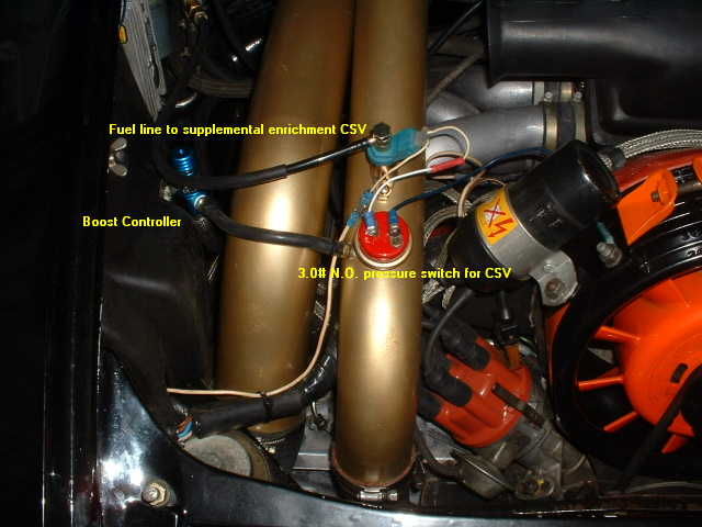

And the rear shot of the finished install:
Did about 45 miles this AM and noted that the turbo nows spools strong at 3200 RPM. At least strong enough to pop the fuel enrichment pressure switch at 3.0psi boost
That is about a 700 Rpm improvement over the old steel muffler where the back pressure was such that the turbo didn't spool until 3900-4000.
Big big difference in that straight outlet to the right side.
Now just have to think about washing the car.
Naw .... bad idea - too cold. 3F this AM.

Originally posted by tsuter
I am using the 911 CSV for supplemental enrichment and it is performing well.
tsuter, very nice work.
I was thinking about using the CSV a while ago for enrichment, but someone mentioned that the distribution of fuel would be very uneven between the 6 runners. Do you have any opinion on this, because I think it's a great solution if it is pretty even between cylinders.
Thanks
Colin
993
Old 01-25-2004, 02:49 PM
Original Owner
tsuter's Avatar
Join Date: Dec 2002
Location: San Antonio, Texas
Posts: 1,907
I am using a second 911 CSV for supplemental enrichment and not the stock location CSV.
My CSV for enrichment is located in the turbo outlet pipe so it has plenty of time to mix.
I have considered using the stock CSV but you would have to wire it to defeat/bypass the thermotimeswitch as the CSV is grounded thru the thermotime switch. Fancier wiring for the pressure switch.
Then you would want to make sure that your air box has the later style internal intake runners for the CSV for better fuel distribution.
Might work - but I never tried it as it was easy to just plumb in a second CSV.
