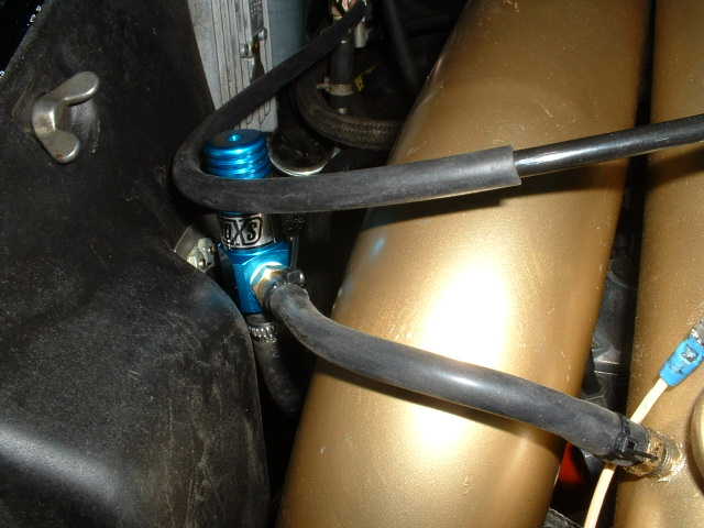

I was just looking at suters pic I quess it goes to the throttle body. Where in line could I put a boost controller.

Should be the rerouted old AAV connection for fast idle on cold start. Needs to go to the back of throttle body since the connection on the old CIS boot is now gone for air bypass.

The MBC goes in your wastegate control line. See page 4 for the plumbing details.
I installed a barbed fitting in the turbo outlet pipe for this purpose. It is not part of the BAE kit as it had no wastegate or MBC.

You can route the oil tank breather hose to an unused fitting on the lower right side of the airbox. It may be capped or need a hole punched thru it.
See picture of breather hose (large hose) and clamp on this fitting.
