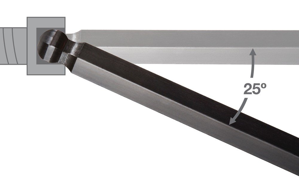

Please help; would greatly appreciate your suggestions for removing the top 10 mm hex nut on the starter in my 1984 911.
Yesterday, I jacked up car and have jack stand on passenger side and removed passenger-side rear wheel. I've disconnected the battery ground, and the two red wires and the yellow wire at the starter. The lower 10 mm hex nut is readily accessible. When I crawl under car with my head facing front, I can touch the top 10 mm hex nut with my fingers on my left hand. I have two 10 mm hex sockets, a standard one about 1.5 inches long with a flat end and an extended one about 3 - 4 inches long with a rounded end. I can engage the top hex nut with the extended hex socket, but am having difficulties with fitting within the cramped space, the further extension(s) and socket wrench need to turn and remove the nut.
Any suggestions would be greatly appreciated.

6" allen socket and a fine toothed ratchet, worked from the driver's side of the trans, over the top with your right hand.

And a round end allen socket would help.

Thank you all for your helpful suggestions. Tonight, I bought a fine tooth ratchet and upon fiddling with it, I see the mechanical benefit it will provide in this application. I checked at Sears and Home Depot, and neither had the 6 inch hex socket. I checked the HF website and they have it, I'll swing by the local HF and see if it's in stock. Thanks again for the helpful suggestions. I'll let you know if I get the starter out. Steve

John Walker: thanks again for your suggestions. I was able to get the starter out today following your instructions.

Can you post a picture of the socket & ratchet you used for future reference?

10MM
