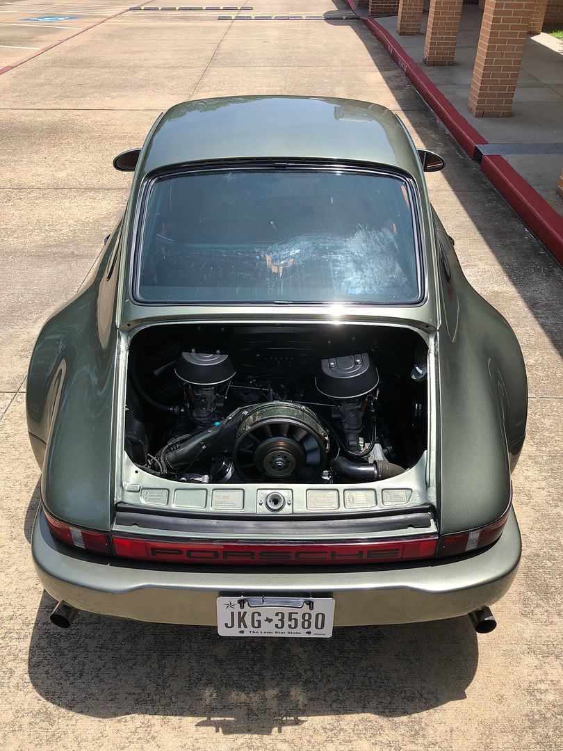

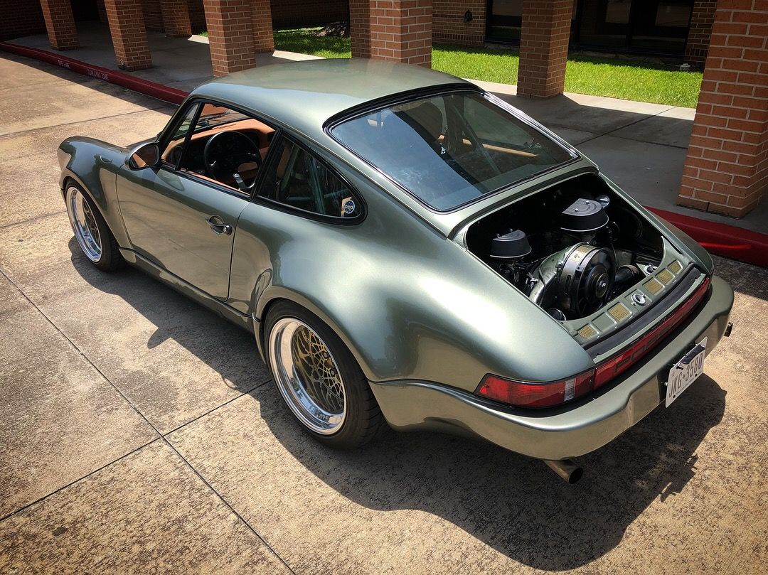

Triumph setup, running for a few years now.
Wheels on this car are sensational...
