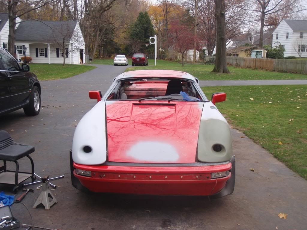

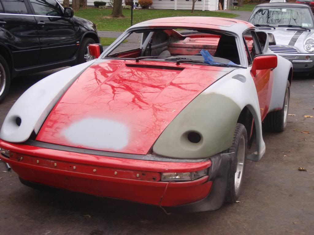

Fenders came in today. they are going to take a bit of fitting to get them right.

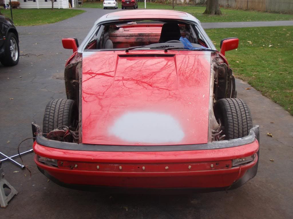

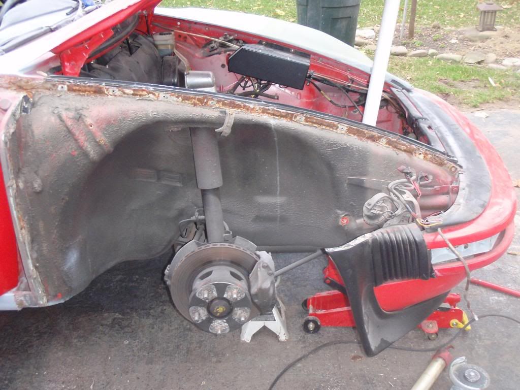

OK, Taking a break from the engine till the cage is in later this month. (I will do the wiring harness this weekend)
Back to the bodywork:

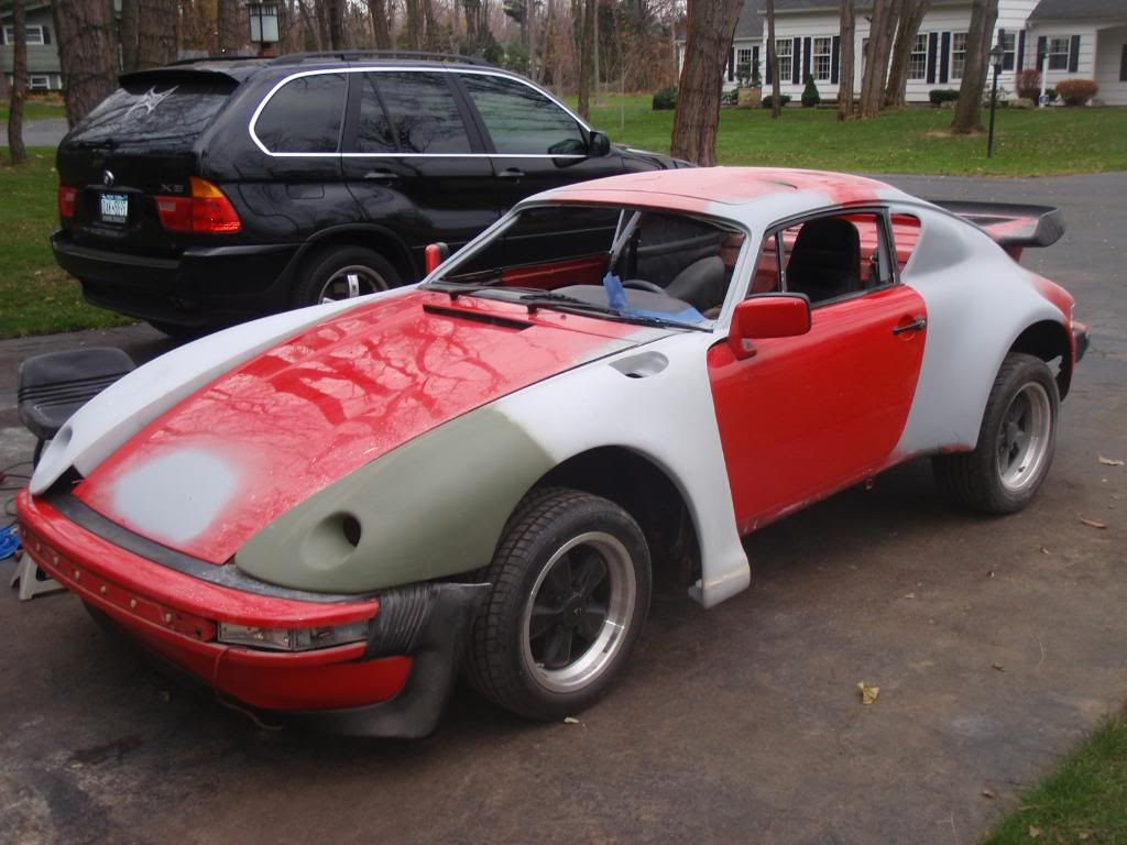

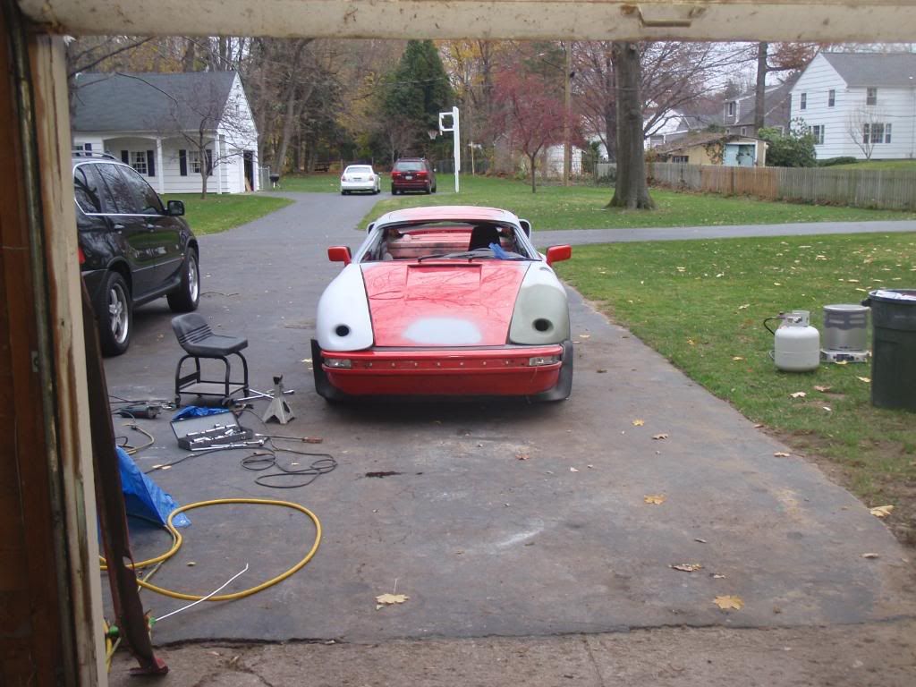

did a little bodywork and a lot of leaves this weekend.
I have lots of fitting left to do. This is just test fitting
Justin stopped by to give his professional opinion:

If you are still taking suggestions I would consider getting some of the bosch 993 headlights for those fenders. Slightly more effort but it would get you back a little closer to the spirit of the car.
1989 Carrera 3.2L in 993 bodywork
Old 11-15-2009, 02:14 PM
Rebel911's Avatar
Join Date: Jun 2009
Location: In the Driver's seat
Posts: 273
I will look into that, thanks.
below is where I am going:

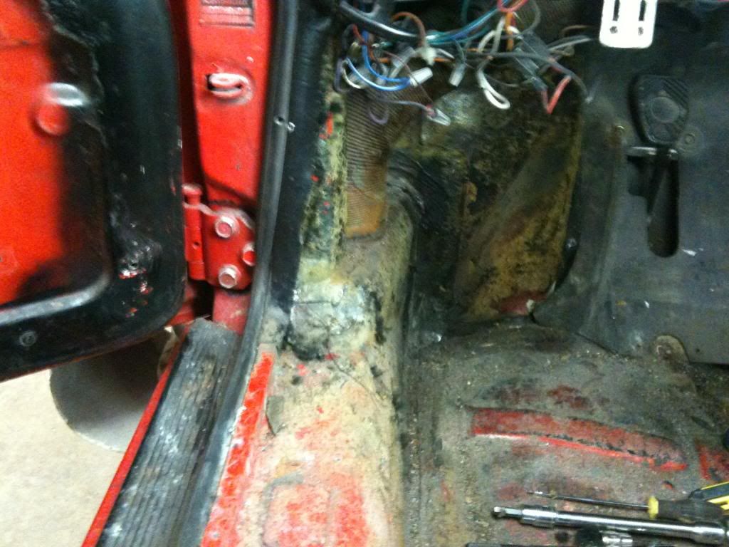

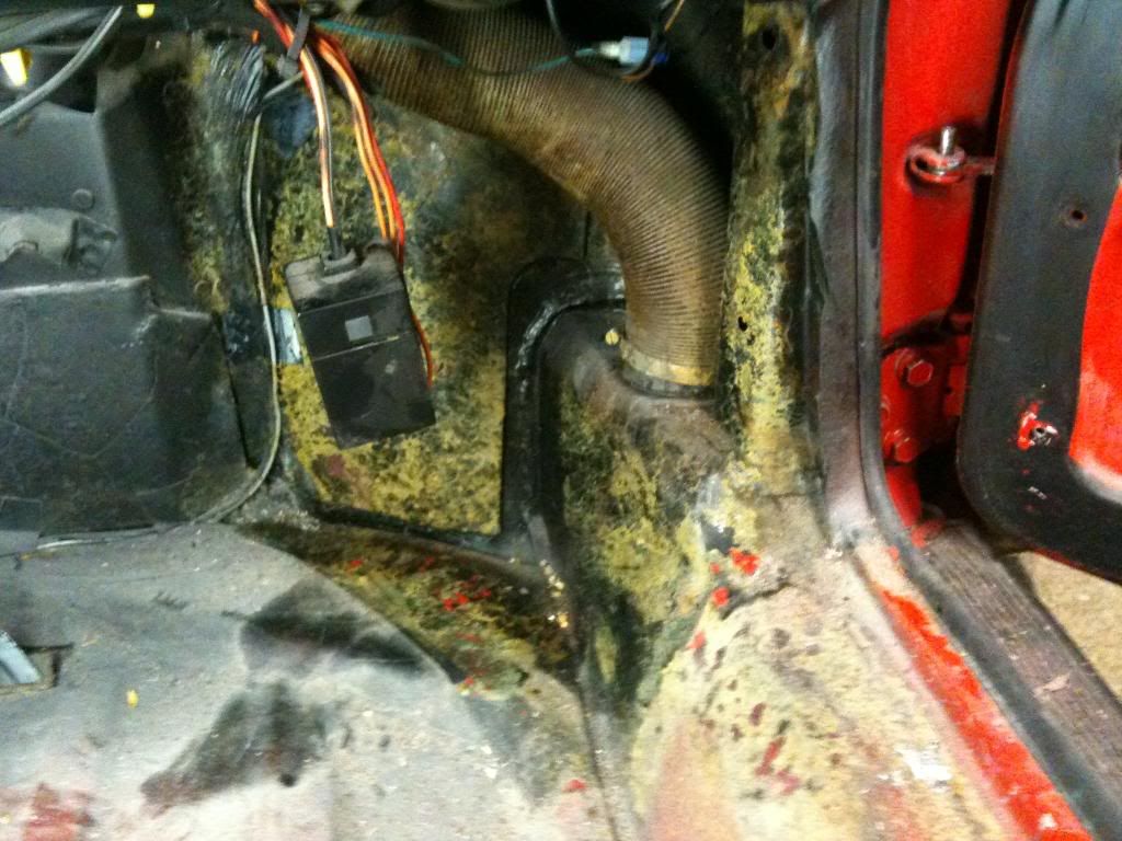

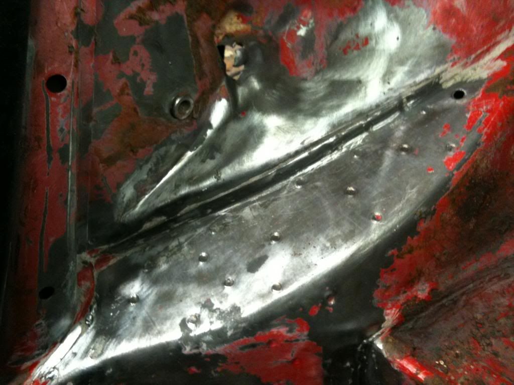

Cleaning it up for the cage/bracing to be put in. I had to remove the back seat; it will be going back in around the bracing.
I still have to clean where the door bars are going to the front.
When I was pulling all the crap out from under the dash a brand new set of keys for the car fell out from somewhere under the dash. Later I will grab some pics of the rats nest of **** wiring that someone hacked up in the dash.

I'm confident it will be a great car when you're finished. I'd like to make a suggestion on the paint. If you paint the air inlets black and hold the edge to where the window would have been. You'll be able to hold onto the classic 911 look.
Here's some bad photoshop of what I'm talking about. I'm sure you have it painted in your head already. Just a suggestion.
Good luck.
Tom

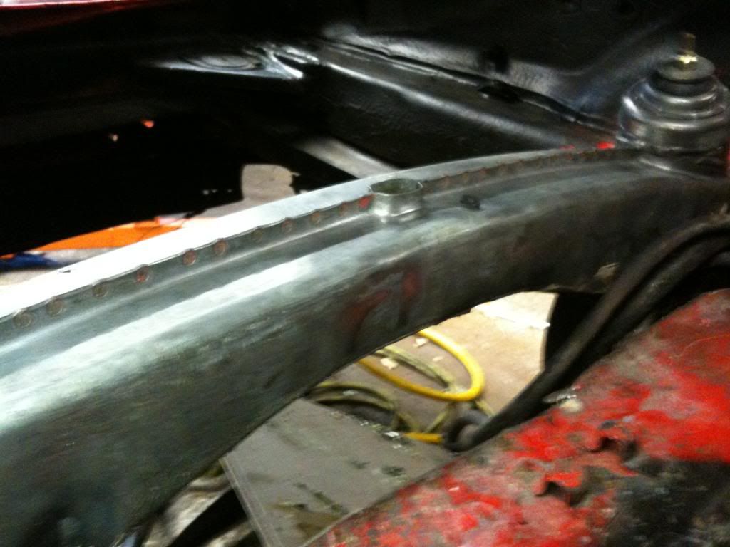

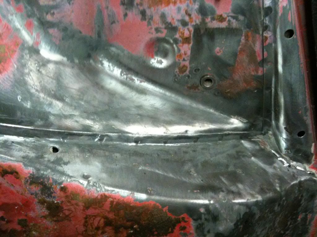

Went to visit the car last night at Dan's (aka: Reactive Chassis Co.)
He is building/fitting the cage better than I expected.
He is putting in double door bars this weekend.
I can't wait to get the engine in.

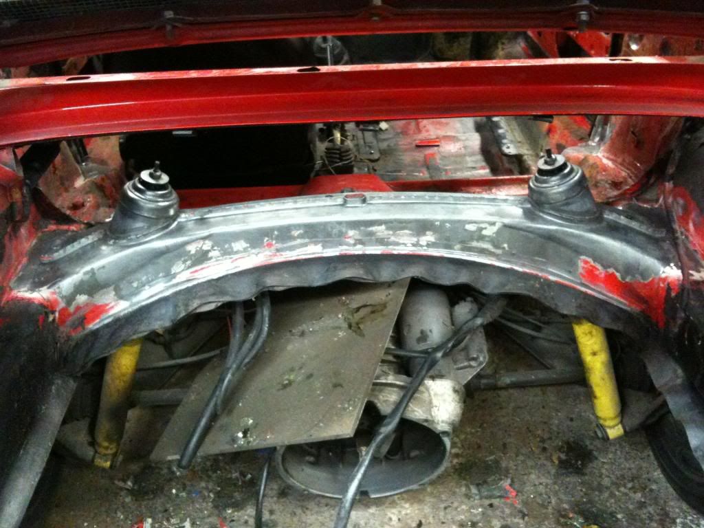

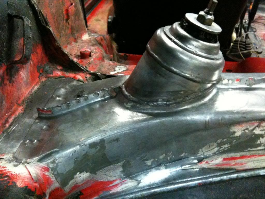

Roll bar looks great but one concern about the cross member and bar that is welded across it. If you are using the RH intake I do not think you will be able to make the clearance. I had this initial problem and had to make some modification to how the engine sits in the cradle to give it about 1/2" to clear.
Attached is a picture of how close the throttle body sits against the cross member.
Hope this helps
