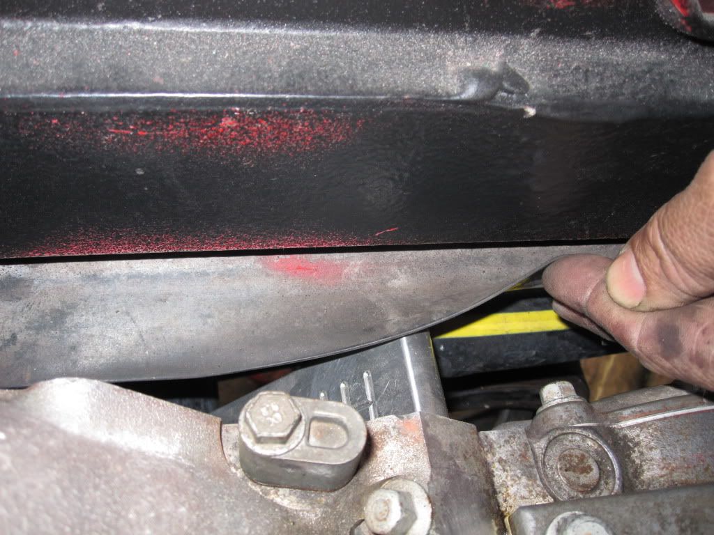

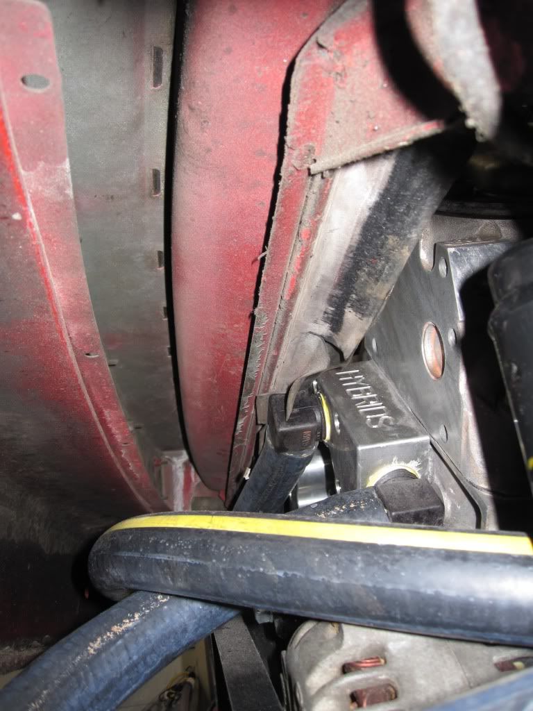

Right now my problem is the "f" brackets on the front of the engine. the water inlet and outlet.
they are going to hit the rear cross member.
I didn't pull the tranny out so that should be lined up right. engine is mounted right on the tranny but it is still hitting in the rear.
any ideas?
I am going to cut and re-weld the cross brace in-front of the throttle body.

Hi Rebel911, how much space do you have between the block and the rear cross member? Can you upload a photo?

Here are some pictures. any ideas?

just looking at the second one again; i could possibly remove the 90's and put them back on after it is lifted up.
or even just take off the "f" bracket completely then put it back on.

install
i am assuming that you have not mated the trans and the motor in this last picture. i believe that i would remove the transaxle and and install on the motor and then install as a unit. hate to keep harping on this but i have found that this is a much easier way to put in place. how much clearance do you have at the torsion bar tube. my chassis is a 71 and i had to modify the transmission mounting plate and move the transaxle approximately 1 inch forward on the mount and hence the motor is located similarly. you might have to remove the throttlebody on the rear and install once the motor is in place.
