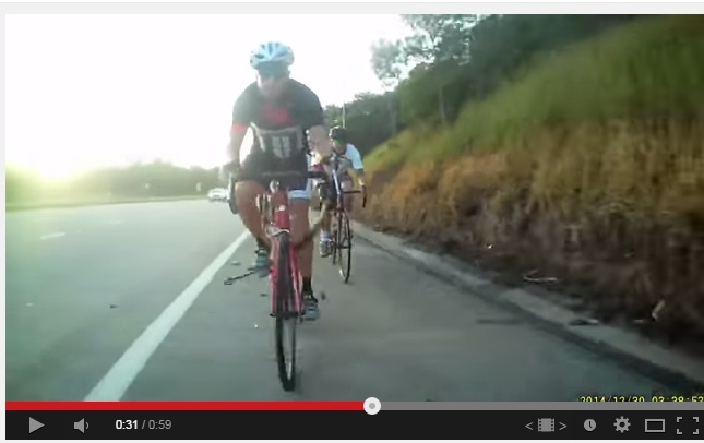

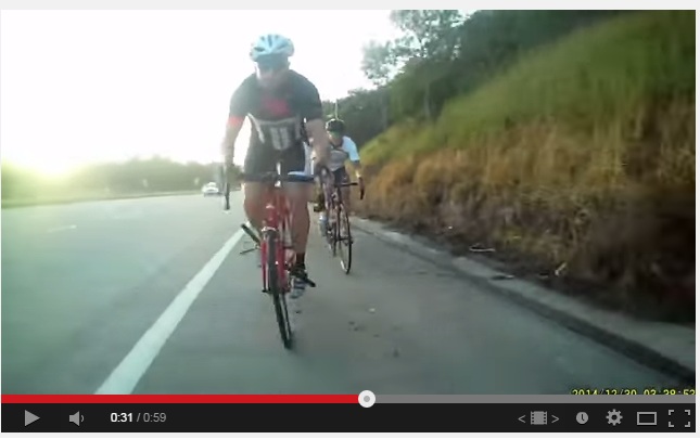

Here are some frames
Crash1 just before the bar gets picked up
Crash2 the bar is behind the fork crown, it moves around in a few different positions back there and the wheel starts to deform
Crash3 the rider is starting to lift off the sadle and pitch forward, wheel is deformed, bar still behind the fork
Crash4 the rider is going over the bars now, rear wheel far off the ground, note front wheel and fork still on the bike and bar still visible behind the fork
Crash5 bike is high in the air, you can see front wheel still attached
Later you see the bike land pointing straight down, hitting with the leading edge of the front wheel.

You're right Curt. My eyes are crummy.
That looks like only about a third or a half of the spokes cut. Seemed like the front wheel rolled more than that, but I'm not sure. Maybe it wasn't "rolling".

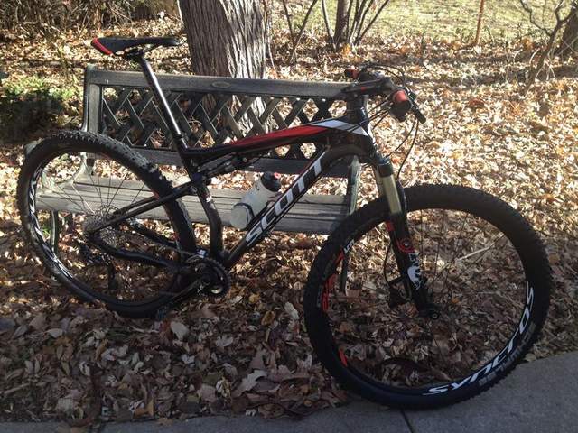

New race rig.

Something in the spokes is always bad, whether the fork breaks or not. The way that bike flipped, it appears the rider was ejected by the wheel locking, and the fork broke subsequent, either due to the bar impacting it (likely, given the shear) or the ground. Steel fork would have caused same crash. Rider was lucky, I've had a number of cases (never actually sued anyone, just folks that came in) with broken forks where there were major helicopter ride type facial injuries from riders hitting the ground. I try not to think about it too much.
