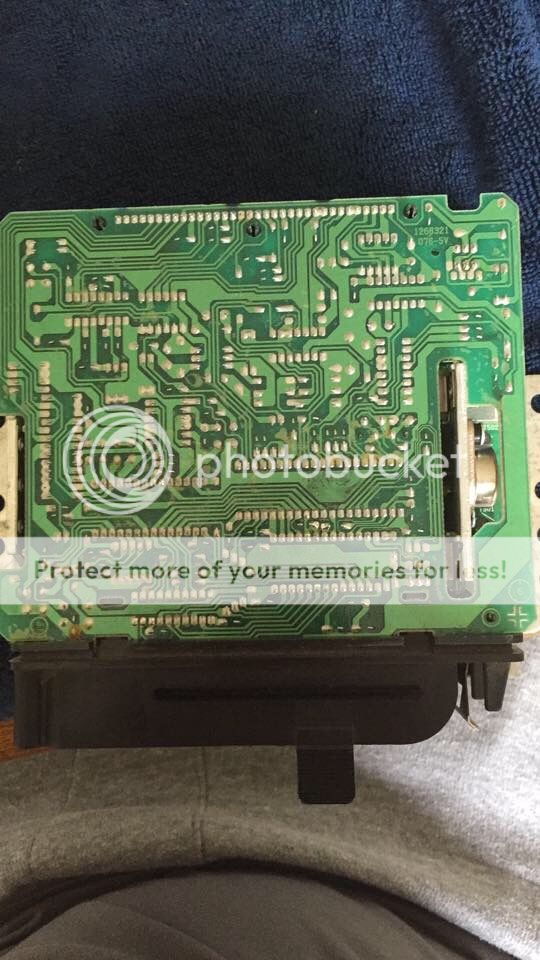

I have a picture of my DME although it is not HD nor is it a close up... It's only of the outside/top side. I can't say that I really enjoy playing around in there.

Solder issues are usually on the other bottom analog board. That top board never really has solder issues.
It was unclear how to get to the bottom of the board without breaking anything. I'll test it in my friend's car and if it's faulty we'll go from there.

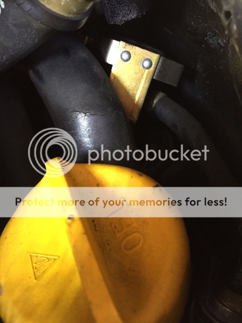

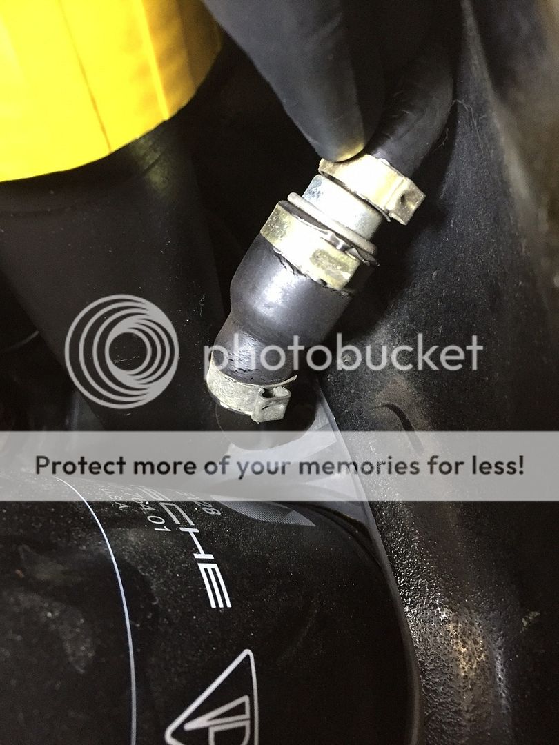

Hey guys,
Small update from yesterday.
1- Got the DME back into my car;
2- Replaced the silver coil with my previous black one;
3- Looked over some of the vacuum lines and found 2 (pictures bellow) from the oil fill neck that definitely look worn although not sure if they are leaking. I sprayed throttle body cleaner over them and around the intake runners and other rubber joints with no impact on the idle;

As for those hoses with cracks in them they all need to be replaced. Don't even bother smoke testing or any other air leak testing till you replace them. Any crack in those oil breather hoses is bad.

You mentioned that it's idling at 1000RPMs, this is wrong. The early cars 84-86 idled at 800RPMs while later 86-89 at 880RPMs. If it's idling at 1000RPMs it's a red flag that something is not correct. Often it's the idle switch not making contact.
The other thing that strikes me in those videos is how it almost seems like you're hitting a rev limiter at 5800RPMs. Are you sure the tach is accurate?
My thought exactly. He mentions and it shows 5600 and hesitation. Also agree that the hoses should go.
I can't hear the hesitation in your video clips but are you feeling the car stutter a little? It seems too balanced that it's popping at the same RPM. It's almost like someone moved the rev limiter back in the rpm range by about 600 rpm.
Are you hearing any popping in the exhaust? Normally if you're lean you'll also hear a "lean pop".

I agree it's hard to see in the video. It's like if the engine cuts out... As Sal mentioned it almost feels like a Rev limiter.... It obviously scares/surprises and I let off the gas which is why it's hard to see in the videos. If you can get the volume high enough you will hear it. I only let off the gas once it hesitates thus the initial lack of power is unintentional...
No popping/backfires or anything out of the ordinary from exhaust.
