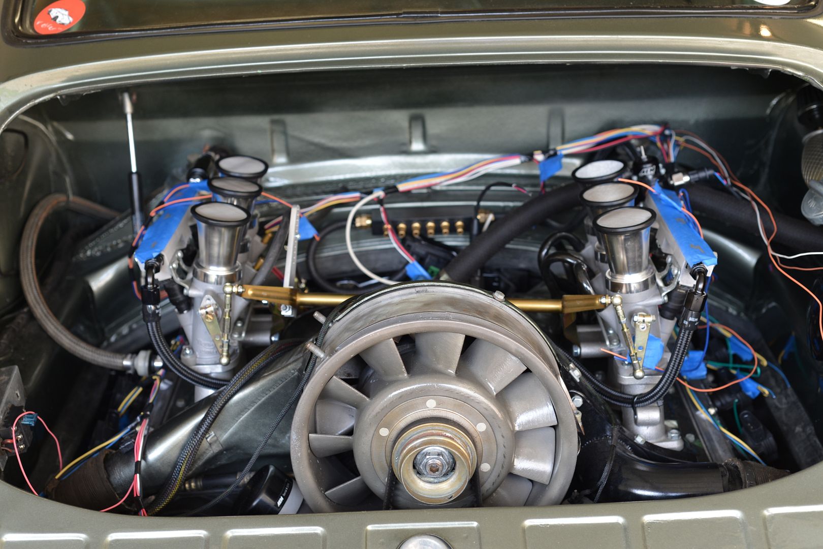

Quite a project. Just wondering why you didn't rotate the throttle bodies 180 and put the fuel bars in the middle. That would have given a straighter line into the intake port if the manifolds were cast with a slight offset to the valve cover sides.
Bob B
I've never seen that done that way?

Thanks! Honestly, the reason I went to the solid linkage is because i think it looks cool. I'm sure the cable setup would have worked fine.
Originally Posted by NICE 69 S View Post
Quite a project. Just wondering why you didn't rotate the throttle bodies 180 and put the fuel bars in the middle. That would have given a straighter line into the intake port if the manifolds were cast with a slight offset to the valve cover sides. Bob B
The way it is now is a good balance of the injector path and airflow into the intake port.
As noted above, when i first set these up I was going to use cable linkage. The way the linkage hooks up to the ITB's is on the fuel rail side. This would have allowed the bellcrank in the middle of the engine, with the cables running under the ITB's to hook up to the ITB linkage. It could have worked the other way around, but it would have been tight. This configuration gave me a little more room with the cables to sweep around.
Also for my fuel setup I was mimicking the fuel setup from a 3.2 with the fuel rails on the outside.

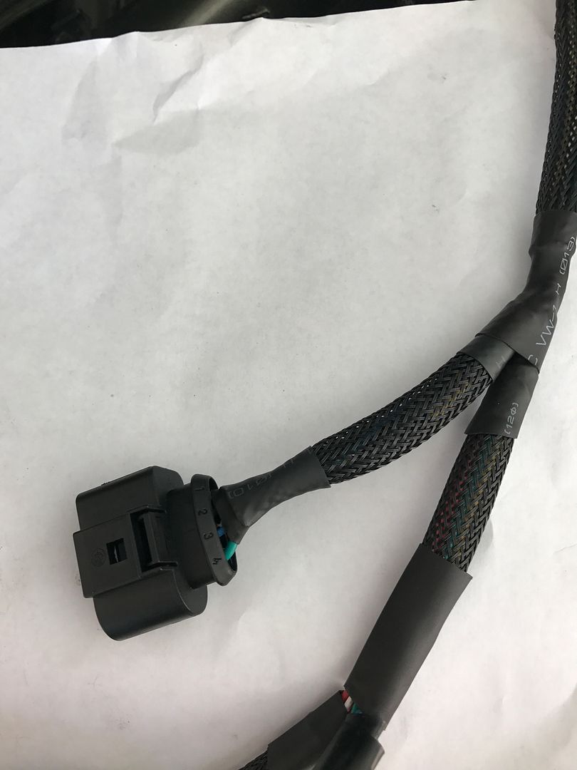

Wiring has continued
All new connectors and terminals were used for every plug.
Insulators on the coil pack wires
Wires stripped
Terminals crimped
Braided wire wrap on
Plug on, heat shrink shrunk
And repeat

Beautiful wiring job! When I redo mine, I'm going to crimp rather solder, so 0 splices.

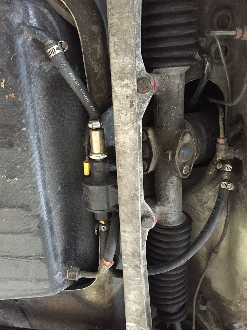

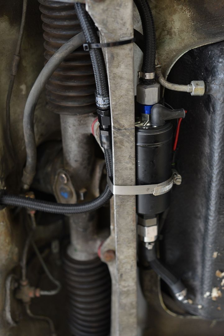

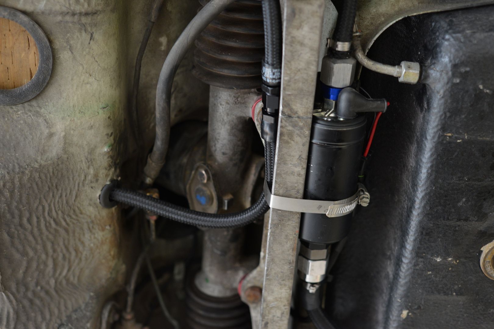

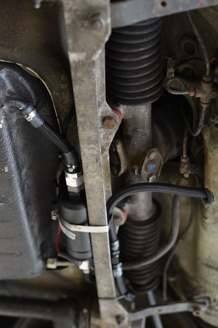

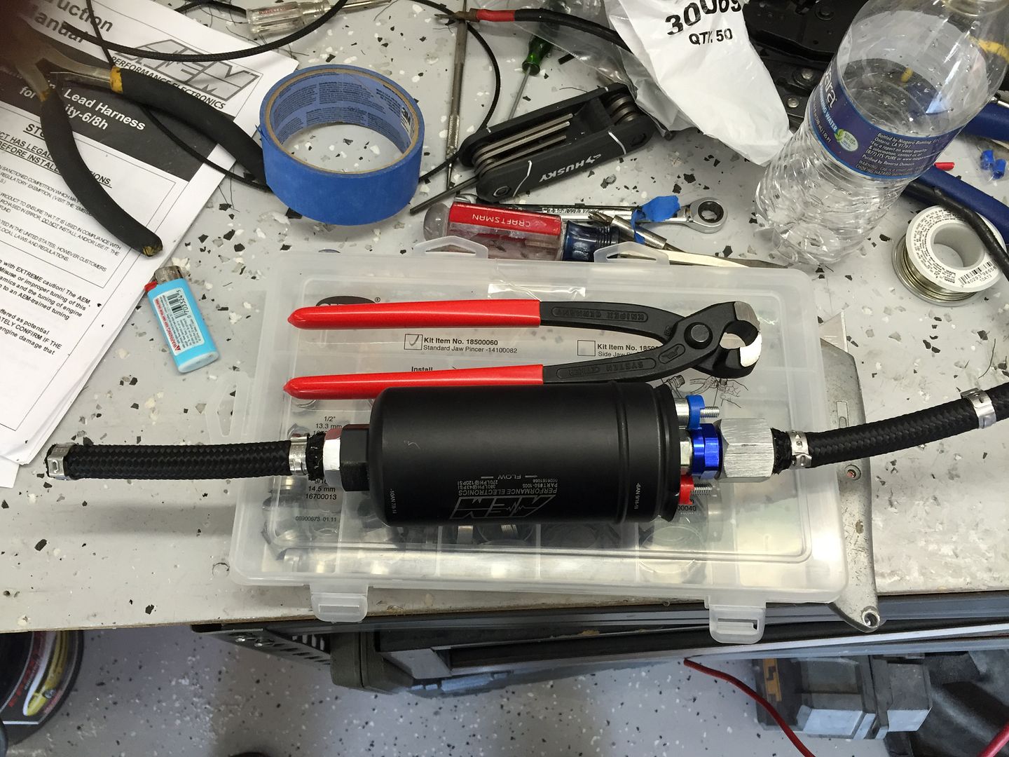

While the wiring was moving, I also worked on the fuel.
The car was setup previously with Weber's and had a low pressure fuel pump installed.
I used an AEM unit to replace it.

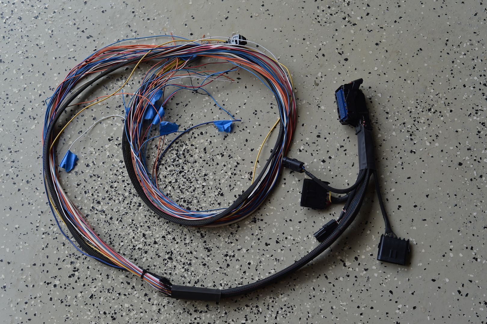

So more wiring. I missed this pre-install pic of the main harness
Laying out the wire runs to all of the sensors
And installed a -6AN fuel line between the two rails
Vacuum lines from each TB to a vacuum manifold

What crimper are you using? Are they double-crimp?
