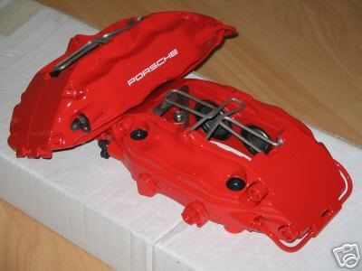

These are teh Audi ones they look to be similar to the 993 medium radial mount.
Would I be able to fit these with an adapter do you know?

Those are Large(aka Big Red), radial mount. It is difficult to tell the difference between them and the medium large 928S4/993 front caliper as there is < 10mm difference between them.
the large calipers need a larger rotor than the medium large because the ~10mm difference is all radial, so generally the large calipers cannot replace the small unless the rotor is ~320mm or better in diameter.
When the large replace the medium-large(rotor permitting) the same adaptor(if any) is used.

That sounds like the rotor for the large(Big red) calipers you pictured. Though sometimes they used the medium-large calipers on them as on the 3.3 965s

So if I understand you right. I can fit those but would also need to buy bigger rotors and an adaptor.
I have a source for the adaptor but would the larger disks fit straight on a 964? I asumme I would use the 993 TT disks?
Sorry if these are silly questions I have never changed out calipers or disks for different versions. on any car let alone a Porsche.
would it be safe just to upgrade teh frints and leave teh rears standard on a C4?
Many thanks for your time and patience in helping me it is much apreciated.

I am confused now
You are looking for calipers for a 964 C4?
If so then yes, you can get the 322x32 you need a caliper adaptor
blue
964 hat and 993tt rotor
and
993rear 30/34 calipers on the stock 964 rotors
Bill Verburg
