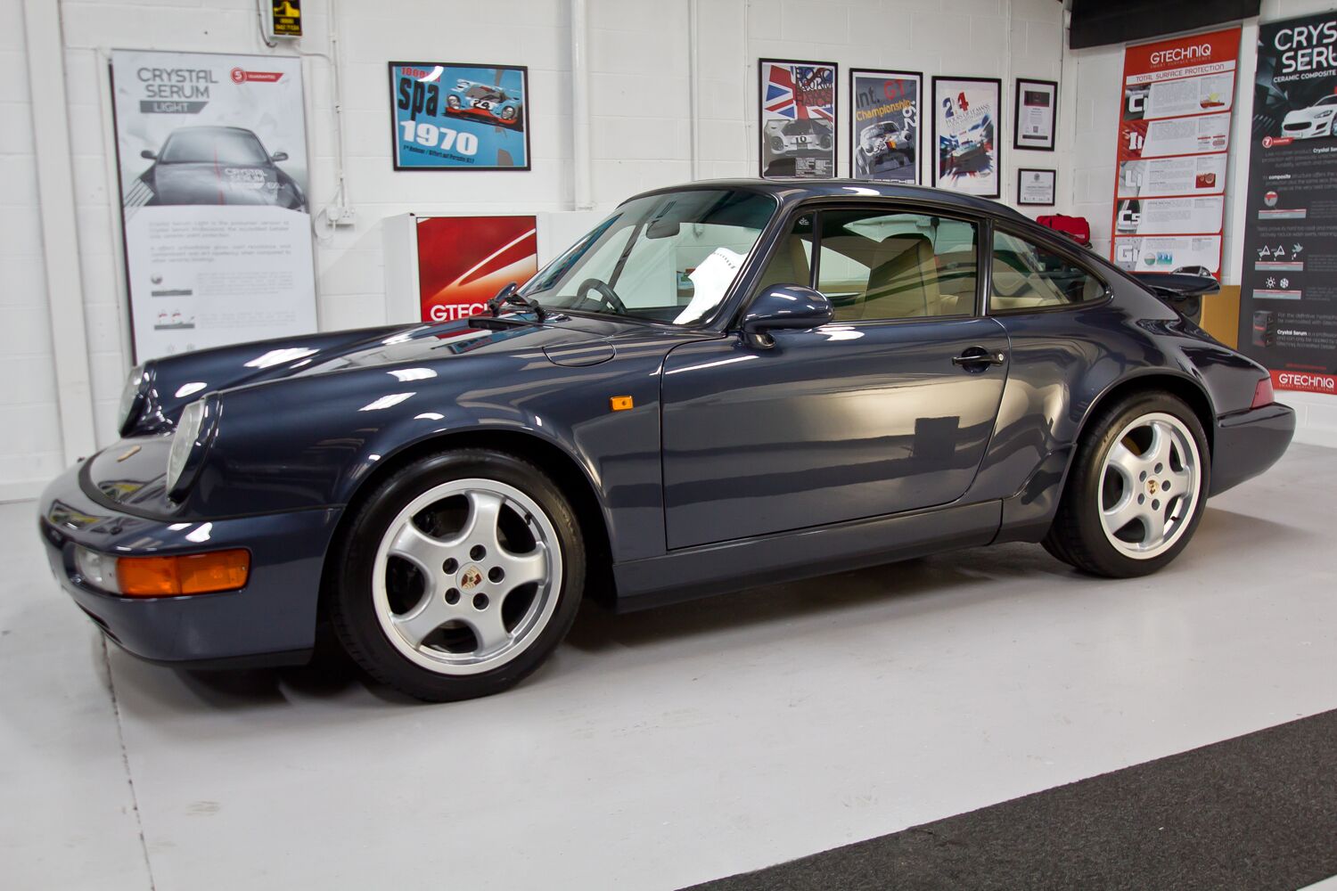

What am I missing from this 964 purchase? (pic & info heavy topic)
So following from my previous post, the SC I went to look at was lovely, but I just don't think I could pull it off as a daily. I'm nibbling on the bottom of the 964 market and fancy a go at buying one.
The car in question is nearing 200k miles, so I'm aware things will be tired and need replacing. However, the car also benefits from a lot of recent work done, including an engine rebuild ~24k miles ago (4 years) and a window-out respray (4 years ago).. The car looks gorgeous in person. I'm worried that it might have been "spruced up" too much, and it might be hiding a bunch of problems.
It was listed at £45k for a few months, and has just been reduced to £40k. Automatic estimates put this car at £32k - although I wonder if that's not taking into account recent work done.

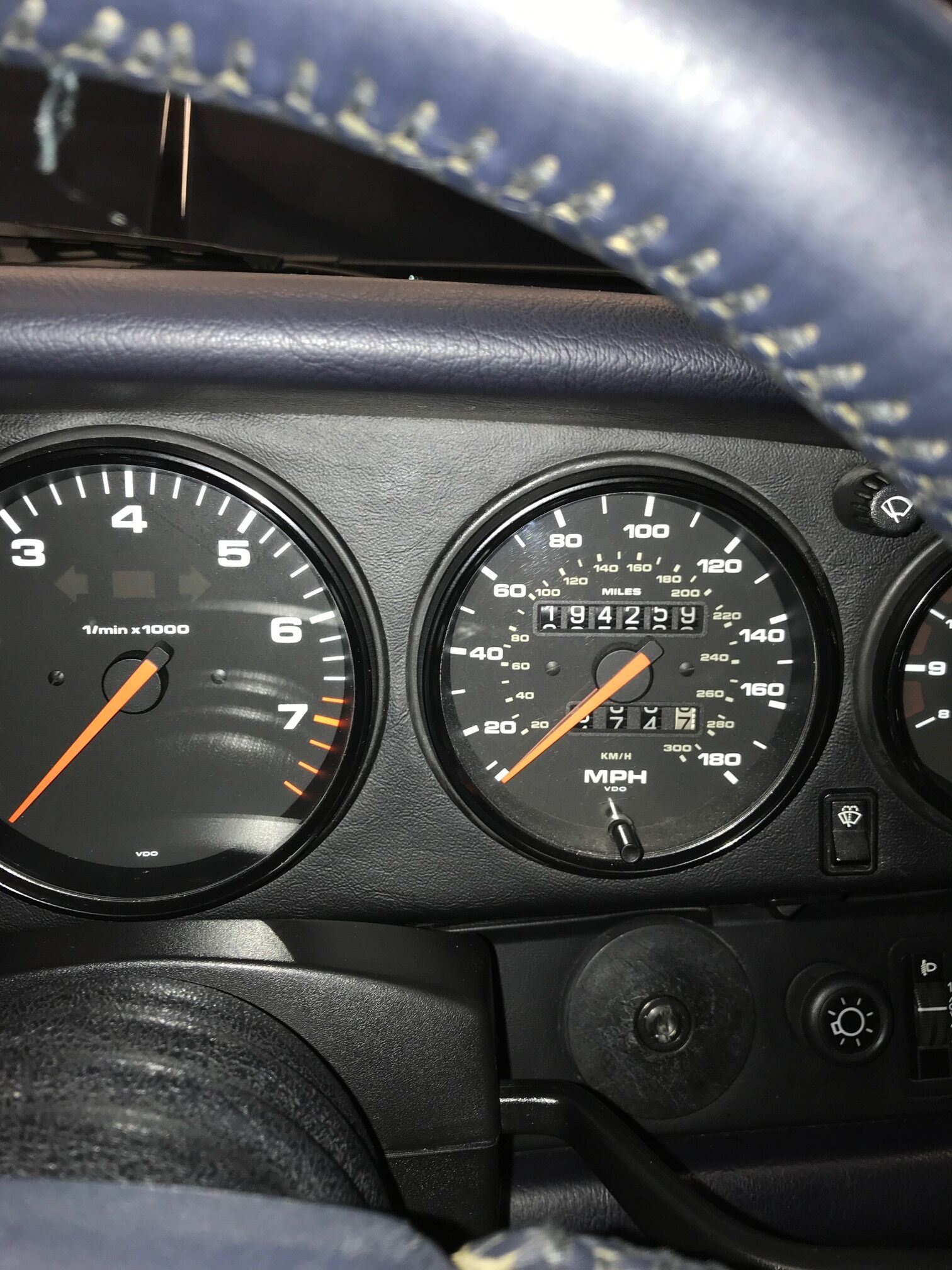

Should I be put off by the high mileage? It's kind of a turn on, and I'll be putting miles on the car all year round, but I realise I might be buying a money trap waiting to bite.
Key Work carried out:

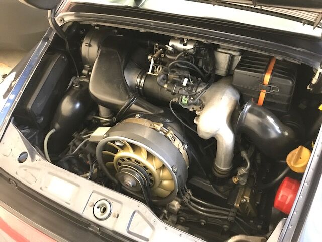

  • Engine rebuild, 24k miles ago, ~£7k/$10k (receipt of work carried out here - is this considered fairly comprehensive?)

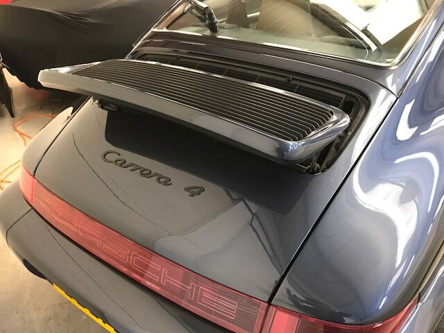

  • Mar 2017 - Rust cut out of several areas of the car, respray, rebuild ~£5k/$7k
  • Jul 2017 - New engine lid, struts, plug lead cover, spoiler transmission, new rear bumper brackets, roof rattle fix, weather relay fix, front brake backplates, corroded fuel lines, suspension springs replaced £5k/$7k
Car history looks good, it had some structural corrosion in 2007 which must have been fixed, but other than that it's the usual "fails" on MOT such as springs, head lamps, that sort of thing.
All important photographs
Thanks guys.

Have you driven it yet, or any 964? It's a totally different beast. Yes, it's faster and more modern/comfortable. But it feels heavier to be personally is not quite so vintage 911. It tips into modern car territory, which may be what you want. Just something to consider.
Gorgeous color. That excites me. Rebuilt engine is nice. Probably going to need a lot of chassis based work going forward if it hasn't have a bunch of rubbers, struts, brakes, etc gone through yet. That is a lot of miles, but nothing the chassis can't handle. How about the gearbox? Has it ever been done?

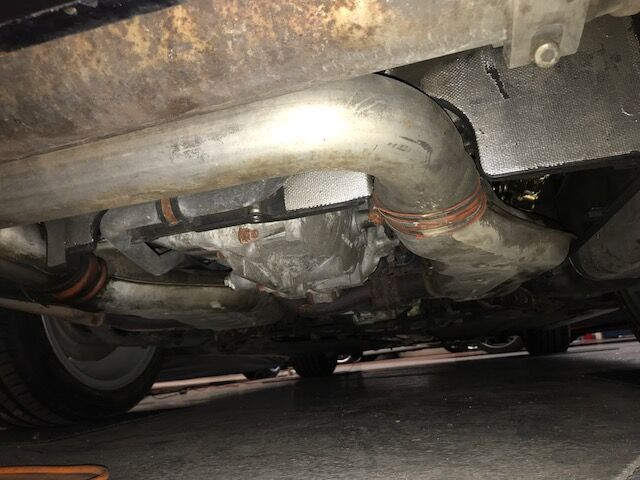

Oops, I missed that it is a C4. Walk if he doesn’t have 8-10k in tranny receipts. There are all kinds of C4 only things that will be big money to repair when they go.
There is a rumor Colin at 9m is working out a 2wd conversion kit. I passed on developing it for him because I don’t think the market is there. He might be making it without my help.

Looks like a clean 200k car from the pictures. Definitely look into all the rust repair. Engine rebuild is a major bonus. Did they machine the heads? Go drive it. It's really different (in 911 terms) than a SC especially with the AWD system. A sorted G50 should feel way more modern and precise than a 915. 964 coupes are probably the hottest 911s in the states these days.

I guess the whole AWD system in general is prone to failure? Or are they fairly reliable? There's a few garages over in the UK that do the conversion, but it costs 5-10k depending how far you want it to go
What sort of issues should I look at when shifting through the gears?
As far as I know, there isn't any receipt of gearbox work

I've heard the AWD system in the 964s are reliable but expensive to fix if something goes wrong (lots of moving parts). If you do a search on Rennlist there are plenty of threads with loads of info on the subject. As for the gearbox, feel/listen for any grinding or sticky gears. Sticky clutch also comes up sometimes on these. You should be able to rip through the gears on G50 unlike a 915 which takes a little patience and technique.

This. It is robust. It’s based on the 959 systems. It is part of how they amortized the costs of that car. The expensive bits are awd and differential based. It’s actuatirs and sensors, and clutch parts. It’s integrated with the abs too. The transmission portion is pretty straightforward. It’s a gearbox, does it shift. But does it howl? Any dash lights? Any weird jerks and lurched when you get on it hard? Be sure to get on it hard.

That's a beautiful looking 964.
I've had both a 964 C4 and my SC (at the same time) and the 964 is my preferred daily, while the SC would be the preferred weekend car.
Those C4s are fairly robust cars. I don't have much to contribute that hasn't been mentioned already but mechanically it looks well-sorted, I'd be more inclined to dig deeper into the type of rust repairs done and how they were done.

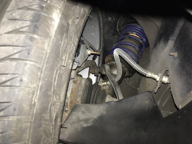

Receipt looks fairly comprehensive but it would be nice to chat with the guy who did the work to get a feel for what else he might have recommended that was denied by whomever was holding the purse strings.
Structural rust? What part of which structure?
The springs look to be H&R as I’ve just installed a set for a customer who’s building a 964 RS replica. These springs usually drop the rear an inch and front 3/4 inch (perhaps vice versa but a mild drop nonetheless). The car appears to sit to high if those are indeed the springs used. I would ask to make sure it was four wheel aligned. A good alignment makes a huge difference on these...
Unfortunately it doesn't say anything about where the rust was - just it failed a test 10 years ago due to the rust... By law they'd of had to get that fixed in order to have it pass the test. No mention of structural rust since then though, and it's had 10 more tests so that's a positive step I guess
I believe that's what the receipts show too. I'm talking to a company who might be able to offer the new H&R setup with some other goodies as part of a promotion they're having, so that might end up ticking that box anyway.
You're right it does seem to be sitting high - there's no receipt for an alignment but I can't believe you'd change the suspension and not get it geo'd

Boy, that car looks great for 200K!
