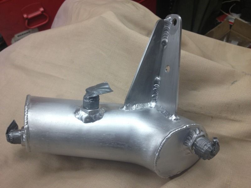

Finally an update!

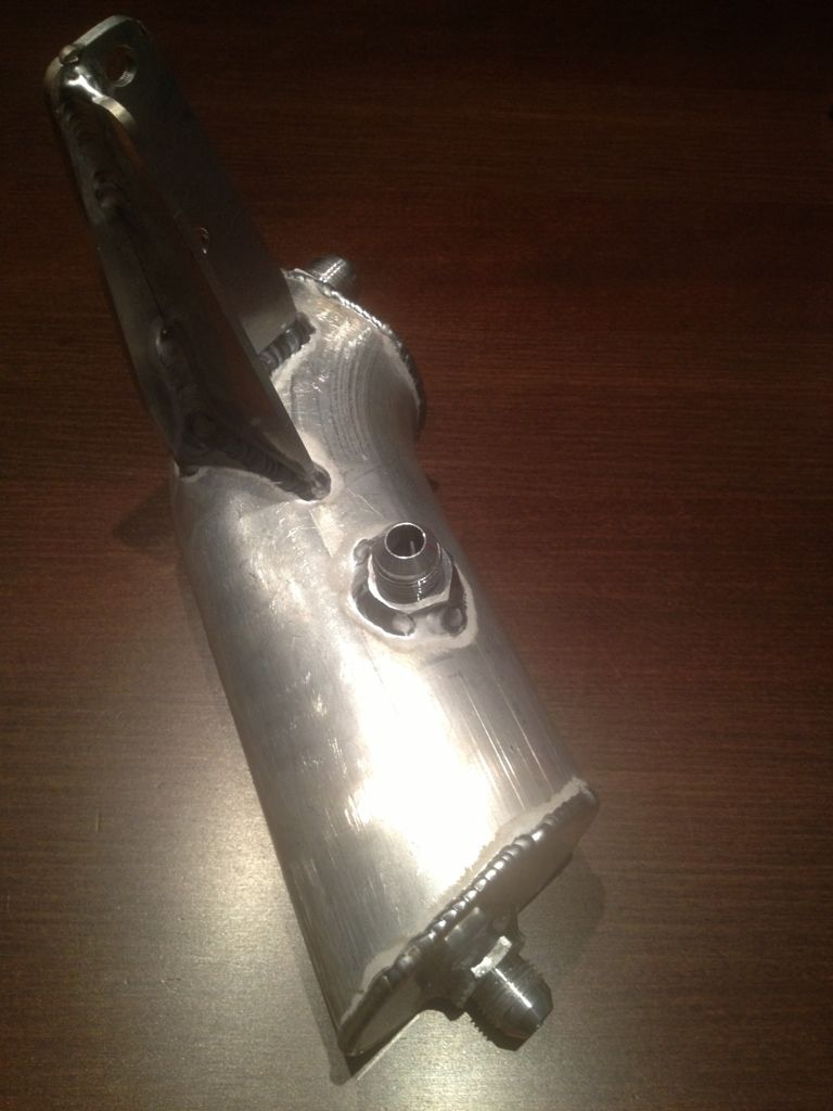

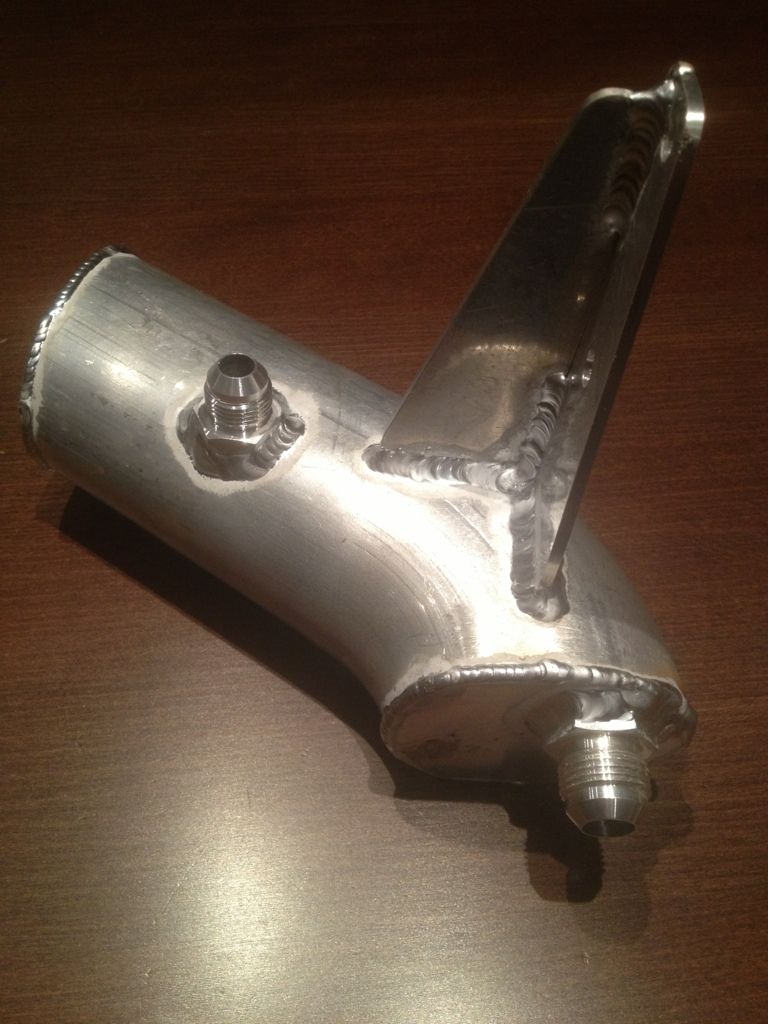

Wow, long time since I last checked-in to write an update. Not a huge amount going on at the moment - everything's on hold until my garage extension project is finished. Basically, the garage will double in footprint, but the stuff that once occupied a couple of sheds has had to go into the original garage temporarily....meaning very little space to work on the engine.
But....I did have a free weekend a few days ago, so with some shuffling around of everything, I decided to continue on the blessed oil catch tank for the turbo. I swear, this part has given me the most aggro of the whole build!
Before Xmas, I was trying to be clever and upcycle (!) the OE tank, so that I could re-use the mountings and the space it occupied . Nice and out of the way between the turbo and the crankcase. So, we tried a number of times to graft on new -8 and -10AN fittings, but long story short, nothing worked out satisfactorily. Because this thing was so impregnated with oil over the last 20yrs it gave my welding guys a nightmare when trying to weld on the new fittings. I tried flushing it out in the cleaning tank, running brake cleaner through it, but it was still too "dirty" for a clean weld. Porosity on both the -10 feed from the turbo and also from the -8 breather tube. It was looking a dogs dinner, so I decided to start from scratch and fab a custom tank from ally that fits in the same space.
By re-using some of the 3" diameter ally from the intercooler charge pipes, I made the unit below, which has worked out really nicely with a 45deg bend, insomuch that I've been able to feed from the turbo with a 90deg -10 bend, a straight -8 breather that will go to the air intake near the filter, and a -8 outlet that's presented at the right angle for the aux scavenge pump to draw from. Happy days!
Nice strong bracket to mount it onto the same M8 studs on the crankcase that the original tank hung from. I'm paranoid about this being mounted securely. No offense to anyone who has one, but I'm really not too keen on the style of tanks that dangle directly from under the turbo oil outlet...perhaps a little overcautious, but to me it looks like a fracture waiting to happen, with the vibration and extreme heat. Anyway, collected mine at lunchtime, and quickly offering it up into position, it clears everything nicely!
This is literally as I've collected it, so tonights job is to clean and prep the surface finish ready for it to be anodized black (I think...or I may get it done silver...not sure yet). I can also now finish off making the Aeroquip lines between the tank and the turbo and from the tank to the pump.
I'll post some more pics later, with the tank in place with a couple of the hoses attached.

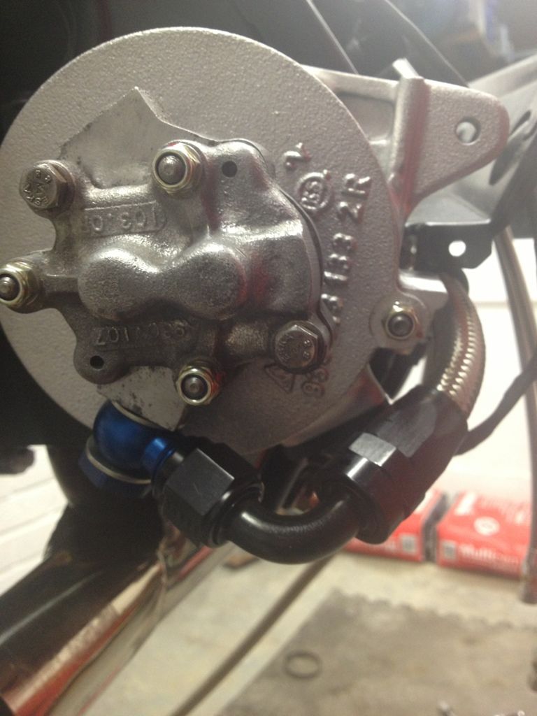

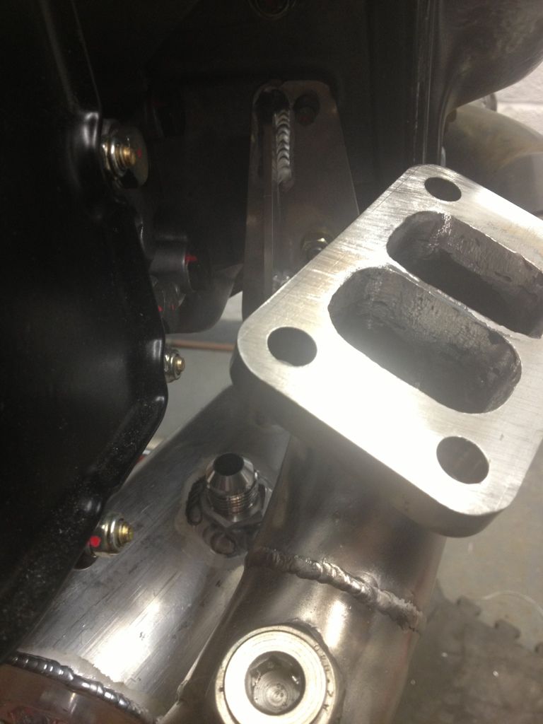

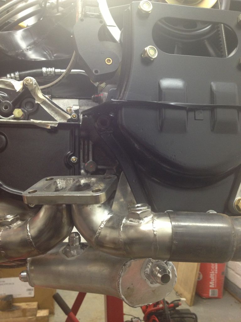

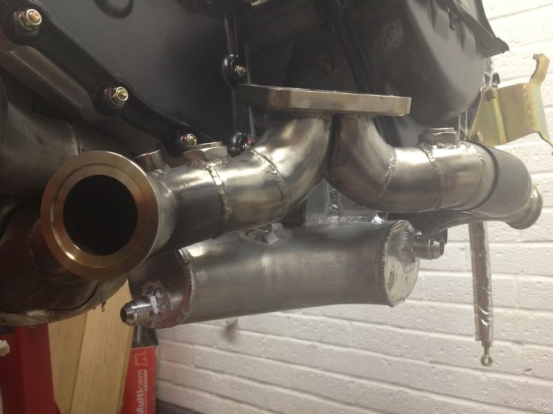

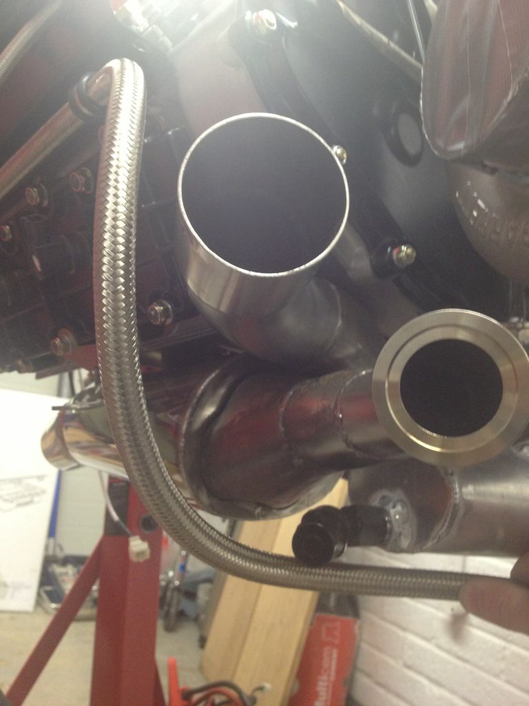

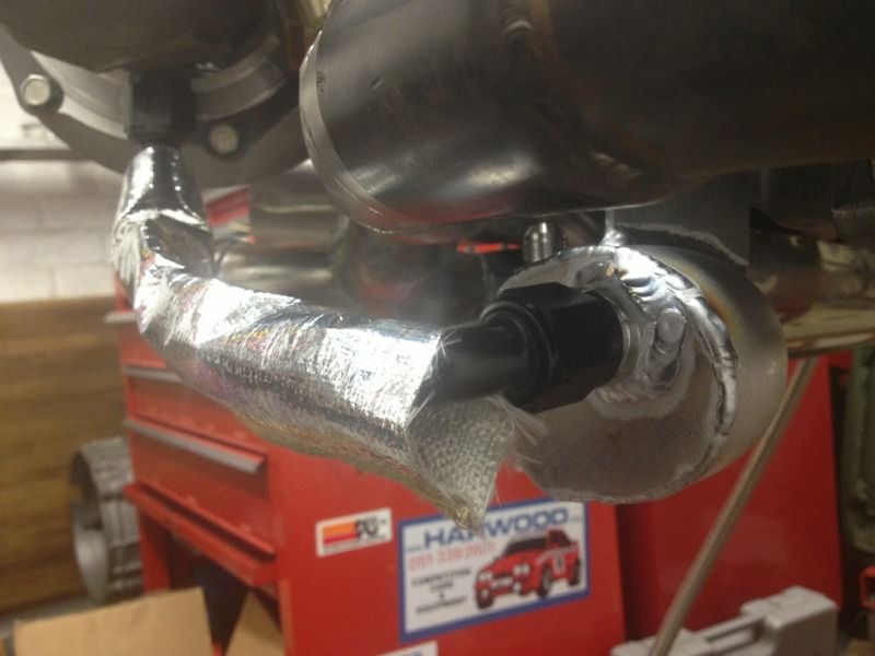

Ok, some more pics from last nights work....
I "ovalised" the 3" tubing, which gained me about 15mm additional ground clearance. It's now not the lowest point on the engine....
The -8AN breather pipe will be a straight coupling, going up through the rear tinware section, and across to the air filter/intake pipe assy....
The tank fits just nicely between the myriad of pipes for the heat take-offs, wastegates, primaries, etc...
A chunk -10AN hose between the turbo outlet and the input to the catch tank. Probably overkill in size, but the I.D. matches the turbo's outlet diameter...
A 90deg -8AN elbow works perfectly for the coupling to the pump. The I.D. of the -8AN is near enough identical the I.D of the original scavenge pipe, so the suction should be as before....
A neat run along the top of the exhaust valve cover...
This is where the auxiliary pump will pull the oil from - I guessed that I'd need a 45deg fitting, but a straight coupling will work better. Easy to swap next time I go up to Think Auto....
And after some initial polishing. Not quite as I want it yet - needs to be more polished for the anodizing to look ok, but it's starting to look tidier....

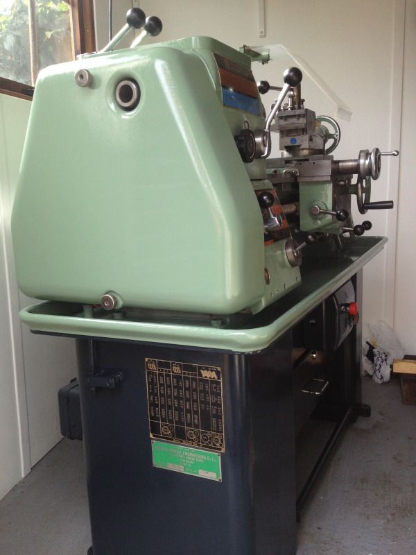

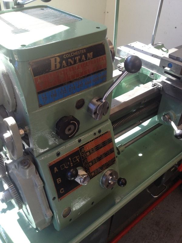

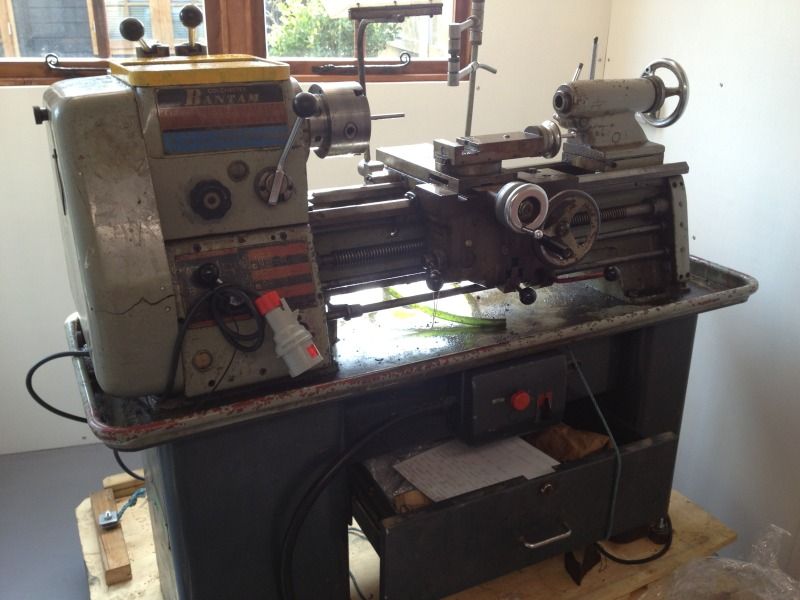

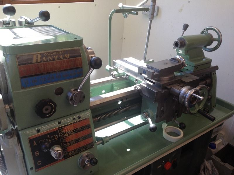

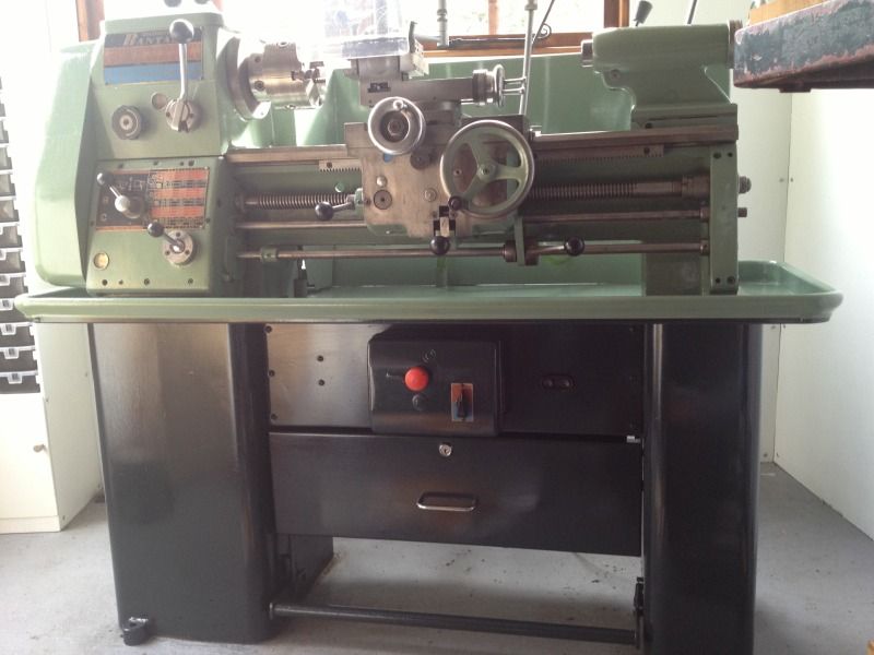

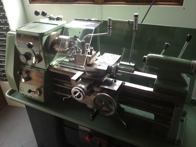

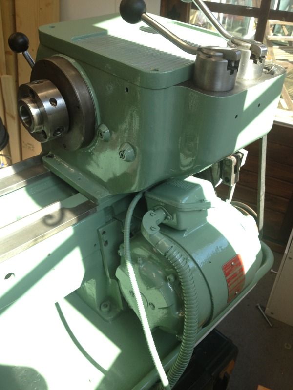

Thanks Simon.....work will hopefully recommence on the engine again soon. Still sorting out the new workshop and doing a light-refurb on the new (old) lathe.
From this, tired, filthy neglected unit -->
To this --->
Lots and lots of hours with degreasers, abrasive papers and tins of the original Colchester shades of paint.
No teardown of anything apart from removing the tailstock and the cross-slide. Not yet checked the alignment, but if it does need adjustment, at least it's all clean again.
The original Colchester suds pump kicked into life yesterday, so tonights job is to wire in the new 3ph digital inverter that I'm now going to use instead of a static converter that I've got.

Nice job on the lathe! They sure look dismal when they are old and grungy but you end up having these things for years/decades/lifetime so it's worth the time for a clean up and lube/adjustment. I certainly appreciate a clean machine.

Absolutely Jim, this'll be good for another 40+ years - was tinkering again today, now got the coolant pump wired up so that it only switches on with the main motor (due to me having a 1ph > 3ph converter, and it only being something like a 0.25hp pump)....being super-careful to ensure its electricallly dead each time...you don't get back up from 415v!! Also fixed the wobbly apron fwd/rev lever. Another clean up of the machined faces to remove a few errant bits of paint, now ready to fit a DRO sometime during the week, then set-to checking alignments and moving it into position.
Apologies - going a little off topic here, just posting in reply to a few folk asking why there's no engine progress at the moment
