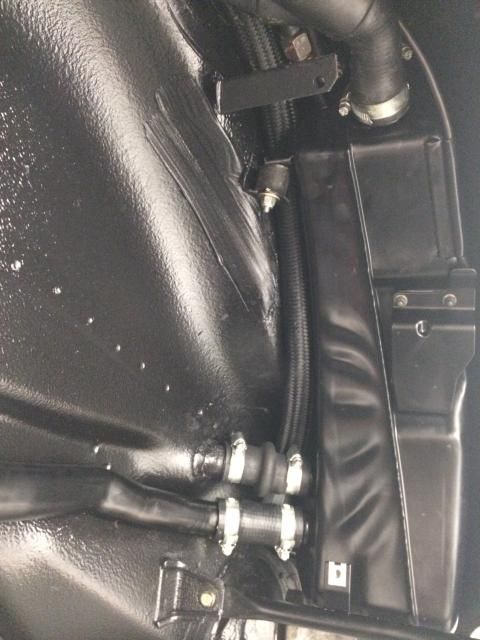

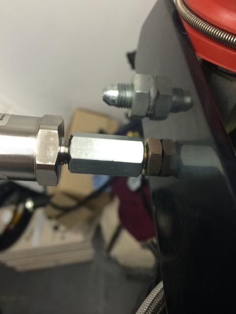

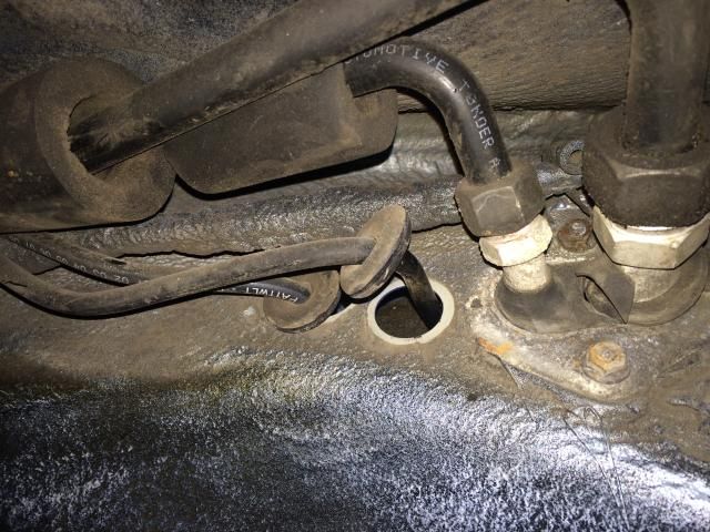

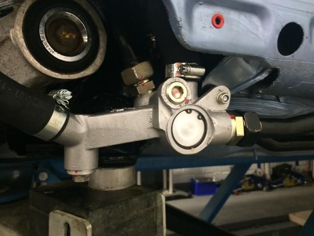

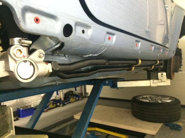

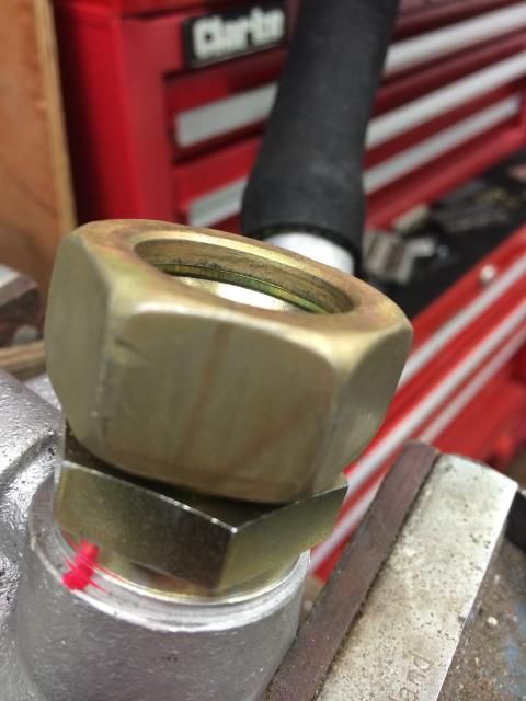

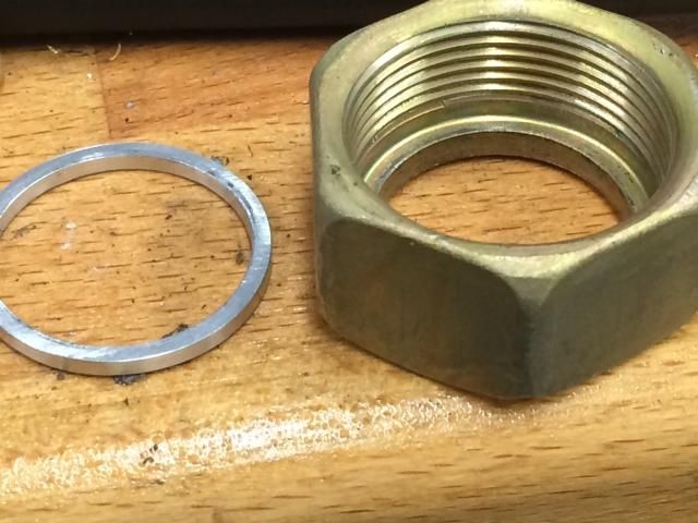

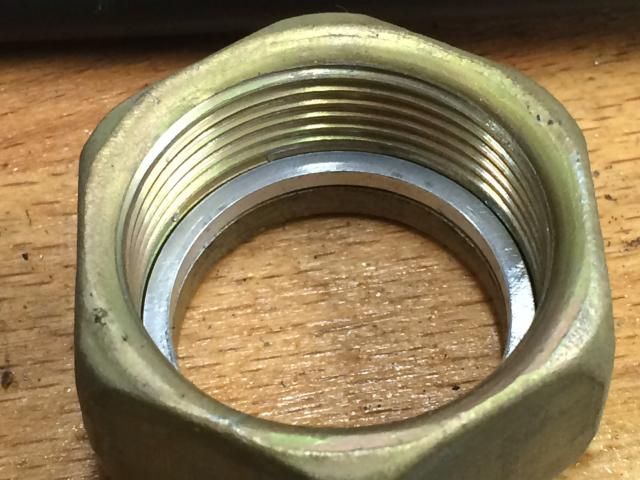

One job I mentioned last night, that I wanted to do before posting any pics, was to buy some more jubilee clips for the 2 x lower oil tank rubber hoses....the ones that both go to the thermostat.
So, I wasn't happy with how the "cranked" front hose was sitting on the thermostat input, not sitting square or far enough onto the neck. Do you think I could manoeuvre it into place? Like hell I could(n't). So, time to:
- undo the oil lines to the cooler, both from the chassis and the thermostat.
- undo the rubber mounting
- remove the larger rear 90deg elbow hose from other end of thermostat
- eventually concede and undo the tank mounts to see if I could squeeze more wiggle-room
- ok, concede a little more and undo the bellow hose and the straight hose>rigid pipe just beneath it....
And then I see it....
The hose that runs behind the tank, with the cranked rigid pipe that screws onto the top union on the thermostat....is moving. Now, doesn't sound like a major issue, just tighten up, right?...Nope. I tightened it up as much as poss in-situ last night....32mm and 36mm spanners allow for a fair amount of torque, and this thing was TIGHT....but the pipe is still swivelling...DAMMIT!!! For those that aren't aware, the trouble is is that the hose is so tightly packed in behind the oil tank, the 964's huge suspension arm is also pivotted right next to the thermostat, so you'd never see this problem with everything in place.
When I had a new flexi section swaged onto this hose a few weeks ago, we changed the rusty nut for a nice shiney new one...however, upon inspection the new one bottoms out before the flange of the pipe (that the nut acts upon) is pulled down far enough, thus the conical end isn't tight in the union. The thread in the nut doesn't extend as far up into the nut as the OE part.
So, what started off as an annoying, recalcitrant rubber hose not wanting to seat correctly, actually saved me from one hell of a problem come first fire-up day, where I'd have very quickly spat gallons of oil all over the place.
It actually gets me wondering whether to hold-off reassembling any bodywork; bumpers, sills, inner arches, etc, until that first firing-up of the engine has been done, so I can keep any eye out for any weeps (or floods)
Anyway, the hose will have to wait until Friday lunchtime; I happen to have a meeting in the morning about 5 miles from the place I get the hoses done....plenty of other stuff to get done.
Moral of the story? Always check yer nuts. (I'm here all night...)

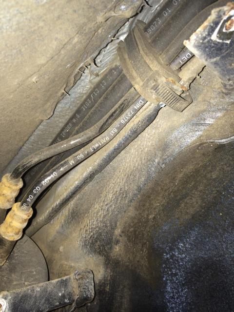

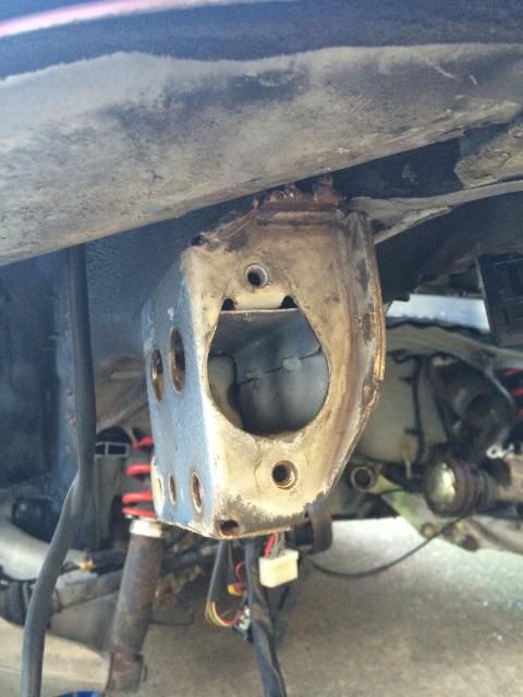

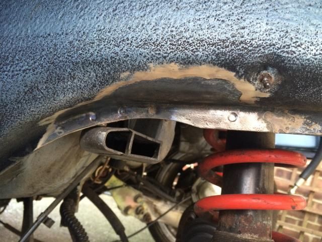

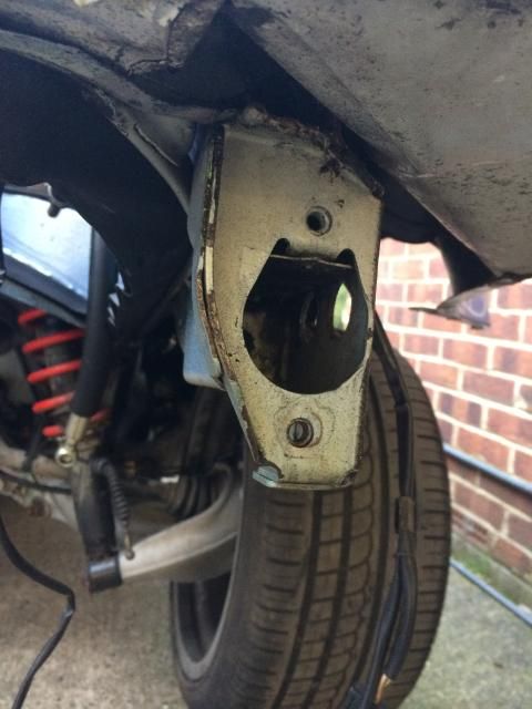

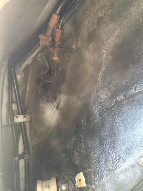

Parking the issue of oil lines for the time being, been cracking on with other tasks and making use of the warm autumnal evenings to roll the car out and address the bumper support bracket brackets (!)....the box sections under the engine sealing skirt.
The LHS was looking quite ropey, the RHS factory fresh; strange. Anyway, got the angle grinder + wire wheel on the case, plenty of Gunk degreasant, and it's ready for some zinc primer and top coat/lacquer.
Before cleanup...
Also, some rust had crept in right on the seam at the bottom of the inner arch. Clearly the stonechip paint had been compromised and let in water.....thankfully nothing more than cosmetic, and it's back to fresh metal again.
The rear LHS wheelarch had 21yrs of dried road grime, but is now clean.
Removed the carbon canister and pipework so I could get right into the depths of the inner/outer wing. Fingers crossed the weather holds until this evening, to get a coat of the rubberised protective paint on.
Once the paintwork is finished, it's time to bolt back the bumper support bracketry. Have got a couple of wing stay brackets, that somehow escaped my attention, over at the powder coating shop. Another batch of brackets and fixings is also over with the plating shop - hoping to get them back by the end of the week, to get the bumper back on this weekend (going to keep the inner arches off the car for time being, as mentioned previously, want to keep an eye on the oil plumbing when starting the engine for the first time).
Heat management - discussed a few weeks ago with respect to lining the tinware above the turbo, and/or making a shield, but it occurred to me the other whilst cleaning the inside of the rear bumper, that it may be good practise to also line the inside of the bumper with the same gold reflective material. Nice and thin and self-adhesive, so should be easy to stick onto the degreased OE aluminium heat shields.
Another order in with my OPC for more fixings, plus some new support brackets for the rear bumper (original ones are extremely rotten, beyond blasting and powder coating). Hoping to get this order before the weekend as well.
Coming along nicely....

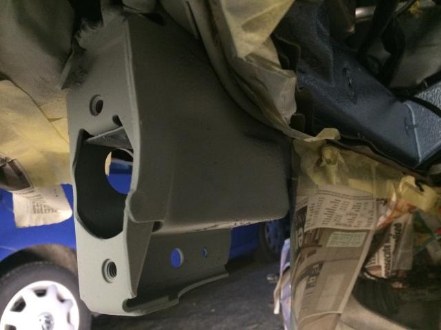

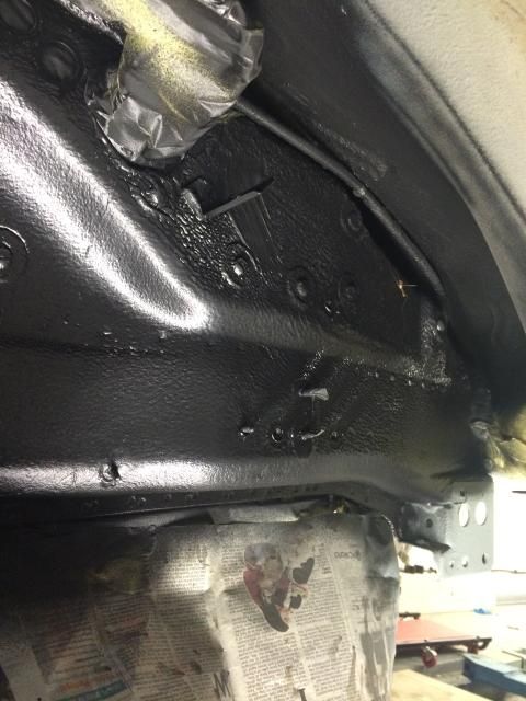

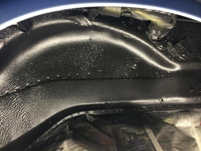

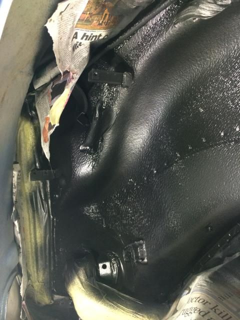

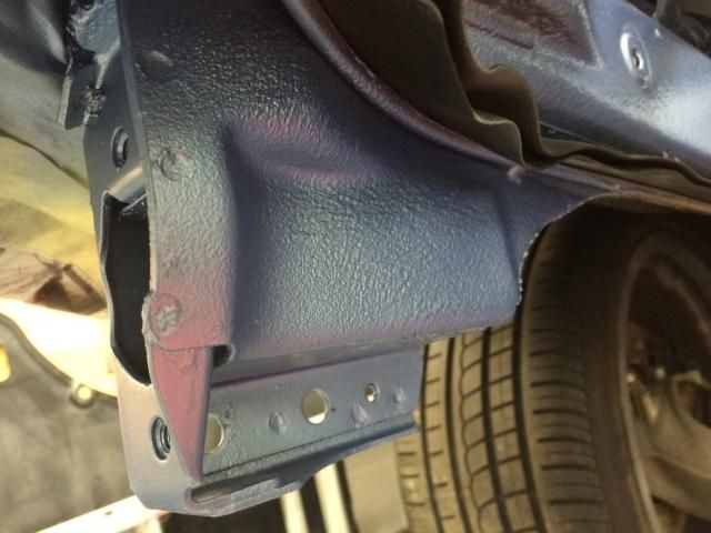

More progress this evening....
The bare metal and the box section coated with zinc primer:
The final wheelarch, LHS rear, is now sprayed with the rubberised paint. More great use of the Daily Mail.
And the top and lacquer coats on the bumper mount box section:
(that's a red reflection, not a paint cock-up)
Just need to wait for the lacquer to harden overnight, then mask it up to re-apply some of the black rubber paint; little bit of overspray that just needs a little correction. Also want to spray some Waxoyl into those enclosed sections; I noticed when cleaning it up that there's a part where two sections are welded together, but leaving a gap which trapped a load of muck. Time to get some Wayoyl in there as well.
I also now have the last two wing stays back from powder coating. The latest update to the OPC order has some hardware for the carbon canister; relatively inexpensive, not worth the effort of cleaning up the old stuff and getting it (waiting for it to be) re-plated.
Next bit should be easy, just reassembling a load of brackets and stays, refit the carbon canister assy, finish that corner with inner arch liners.
Back onto the front bumper, the aftermarket brake ducts are more decorative than useful; enclosed backs with about a 1" diameter hole out the back...useless. I may look to either open that duct up completely, or buy some internal ducts that will mount behind the bumper and mate to the "RS" looking ones. Finally, attach hoses to direct the airflow more accurately to the oil cooler and A/C condensor. Then bolt the front bumper back on (...I keep threatening to do this, don't I?....)

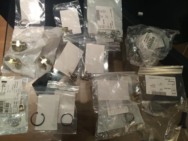

Managed to collect a load of parts on my way home and after work today; Fortuitously, my meeting today was a couple of miles down the road from Think Automotive, so swung past there over lunch to show them my oil feed/thermostat issue. Some puzzled looks and trying of a few other parts didn't turn up anything we could use to fix the problem, so it's going to have to be a case of going back up there in a week or two, removing the swaged ferrule, re-using the original nut (that's now been re-plated) and re-swaging the pipe. Very strange affair that Porsche chose to do with the conical section of that rigid pipe; it's about 2mm thinner than a comparably sized alternative (strangely, also manufactured by the OEM supplier to Porsche back in the 90's). I'll post a pic tomorrow of the bit I'm referring to.
Encouragingly, Matt (owner of Think Auto) said that they'd be willing to pressure check all the hoses, to ensure all swages are sound. The reason I asked this, was because I've seen the chap who posts on PP who makes new fuel lines for folk, post a few horror story pics of instances where the wrong swage couplings have been used, with obvious consequences....now, I'm certain that all is well with my lines, otherwise they wouldn't have offered to swage to them in the first place, but getting a proper pressure check done may be prudent. Or paranoid. It may make sense whilst everything is disconnected again, to also pressure check the rigid lines from thermostat > oil cooler.
The guys at my OPC had received all-but-a-couple of the items on this weeks shopping list...despite me rebuilding the thermostat a year or so ago, refurbing parts and making a new cover plate, I decided the other day to buy new parts for it; felt like I was scrimping a little, on such a vital part...so...new cover plate, o-ring, circlip, unions, allen screw, etc.--->

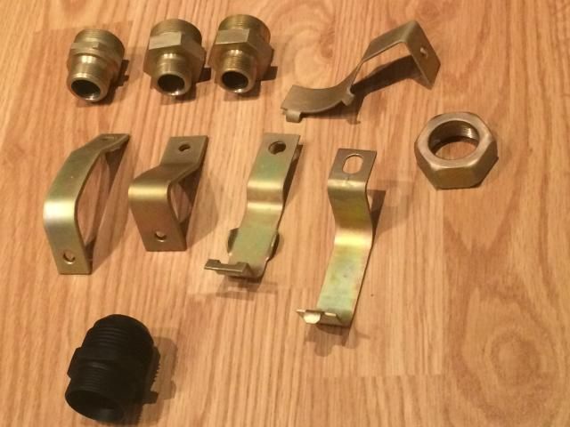

The electro-plating shop had also finished my A/C and horn mounting brackets and other sundry items....

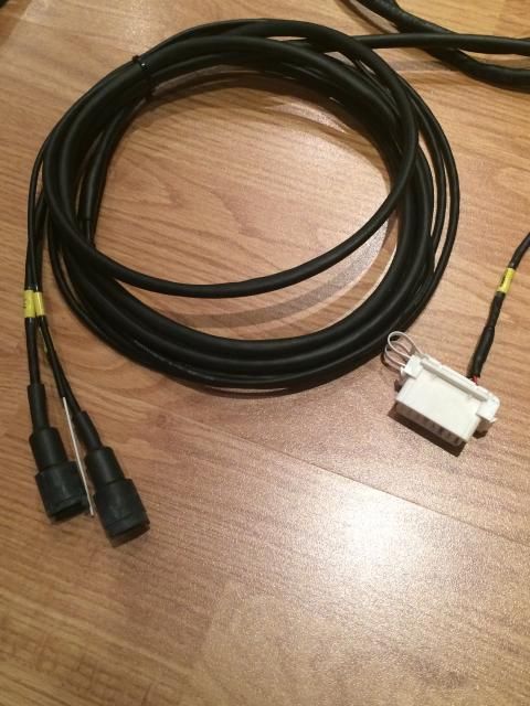

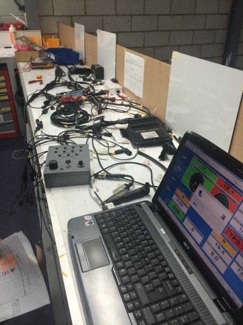

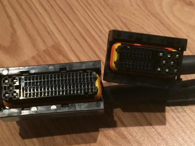

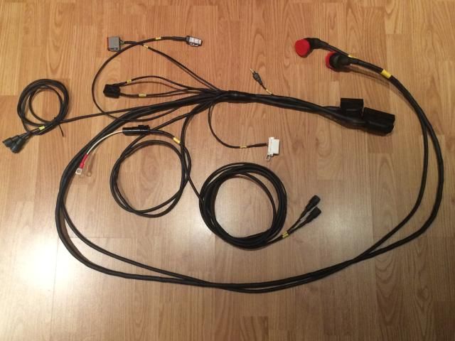

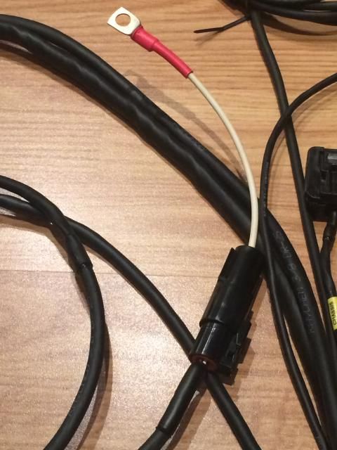

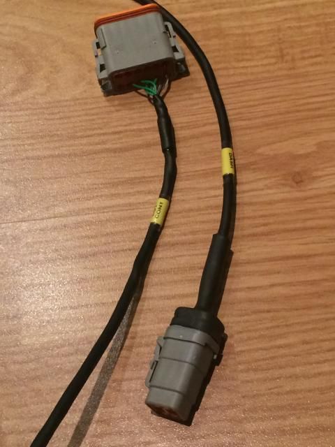

And late this evening, a trip over to Si-Leck to visit Simon for the final bench testing of my wiring loom. Apart from a head-scratching moment wondering why my ECU was throwing all sorts of garbage to the UI (turns out there was no base map loaded! Easily fixed), it all went very well indeed. So, I now have the engine half back again, with a few mods that we identified a week or so ago, plus I now have the ECU / Cabin side of the loom, with wheel speed sensors hookups, etc.....all ready to be installed into the car. Another lovely piece of workmanship.....
Pretty dense ECU plugs...sooner him than me! -->
The feed from the AEM EGT transducer to the ECU plus the Dashboard loom feeds -->
The final part of the loom to be made is the above dashboard section, which will have the rotary switches for traction control and boost control, warning lamp output and the feed for my boost gauge
Two of the 4 wheel speed sensor inputs, along with a comms interface (we can now use an OBDII interface for basic in-flight diagnostics; bluetooth dongle and iOS app spring to mind...) -->
The power feed for the whole loom, which we're taking from the starter motor +VE supply....no fusebox feeds for this setup, the sort of thing that's a swearword to guys like this. This is a single pin Deutsch connector with daft amounts of current handling, and means I can leave one half permanently bolted to the starter motor stud. -->

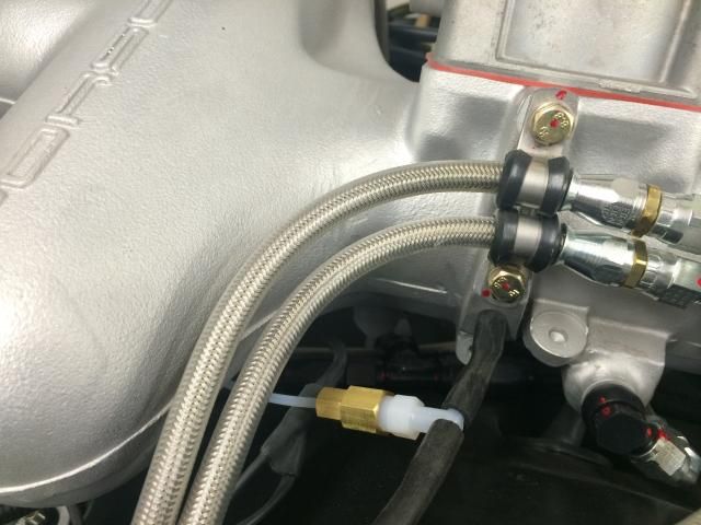

I'm using a 964RS flywheel, which is a single-mass unit but more importantly, is also a 60-2 design. By doing this rather than running a toothed wheel on the nose of the crank, I can then retain the OEM sensor bracket. The stock sensor was a magnetic type, I've just replaced it with a hall effect unit; same size dimensionally, easy.
Depending on the ECU you're using and how it uses the crank position sensor but I believe a lot of ECU's, even if you use a 60-2 wheel, will then convert it to a lower resolution for it to then base timing from. I'm sure the MBE units (specifically the 9A9 system) doesn't do this, it uses a native 60-2 resolution.
The injectors are Siemens, I'm pretty sure they're 690cc and 12.5ohms (but it was so long ago that I bought them, almost 3yrs!).

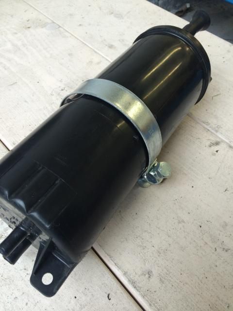

  • The carbon canister was fully cleaned, and re-installed with a new clamp
  • canister lines cleaned and refitted with new hose clips

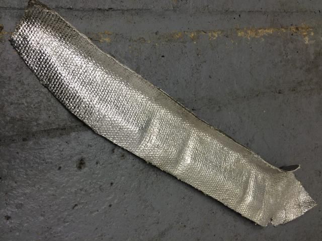

  • The heatshield that guides the hot air exhaust from the RHS ventilation fan, has been stripped of the grotty tinfoil covering, cleaned/degreased and recovered with some left-over heat protective material I had. Not a perfect job, but 10x better than it was
  • And finally, my Brother gave me a hand to refit my new (to me) refurbished engine lid and wing!...Been dying to do this for almost a year. Very very pleased with it's more-factory-than-before look. Perfect colour match by my mate Shaun the paint dude. Oh, and the spare bed in the back bedroom is now wing-free!
The recovered hot air shield --->
Before:
After:

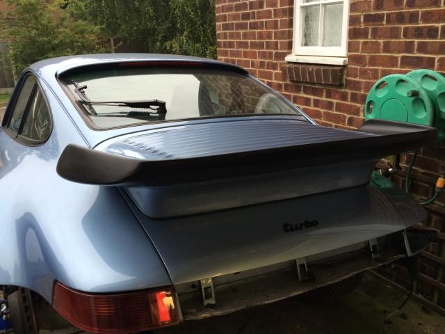

The wing now in place --->
Will take some pics of the heatshields in place tomorrow....there's a surprising lack of any (useful) images on Google for the 964 Turbo. A few of the brackets off the car and aftermarket stainless alternatives, but not a lot showing how it all mounts onto the chassis.

Addressing the oil feed pipe issue that I mentioned in post#308, I've now removed the swage ferrule on that line, so I could remove the swan-neck rigid section, try the original but re-plated nut and take it back up to Think Auto over the weekend for it to be re-swaged.
And I'm glad I did check the old nut....it also is extremely borderline with clamping that pipe into the thermostat.
I've now got new unions in the housing (genuine Porsche), and the pipe was still swivelling even with a healthy amount of tightening on the bench; probably more than you could get with the parts in-situ. A bit of rotating and shuffling to seat it and it was marginally tighter but of course, once everything gets hot, it'll most likely loosen. So this is no good whatsoever. No idea why this situation has arisen, nothing's changed apart from cleaning and replating, I can only assume it was only just clamped enough before I removed it...thinking back, the nut was BLOODY tight when I removed it. I put it down to corrosion in the threads, but perhaps it was a previous attempt at getting a seal?
One option could be to scrap the idea of using the original hose and swan-neck.....but I know damn well that a completely flexible hose is unlikely to fit between the oil tank and the inner wing, the outside diameter of hose being too large.
Another idea could be to chop off the conical section of that swan-neck pipe and braze on a new fitting with a thicker flange, but having tried to braze old fittings before (oil catch tank), it's a nightmare; the oil is too impregnated.
Plan C - make a spacer that will sit between the nuts tightening face and the flange of the swan-neck.
I couldn't get the vernier into the nut to measure the gap, but comparing it to the thickness of the step flange on the pipe, you can see it's very similar, hence not able to clamp down tight enough --->
So, 10mins on the lathe and we have a washer that sits nicely in the nut, and once assembled onto the thermostat housing, it allows a few threads extra turning to get it nice and tight.
As mentioned, over the weekend I'll get it assembled but also get the other lines pressure checked.

Moving things along quite nicely today.
Oil lines pressure checked and all fine; knew it would be, but made sense to be double-sure whilst I could get the lines and hoses out.
The problematic feed line to the top of the thermostat has been re-swaged with the original nut and my modification washer.
But what a nightmare refitting the oil tank and all the new hoses! That's not a job I want to repeat any time soon. The short S-shaped hose at the square end of the thermostat, it turns out, is significantly different in shape to the old one; the bends on the original item being more like 90degs, the new item more like 45degs. It was also about 10mm too long with the top cut that goes onto the tank being at the wrong angle, meaning that it prevented the thermostat mounting high enough nor close enough to the rigid oil lines. This was then stretching the rubber bobbin that it mounts on. Some trimming got it better, then it was a case of gently tightening everything in sequence, to make sure the oil lines to the cooler were square, the the S-shaped hose was seated nicely, that the tank then mounted onto the chassis correctly, and that the swan-neck rigis section of the problematic feed hose didn't foul the suspension....Arrgghhh!!!!
Anyway, 4-5 attempts later and I got there. I can almost call it quits on this part, and refit all the braces, bodywork fittings, and loosely refit the inner arches to get them out of the way.
Have also played around with the engine itself; shortened the two -3AN F/F adapters that I'm using to mount the exhaust backpressure sensors. The threaded sections were too deep, meaning that both the sensors and the bulkhead fittings were bottoming out on the thread rather than sealing against the tapered seat. Easy job on the lathe, now ready to be re-plated.
(not a huge amount to see here, was just a 2mm chop from either end)

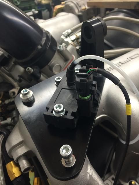

Found a suitable location to mount the pressure sender for the new boost gauge. I decided to locate it on top of the LH intercooler bracket. Unfortunately I only decided on this boost gauge after I'd designed and made the sensor bracket over a year ago, otherwise it'd have been nice to put all 3 of these senders next to each other. But nevermind, it's still looks good where it is, and makes use of some empty real-estate.
The pressure sensor take-off "T" is also now in place, fed from the underside of the throttle plate.
