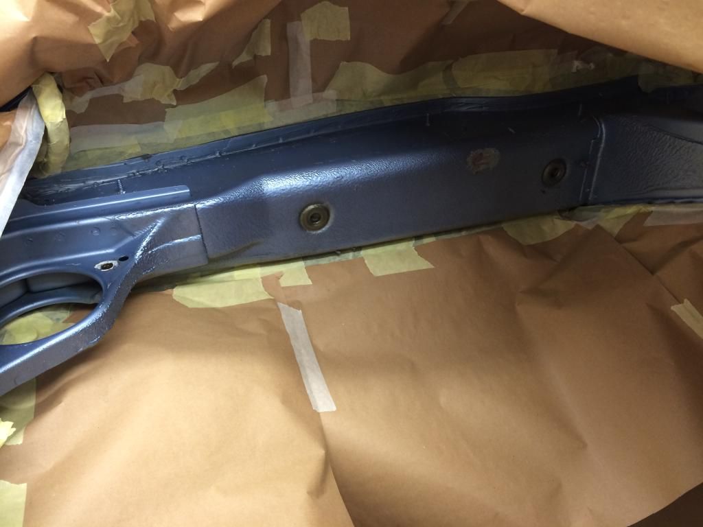

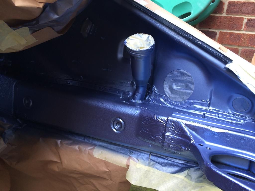

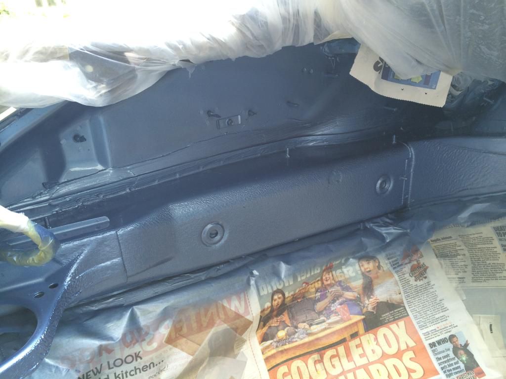

Success!
Ok, now I've got the paint as I want it, I'll share some photos.
Following on from the previous pics showing the cleaned but unsprayed engine bay, next step was to spend time (a lot of time) masking everything. I was originally only going to respray the lower part of the bay, but as you can see, the colour difference was just ridiculous.
....so, time to do what I should've done to start with; re-configure some of the masking, remove a load more fittings and spray the inside of the wings -->
Nice colour. Pity it's on the wrong car.
I don't know why, but Lucy and I decided to remove the masking. I guess I was hoping that once the paper was removed, it wouldn't be so bad. Nope. Time to mask up again last night, then get the car outside this morning to respray with the new paint.
A LOT better (imho). I also got a different brand of clear lacquer, which the guy at the paint shop said was a better formula. I know Porsche didn't finish the paint with a gloss finish, but have to say, by deliberately spraying it quite "wet" I'm really happy with how it came out. It'll be a damn sight easier to keep clean, and looks more "finished".
Masking now removed again -->
Of course, well worth spending the time to mask accurately, no overspray to clean off and I've also managed to retain the finish on the tops of the damper turrets, where the factory finish was unpainted where the damper mounts bolt to the chassis (you can just about see it in the pics)

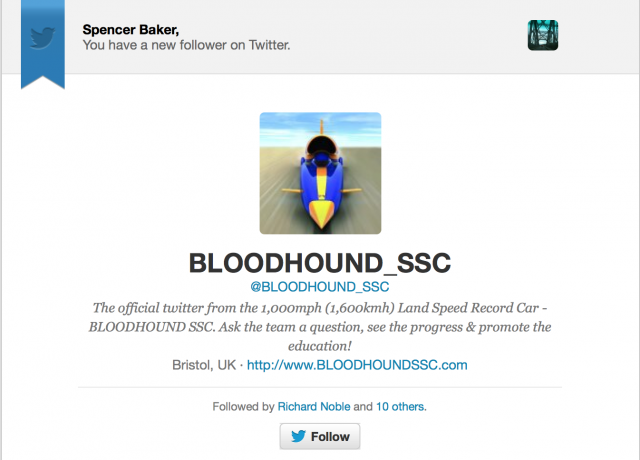

Ok folks, so I'll post another update later on in the weekend....there'll be some progress on Sunday (weekend to myself); tomorrow it's time to re-visit Santa Pod after what must be almost a 20yr absence, to go and see the final round of the FIA European Finals drag racing....one of those bucket list events to go and see, as I've never seen first-hand the awesomeness of God-knows-how-many-thousand horsepower weaponing itself up the track!
Talking of mega horsepower, I received this email earlier.....
I guess Mr Noble must've heard about my project, haha!
Now, I'm not a great Twitterer, but I may get back into it, so if anyone wants to follow, I'm @spenny_b ....hmm, now that'll be two things to keep updated.

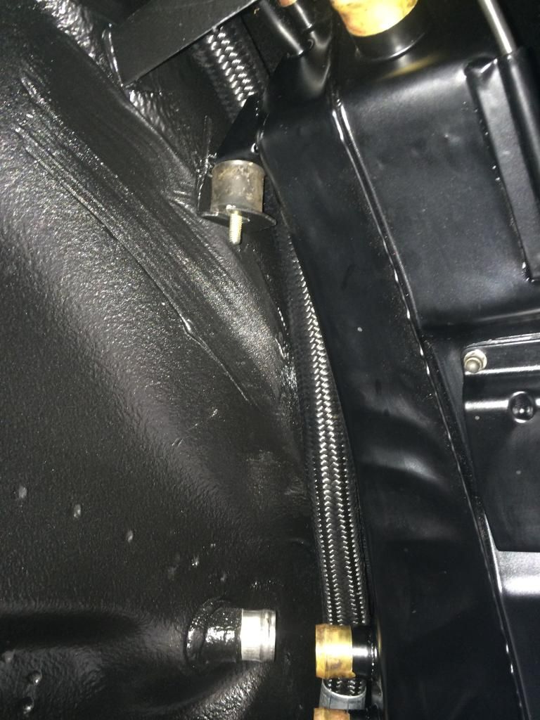

Ok back on track....Question to folk before I finally bolt down the oil tank.
My disassembly photos show that the jumbo oil line that goes from the crankcase to the thermostat goes up and over the wheelarch, fastened in a chassis retainer at the top of the arc. That's fine...however when I took it all apart, the line ran like this --->
But logic says that the shaping of the inside of the tank, and the recess in the inner arch itself, is there to place the hose "behind" the rubber mounting, like this --->
...but it does make for a tighter fit with getting the tank into position on the rubber mount slots.
Anyone know the answer pls?
(The tank's not in place at the moment, as I'm fitting the lower rubber hoses onto the thermostat, hence why the oil filler neck tube isn't aligned with the tank input.)
Old 09-13-2014, 04:08 AM
  Pelican Parts Catalog | Tech Articles | Promos & Specials    Reply With Quote #299 (permalink)
Join Date: Sep 2001
Posts: 381
Behind as in the last picture.
