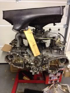

Okay, so onto the project itself.
When I originally started, this was going to be a fairly straightforward CIS -> EFI swapout. Probably even possible with the engine insitu. However, I decided to get everything out for a look/see, and determine if a top-end or full rebuild was necessary.
As you can see above, I did all that. Ordered a leakdown tester that broke on first use (dial gauge won’t zero back down), the vendor looks to have gone out of business, and so I treated this as an omen.
Full rebuild it is!! Never somebody to do things by halves, the engine had done 84k miles and although it dyno’d well enough, I thought it a good idea to work from a fresh and known platform….plus, it’s all part of the education and so far, very rewarding. To do a top-end was ok, but without inspecting the bottom end, it could be that in 30k miles time, I need to then do it all again for the bottom.
So, again, it’s taken a number of weeks to tear the engine down – could have gone at it like a bull in a china shop, but wanted to be comfortable in my own mind that everything was inventorised.
Oh, and did I mention the weeks of constant research, conversations and pondering? And the spreadsheet from hell? No? Okay….

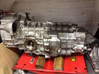

Gearbox all nice and clean again - I've also just bought some Dinitrol (clear rather than the horrid brown waxy stuff the factory uses). I'll apply this when I get a spare few moments:

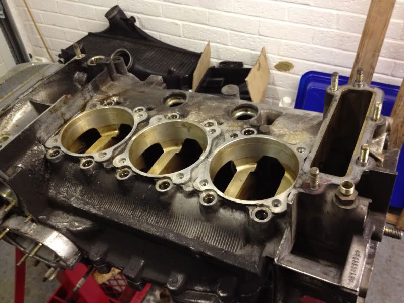

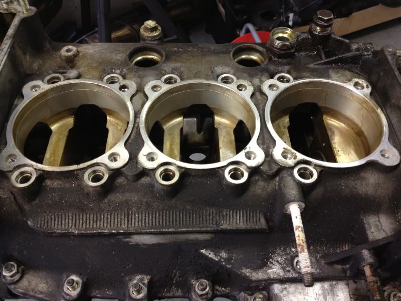

The cylinders all measured up great using a very nice (and presumably expensive!) set of Mitutoyo bore gauges and digital Mitutoyo micrometer, at my mate Steves place. Waynes book states Factory specs of 97.0mm +0.1mm tolerance. I haven’t got as far as transcribing my scribbled findings down into a spreadsheet yet, but the largest dimension we saw was (iirc) 97.023mm across one of the axis (I measured both at the bottom just above lowest ring witness mark, and 30mm from the top, in X and Y axis)…so good news, no cheque to Mr Mahle just yet!
I haven’t yet check ring lands in fairness, but should be ok given the general condition of everything else

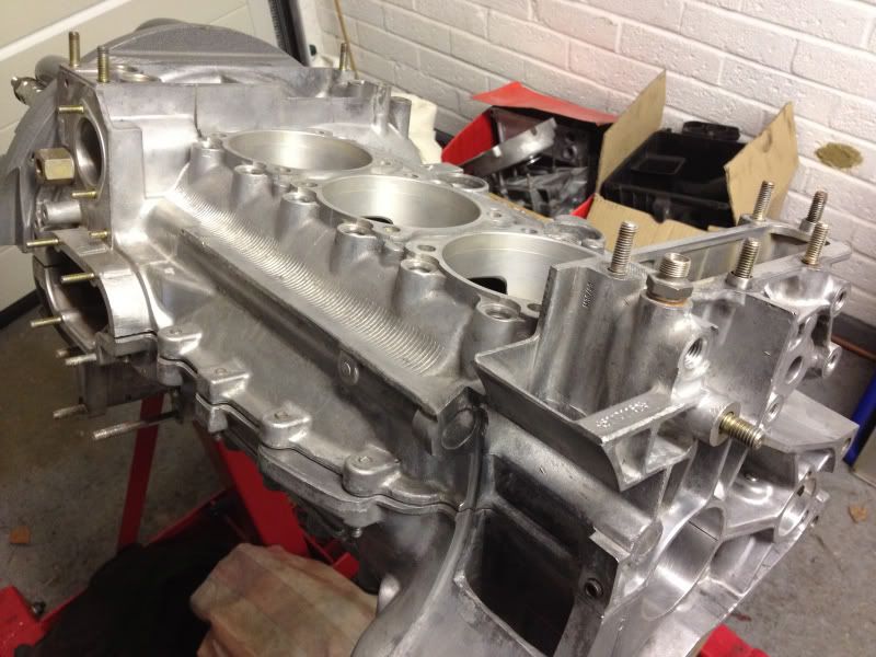

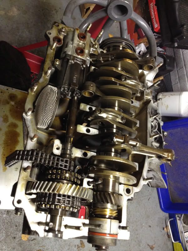

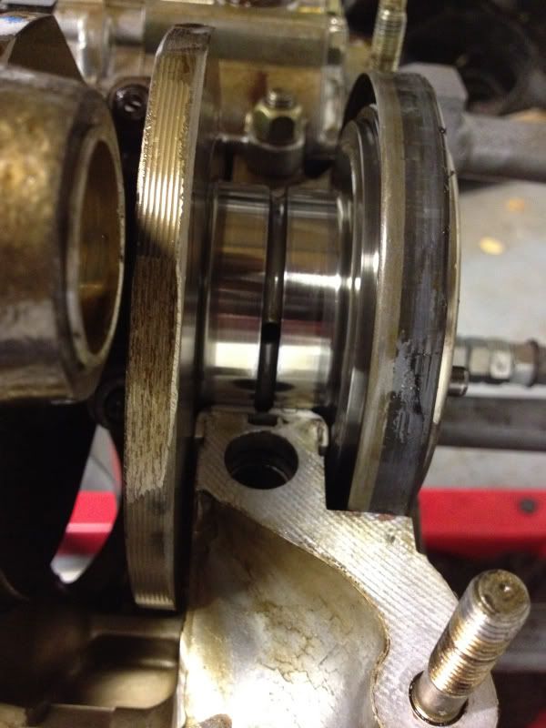

Ok, more updates.
Got back home on Saturday, having pondered the head stud removal the whole time I was away! Went straight into the garage to start the case separation. Managed not to fall foul of the hidden nut inside the timing chain housing (thanks for the reminder Chris!).
The case came apart relatively simply - prob no more than 5-10 mins of gentle tapping with the hide/copper "persuader".
A short while later, the crank, intermediate shaft and oil pump were out and on the bench.
Dug around in the washer box, found 8 steel plain washers, used them evenly around the perimeter of the RH case and placed the LH half back in place...now separated by about 1mm and absent of any internals, the heat sink issue should be greatly reduced. I'd hoped to find some fibre washers to isolate the heat even more, but not many hardware stores open in this sleepy little town on New Years eve @ 11pm! Gently nipped up the case halves to secure.
At this point, whilst all going rather well, decided to come back afresh in the morning to have a go at removing the head studs, conscious that once you start heating the case, you don't want to break off and lose that heat.
I'm going to do a separate writeup on my experience of this, in the Engine forum, simply for those guys in the future that want to search for another method; I hadn't seen this method before, but definitely worked out well for me.

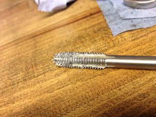

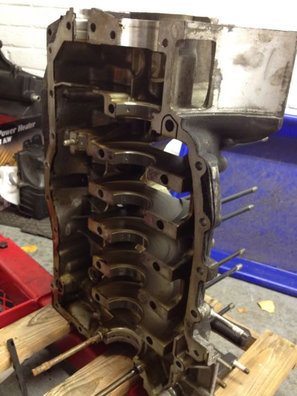

So, having briefly had a quick attempt to remove a head stud before the Xmas break, whilst the case was full together and full of crank etc, I'd applied heat with my butane torch, probably for 5mins....but this was nowhere near enough. Predictably, I tried my newly borrowed stud extractor on one of them and got huge amounts of torsional twisting. At this point, I decided to put everything down, go wrap some presents and enjoy Christmas with my daughter, folks and brother.
Now, with the case separated, gutted and re-assembled with an air gap, armed with 3 large cans of butane (!!), fresh from a holiday and good nights kip, I was fighting-fit, lol!
This time, I gave it about 10mins of gentle heat, all around the stud housing but mainly in the spigot ID. When I tried to remove one from #2 cylinder, my heart sank when I saw the shank twisting, assuming it was just more torsional twist. Then I noticed that it felt smooth in movement...."hang on....this bugger's turning properly....ooh, wait....it's only coming out!!!!...wa-hey!!"
I cannot tell you the relief and jubilation!!! Hmm, 1 down, 23 to go.
Anyways, they all did come out and no snappages...I even got into a bit of a rhythm, but was very careful not to try and get cocky and shortcut anything....plenty of time, plenty of heat and lots of patience. And a cup of tea between the two case halves.

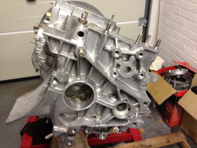

The air gap between the case halves worked perfectly; by the time I got the the 10/11/12th stud, the case was very warm indeed (as was the removal tool), certainly too hot to touch comfortably without gloves....the bottom case half was still cold...not warm or even cool, but cold. Bingo.
As you can see, the case halves were filthy.
Waynes book talks about spending at least 3-4 hours cleaning them...I tell you, I spent about 4 hours just doing a preliminary clean in my paraffin tray, getting the gunge off.
I then took them up to my mate Steves place and spent another 6-7 hours cleaning them in his parts washer tank. 11 hours!! Very pleased I did though, they're now looking very nice (will take some pics tomorrow and upload).

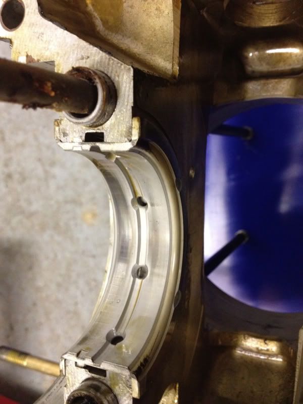

The internals weren't caked in cruddy scorched oil, just a light golden colour staining.
The bearings and journals look in excellent condition, very pleased with that; a few wear marks on the shells but then you'd expect that after 84k miles. No pickup or abnormal wear on them, as you can see....

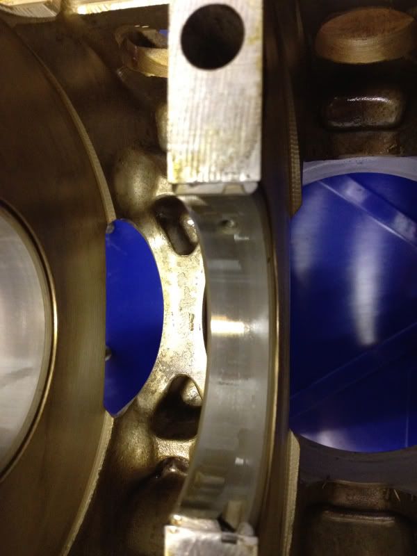

Great job!
Is that wear on the large timing gear, or just a reflection?

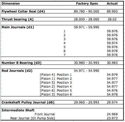

I've measured the crank journals and intermediate shaft journals. All good news, everything's in spec:
While I'm at it, here are the cylinder measurements:
Crankshaft is all cleaned up, as well as the rods, through bolts and the camshaft that I still have (the other one's away being modified to drive the oil scavenge pump).
I decided not to strip down the oil pump; looking carefully at the teeth through the inlet/outlet holes, they look in great shape too, so have left "well alone". What I did do, was to run the hose in the cleaning tank into the oil inlet hole and leave it flowing fluid for an hour or so to dissolve and flush through any sludge.
All's well and now just waiting for the rebuild kit to be delivered...which according to USPS tracking service, looks like it's now cleared UK Customs, so possibly tomorrow!
Think it's just reflection Chris...running my finger nail over the teeth, there's no discernable wear. I got Steve and Craig @ SB Development to cast their far more experienced eyes over everything while I was cleaning it - they couldn't believe the condition of everything...to which they then muttered about the quality of German engineering whilst busying themselves with other things,
Update: Chris - Have had another look at the inter shaft drive assy this evening; nope that was definitely a reflection (assuming you're referring to the aluminium timing gear?) The only slight marking, and again, it's nothing discernible to the fingernail, more a witness mark, are those diagonal marks you can see, and even they more or less polished out when I got some rag and brake cleaner on it.

Anyway, as promised in the previous update, here are some pics of the crankcase halves. This is what >11hrs of cleaning gets you....plus another few hours this evening carefully getting rid of some oxidation with wire brushes and small electrical screwdrivers. Fantastic therapy for my OCD ....

Question: I thought it a good idea to chase out any crap and dried out thread lock from the M10 head stud threads; I tried one, and have to say I was a little concerned with the amount of ally material it brought out....
This amount of swarf was present on all 4 flutes....Is this "usual" for factory castings?
I cleaned up one of the old dilavar studs (only with a wire brush and a pick, not by running a die down it) and screwed it in; there was a little wobble from the newly cleaned out thread and could be run all the way in using only fingers. Trying the same stud in a non-clean hole, it was definitely tight, and could only screw in a few turns by hand.
I measured the tap using a micrometer; max 10.08mm about 2/3rds the way up.
What do the collective think? Clean all head stud threads, which I'd ideally like to do?
TIA,
S

There are thread cutting taps, and there are thread chasing taps. You need the latter.
Cutting threads can remove more material, while chasing taps (with a liberal amount of fluid) do not remove additional material.
Cleaning the head studs' threads with a wire wheel is advisable.

Thanks Chris, have to confess I wasn't aware of only a chasing tap, only the 3 x "stock" taps; first/second and final (or bottoming) tap.
Do you reckon if I were to Dremel a flute into one of the old Dilavar studs, that would be ok?
Glad I didn't do the whole lot last night with the tap I have....do you reckon the one that is done will be ok?
For what it's worth, when the stud is screwed down, even finger tight, to the bottom, it's rock-solid tight.
