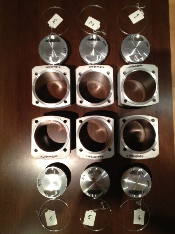

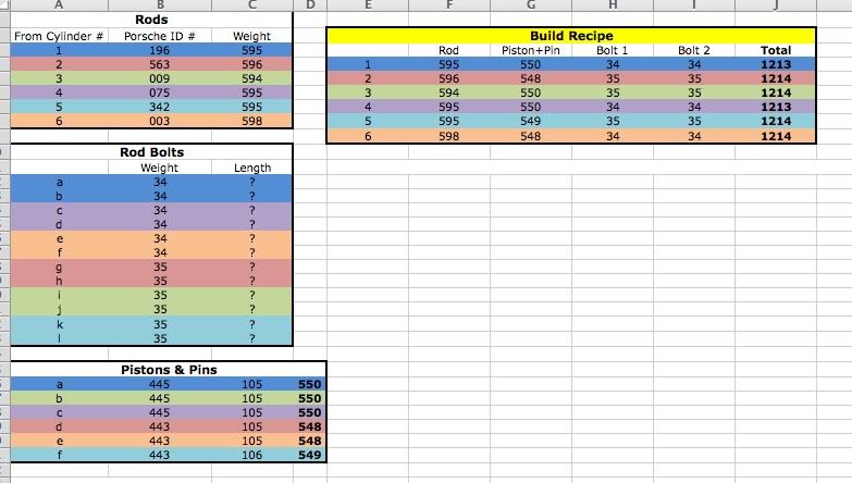

Internal component weighing & matching....
After a quick borrow of my Brothers office digital postage scales (measure to the nearest gram), I weighed everything individually with the aim of mixing and matching for a balanced set of components.
I've measured:
- The con-rods (without shells or bolts)
- The pistons (without gudgeon pins or clips)
- The gudgeon pins
- The new ARP rod bolts
I've not measured the shells, small-end clips or piston rings; surely there can't be any variation that's either measurable or warrants consideration?
EDITED from earlier....I've had a juggle with the spreadsheet numbers; chatting this through with a mate earlier this evening, he had a good point with regards to the pins being matched (honed) to the pistons at Omega, so probably not a good idea to start swapping them about. As you can see from the screen grab below, I've mixed and matched the various components to get consistent set of 6 (haven't got around to measuring bolt lengths yet) --->
So, re-calculating the total combined weight of the assembly as they came from Omega, I plugged these new numbers in, and got an even better result than previously. I still have two assemblies that are 1gsm lighter than the other four, on #1 and #4, where I'd want them.
I also don't now need to have one lighter bolt paired with a heavier bolt in order to fine-tune the rod weights. Good stuff.
A question.....Would you guys go to the trouble of grinding 1gsm from the inside of the pins on the 4 heaviest assemblies, to bring them all down to 1213g?
Finally...does all this look ok to you? Method and the actual numbers?

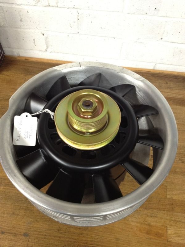

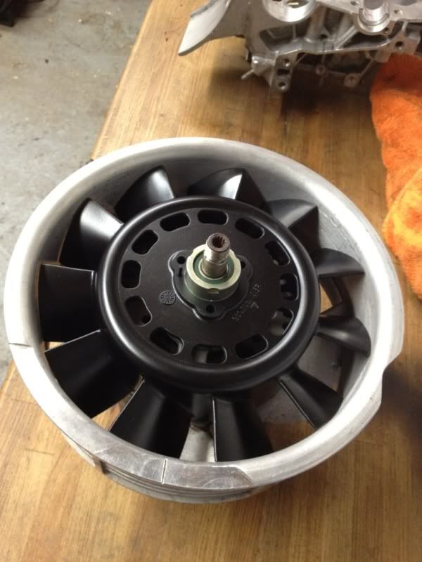

Another job sorted yesterday....got the cooling fan back from my mate Shaun the other day. A very simple one for him to do, just etch prime and spray satin 30% black.
I had removed the spigot/bearing carrier beforehand, making it easier and tidier to spray than masking up. I thought I was going to have an issue, as it took heat from a heat gun on the fan itself, to open it up enough to push the steel centre out. Of course, need to be a little more careful now it's painted!
Steel collar into the freezer for a couple of hours......kitchen oven set to 70degC.....hope for the best but plan for the worst.....it flew in like a charm....even the 3 periphery holes lined up straight away. I even remembered to orientate the collar correctly as there was a witness mark from the pulley pin that told me which of the 3 holes to index to (rotationally), so no balancing issues to worry about (if one ever does worry about them?)
Not fully assembled until I get the pulley halves, etc, back from the plating shop....but I'm happy with that!

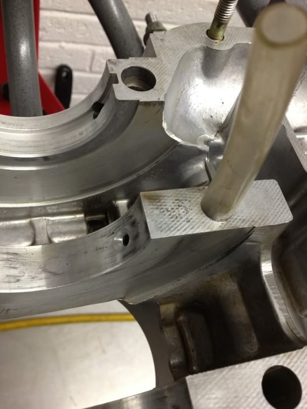

A job I've been meaning to do for weeks but never quite got around to it....check the piston squirters on the RH crankcase half. I did the easier LH squirters a month or so ago; all ok.
Using the method described in this thread, I found a length of thin-walled pipe...a very snug fit that required a long 8mm bolt to be dropped into the top, then gently tapped to get the pipe down t'hole and block off the cross drillings:
Once each was sealed, a squirt of duck oil down the hole in the main bearing holes, then a quick blow through with the air produced a nice oily mist the other side.
No blocked squirters that need drilling out. Good news.

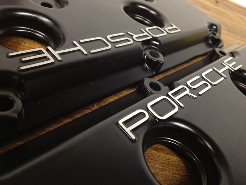

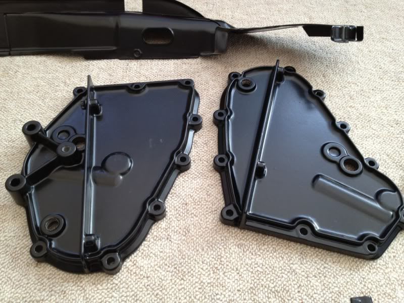

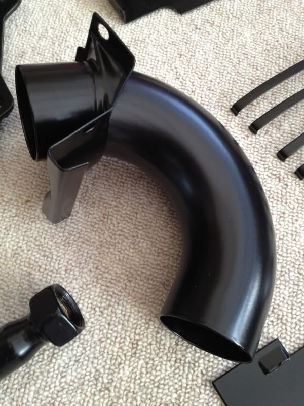

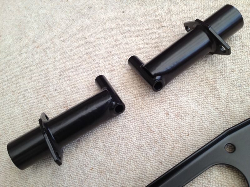

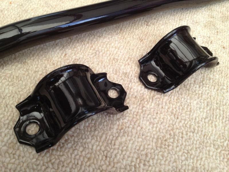

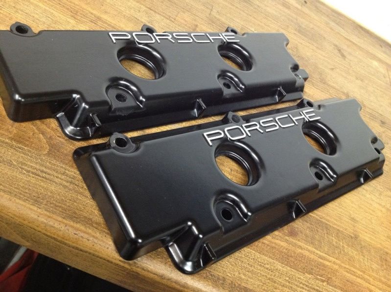

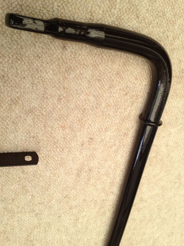

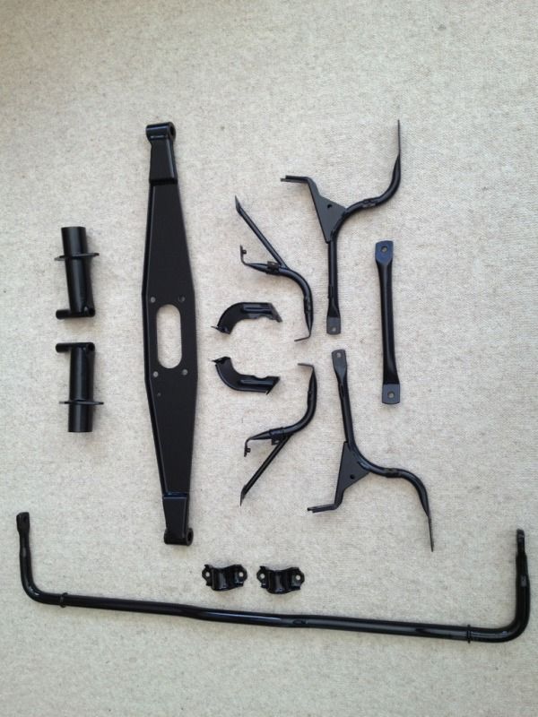

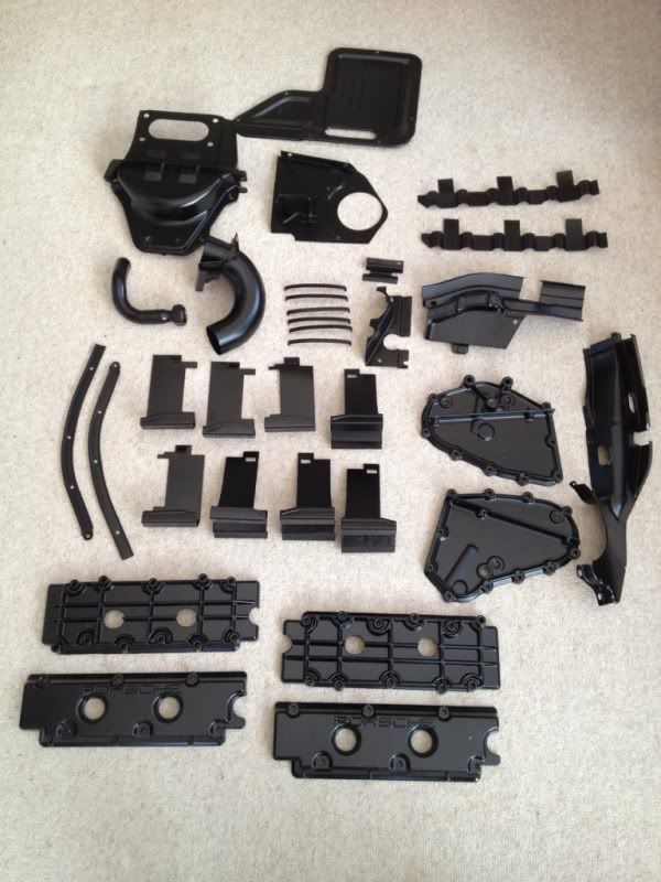

Powder coated items

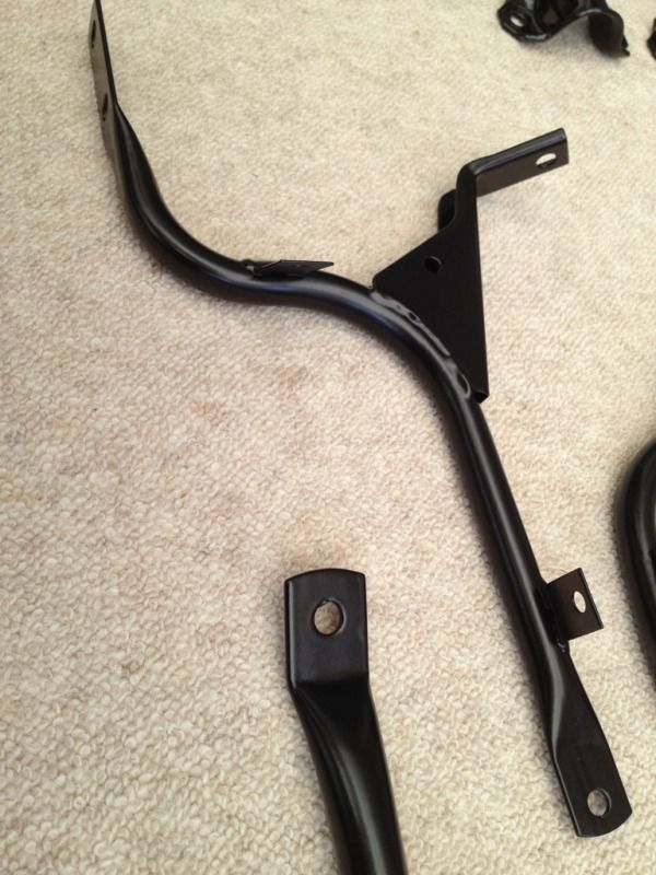

More progress....went over this lunchtime to collect the powder coated items I dropped off a few weeks ago.
Really am very happy with the results - the tinware was looking really shabby before, but after some incineration to remove the old crud, and a nice prime and top coat, they look like new again.
Big thanks to the guys at Windridge Coatings in Broadstairs, Kent...they went "above and beyond" to block all thread holes and tape up all the mating faces to prevent any scratching (and overspray of course). Any holes they didn't have a bolt for (oil feed banjo bolt holes in chain covers) they bunged with foam plugs. Proper job.

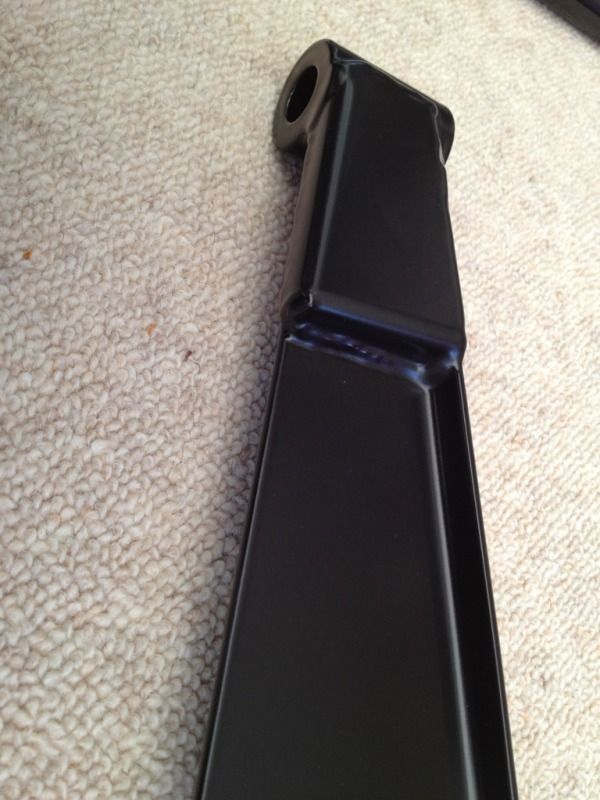

A few more items to do later on; tonights job is to fabricate some strengthening gussets for the engine mount bar, then get it welded at some point, then powder coated. I'm sure I'll find some other items that I missed the first time, in the various storage locations around the house!
(That's not a scratch on the valve cover, just a sliver of cardboard...dirty fingerprint on the chain cover, not got around to cleaning it all yet)
The plating of a gazillion items will be completed early next week.

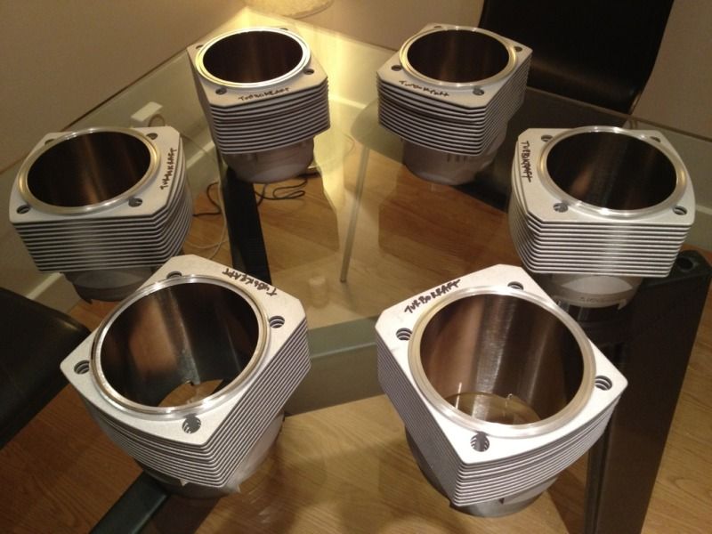

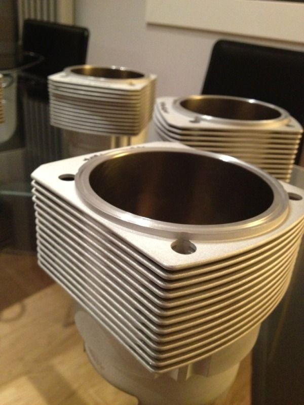

Nikkie cylinders have been machined are about to be shipped (tomorrow hopefully) from LN Engineering.

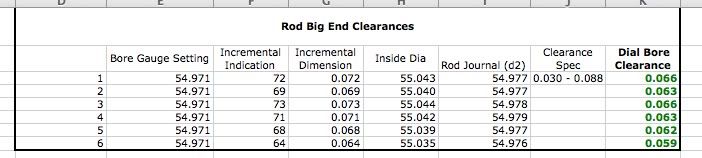

Rods & Bolts....
Time to check the bolts and big-end > journal clearances.
  • Rods meticulously cleaned (would you expect anything less?) and old bolts removed.
  • New ARP rod bolts cleaned, dried and measured with digital mic.
  • ARP bolts carefully pressed into the rods, ensuring the correct weight bolts go into the correct rods, per the mix-n-match table above to get balancing correct.
  • Check to ensure no chamfering required to enable bolt to seat fully - none needed.
  • Shells cleaned and positioned in rods/caps.
  • Rods assembled (nipped up), then clamped in vice for full tightening using stretch gauge and torque wrench.
  • ID of each big end measured with bore gauge
All went without a hitch. I have to say, I love the stretch method of fastening the bolts; somehow it feels so much more accurate than only using a torque wrench. A very worthwhile addition to the tool chest. Removes any calibration concerns, whether the torquing action is done in one smooth movement, etc.
An observation we made along the way - the ARP instructions say to use 40lb/ft or torque in the absence of a stretch gauge - we set the wrench to 37lb/ft to start with, and this got us to 80% of the stretch spec. Gradually upping the setting until 0.0100" was achieved.
What I didn't do, was to leave the torque wrench set per the previous bolt...being a little cautious I set it back down to 37 again - glad I did. The first bolt took about 42lb/ft to get it to 0.01", the second only took 39lb/ft....so there is variation. This continued throughout the set of 12....nothing wildly out, but worth taking the time. Worth noting, that the supplied ARP lube was used on the threads and on the underside of the nut.
Once all 6 were done, time to measure the ID's. The table below shows the measurements I got, and the corresponding clearances once you subtract the crank journal dimensions....all nicely in spec
As a double check, I mic'd the old shells right on the very edge, and compared the new ones, in case Glyco had done another "skinny" batch like my crank main shells....seem ok, <0.01mm thinner than the OE ones.
I did try to Plastigauge the rods onto the crank, but using the stretch gauge, even with my Dad holding stuff as still as possible, it was a bloody nightmare, simply impossible on a bench to get a stretch gauge onto the rods. Maybe with a jig made up, and a vice-mount bracket to bolt onto the flywheel end of the crank, it may be possible, but after an hour or two of trying, failing, head-scratching, we agreed that the slight wobble that's inevitable, would render the readings almost useless anyway, so I'm pretty happy to just go with the "mathematics" method of subtracting the journal dimensions from the bore ID.
The big ends were checked for ovality and centre-centre dimensions, when the small ends were re-bushed the first time around.
When the time comes, I'd triple check using Waynes "droop" check once the rods are assembled with assembly lube onto the crank.
Finally, undid all the ARP fasteners, checking that they return to their undone bolt lengths, and by jingo, they're all spot-on. Phew.

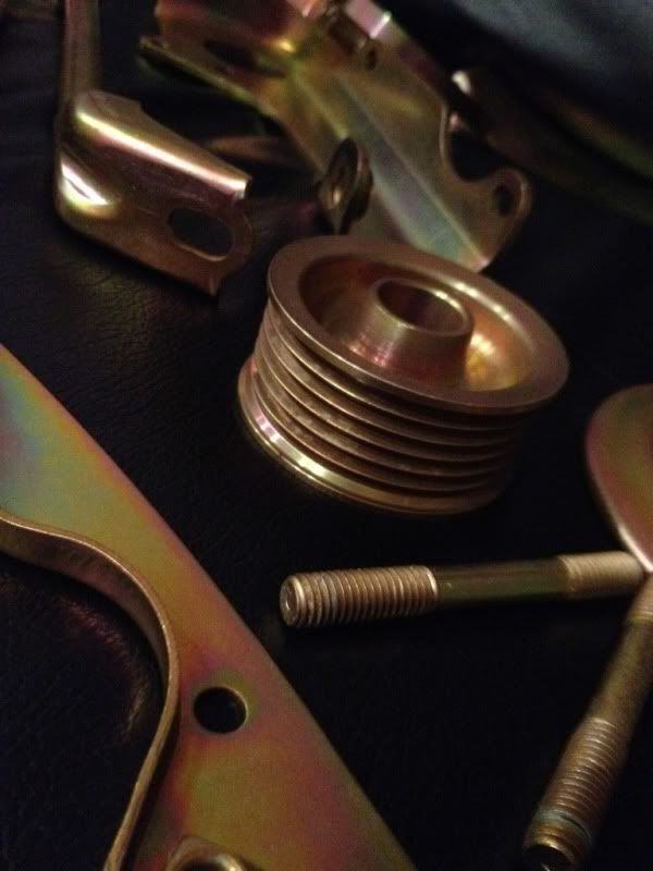

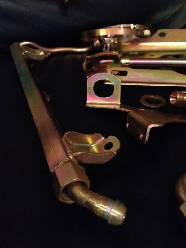

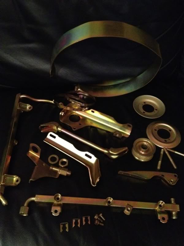

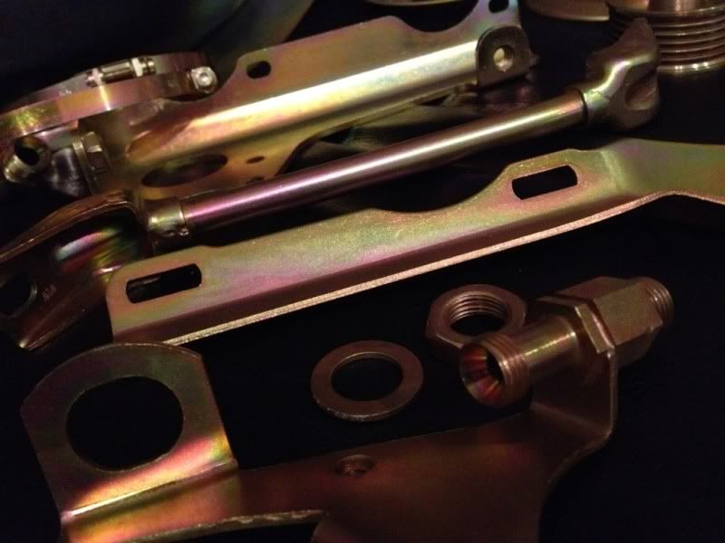

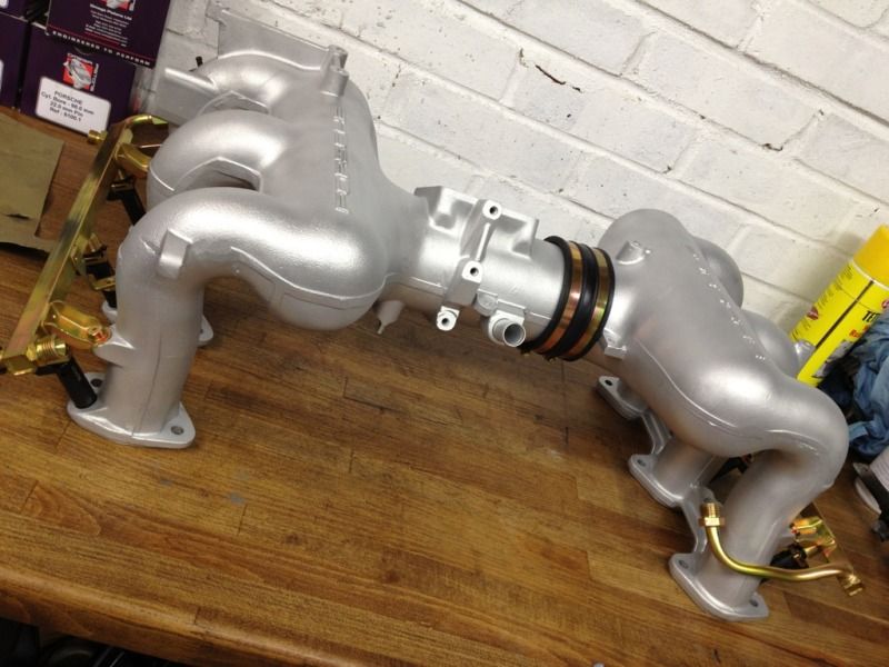

More bling collected today - all the gold passivate re-plating has been done and for the most-part looks absolutely fantastic. Only one or two items have come up a little matt - which I knew was a gamble, as they were so far gone with rust. Full marks to Butterworths over in Ramsgate though, they gave it a couple of attempts at the bits they weren't happy with. I'm really chuffed with the fuel rails - they did look very secondhand previously--->
Some pics of the more interesting items....but also lots of studs, nuts & bolts, washers, etc. All for the princely sum of Ł45. Bargain.
My next task is to re-sort all the nuts and bolts, lol!! Time to open the Porsche PET doc and go searching, haha.
The second consignment from TurboKraft has finally cleared UK Customs, and will be waiting for me to collect it (and pay duty/VAT) on Saturday morning.
The cylinders from LN Engineering have also now been dispatched - I guess these are about 8-10 days away, so no engine building over the Easter break, but it does give me chance to start tidying up the engine bay, fitting new Bilstein HD dampers, cleaning up the suspension and getting the second batch of items ready for powder coating (bumper brackets mainly)

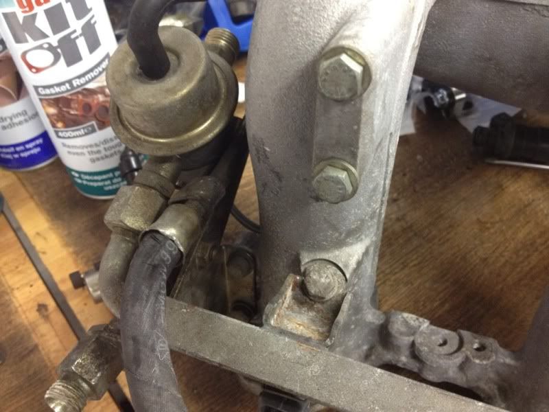

I've now reinforced the engine mount bar, along the lines of the Rennline item, but not quite. All fabricated using the same 3mm steel plate as used for the main bar itself. Didn't snap any pics of that before dropping it over to be coated, but was very neatly welded by the Ducati-nuts over at Fabweld in Deal, excellent job as usual.

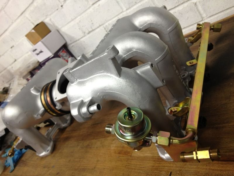

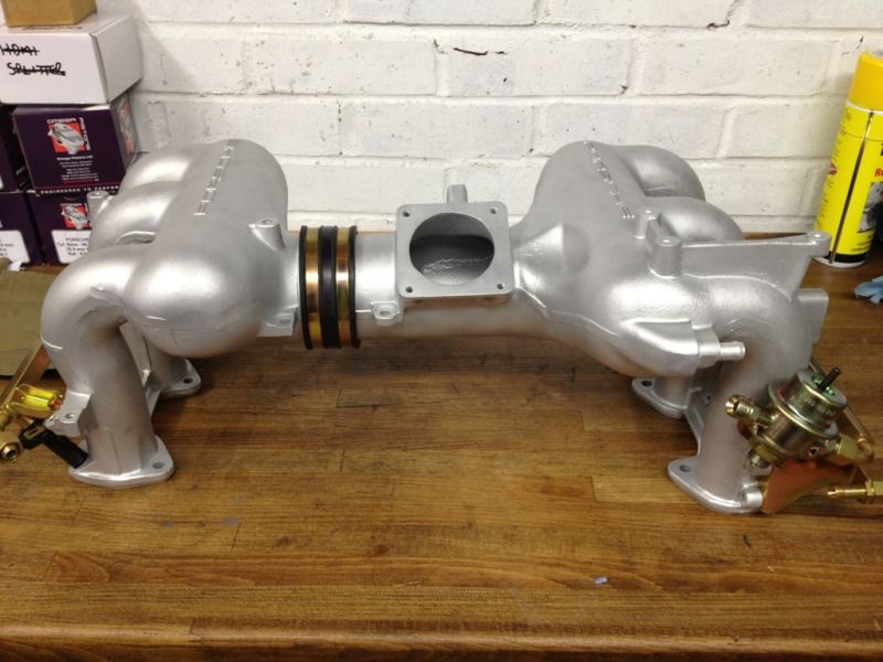

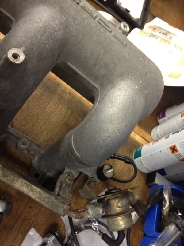

Looks like you'll be rebuilding/replacing the fuel lines, too?
If you don't want a Fuel Pressure Regulator with a clamp on hose barb on the bottom, use a FPR from a 964.
Thanks Chris, yes, have a 964 FPR in my stash of new stuff. Will be fitting new fuel lines front to back, not taking any risks, then fitting them onto the newly plated injector rails.

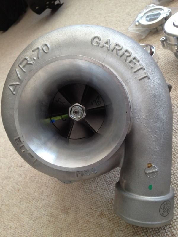

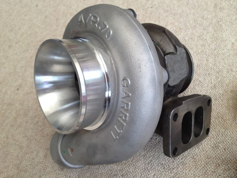

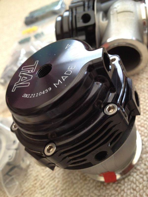

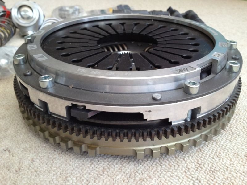

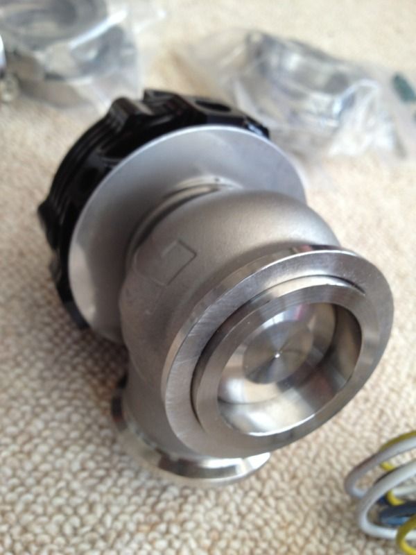

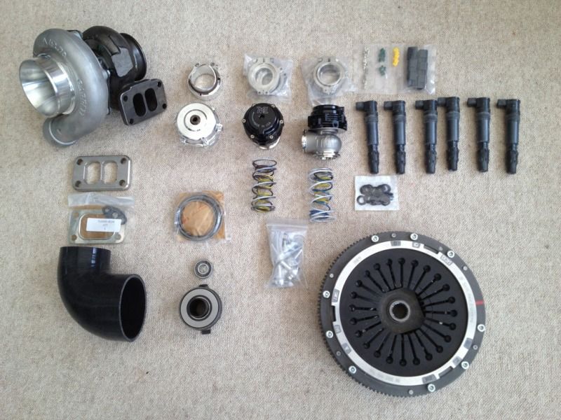

The Eagle Has Landed....well, the eagles component parts
Yep, the second shipment from Chris @ TurboKraft has arrived, finally clearing UK Customs on Thursday and in my local depot this morning ready for collection.
I'll be surprised if I haven't got a speeding ticket, such was the excitement of more toys to go and collect!
This package:
1 x Garrett GT35R
1 x Silicon 4">3" 90deg elbow
2 x Tial Wastegates, spring choices & V-band assy's
1 x Tial blowoff valve & V-band assy
1 x 964RS single mass flywheel & clutch release bearing/tube
1 x 997 GT2 clutch plate

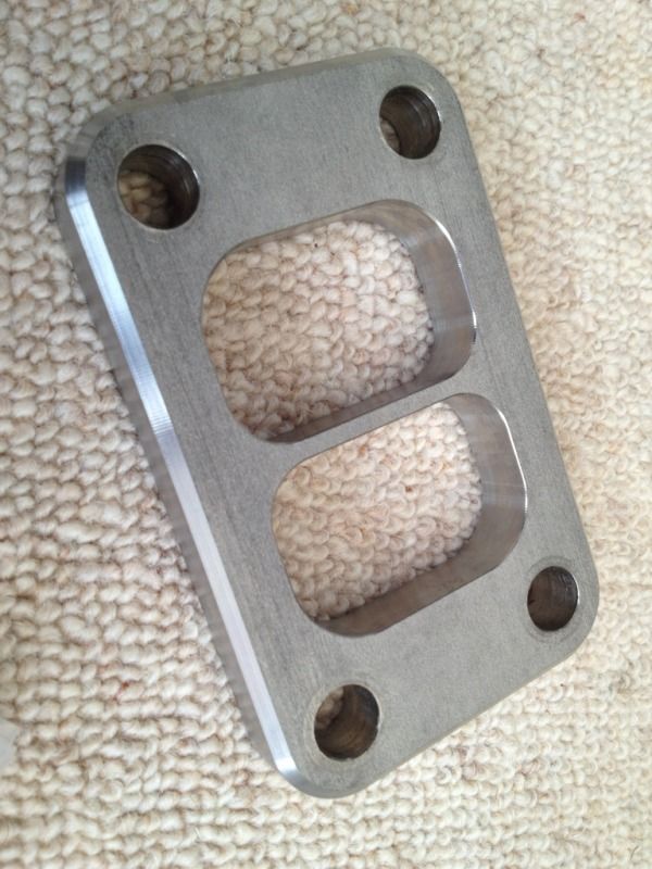

1 x Twin-scroll stainless exhaust flange & gasket

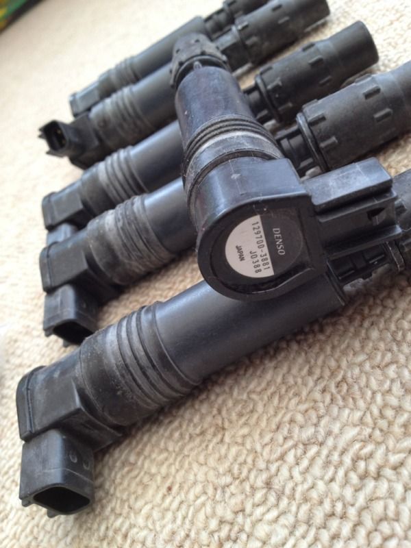

6 x Denso Coil-on-Plug coils & electrical connections
1 x Distributor blanking plug
1 x Pack of RSR rocker shaft oil seals

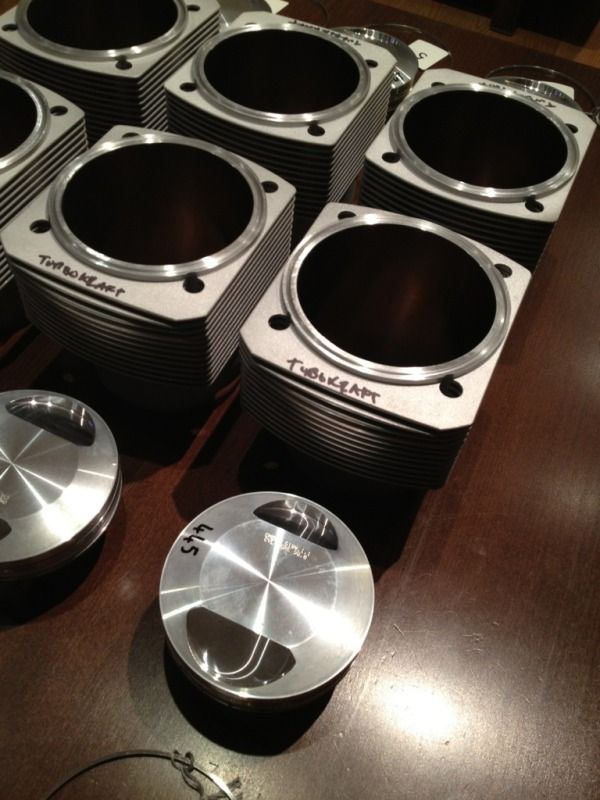

New Nickies are now well on the way over to the UK from LN Engineering...plan coming together nicely.....

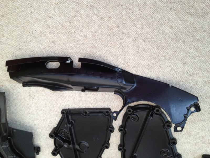

Just a few more photos of todays playing about in the garage - was going to fit new Bilsteins and clean the suspension, but weather not great...maybe tomorrow.
Gentle rubbing back of the powder coating on the Porsche text...lots of masking of the surrounding area and a nice heavy, flat aluminium sanding block with abrasive paper double-sided onto the underside.
Quick assembly of the alternator/cooling fan. Despite thinking I'd got the hub spigot housing aligned perfectly when I heated the fan & froze the spigot, it was ever-so-slightly off, so some very gently heating required to twist it around by a fraction.

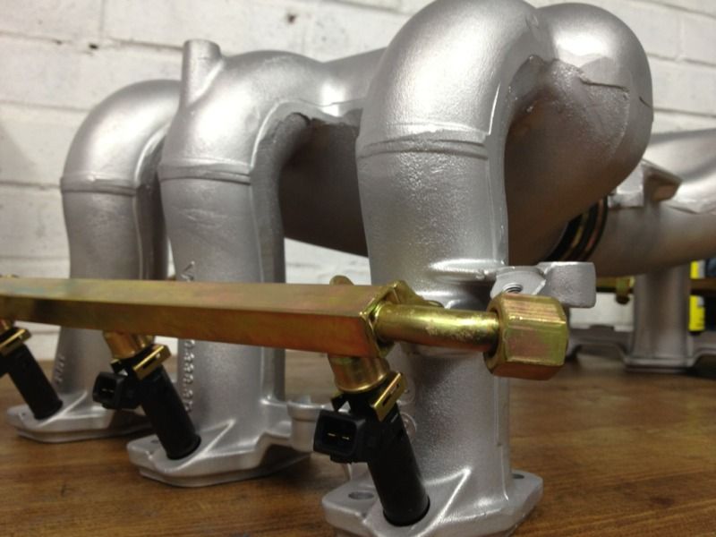

Think I may take the fan housing off to be vapour blasted - not quite as uber-clean as the intake. It'll aggravate every time I open the engine bay if I don't!
Decided to build up the inlet manifold...nowhere near needing it built up, but a good way to see some progress and clear down some parts boxes.

Whilst waiting for the cylinders to arrive, I got on with some chassis work. Didn't get as far as I wanted to with regards to swapping dampers, but did remove all the rear bumper/heat shield stays, and various other brackets.
Jesus, HOW MUCH are replacement brackets??!!....6 x bent bits of tubular metal....$551 + shipping + tax + duty....ouch! I can actually source some of the items (but not the Turbo specific brackets) from Euro Car Parts - local auto store here in the UK - for quite a lot less, but even so, more than I want to spend unless I really have to.
So, wire brush time. After closer inspection, I reckon they will actually come up ok....lots of road grime from 20years & 84k miles. Another batch for my favourite blasting and powder coating outfit to play with. Was also a good opportunity to remove the rear blowers and give them a good clean up. Will probably be replacing those hot air hoses, but have also stripped off associated bracketry for re-plating.
This is fast turning into a full resto project. Argghhh!!

The Nickies have landed....
Collected the Nickies from our local surface mail parcel depot, yesterday morning. Opened the package this evening, and am very pleased. Ni-resist rings machined into the tops, and the two barrels I've checked, the rings I already have seem to be a perfect fit.
So, the obligatory bling shots.....
So, next job will be to re-do a dummy build to ascertain the shims required to get close to 8:1 compression ratio.
Then a plasticine build to check internal clearances.

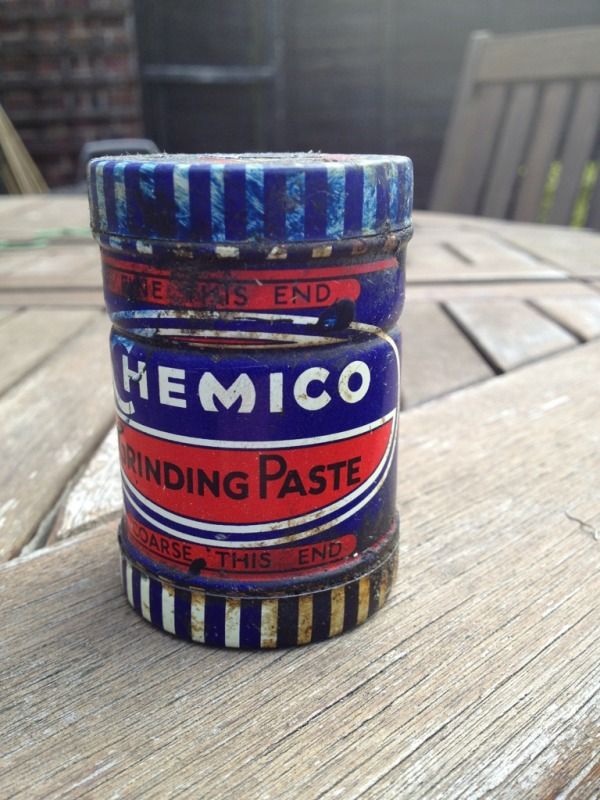

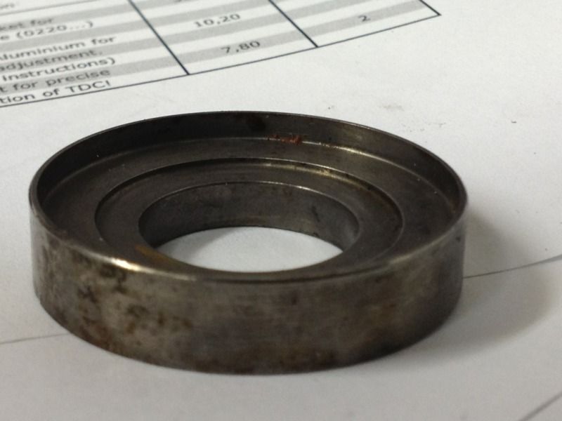

Talking A sentimental update, lol.
Well, in preparing for this weekends activities, dummy-building to check clearances, etc, I guess I'm now in a position to lap-in the new cylinders with my (fire-ringed) heads.
I had a thought at the back of my mind (like most of my thoughts) that I had stashed away a pot of lapping/grinding paste.
I'm aware that this is utterly trivial to all but a few people reading this (Matt ), but it did make me smile a bit. Sure enough, the first storage box I looked in, there it was.....
If I were to tell you that this was my Grandads....and he died in 1984, and hadn't tinkered with cars for a good 8-10 years before that, this puts the pot of paste at about 36-38yrs old. It's as old as me!!!...was given to me by my Grandma (along with a load of his tools) when I started getting into cars @ 17yrs old.
So, now my ol' Grandma and Grandad are part of my engine build.....and that makes me very happy indeed

Long overdue updates....
Okay finally making lots of progress!
Another stunning effort from the guys at my local powder coating shop, Windridges. I collected the second batch the other week, with a number of items I thought would be touch-and-go as to whether they were recoverable or not (the bumper heat shield brackets). One of the diagonal supports under the chassis was rotten through, so didn’t even attempt to re-coat it, but everything else, I swear, looks like new again. Very pleased indeed:
And my modified engine mount bar, which I fabricated using the same gauge steel as the rest of the bar, to reinforce the mount points:

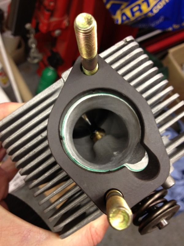

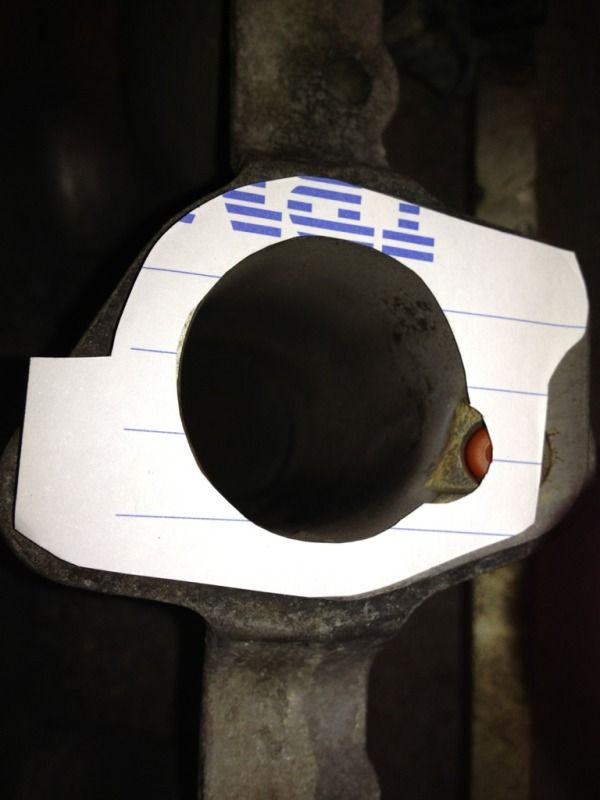

Some previous corrections on the heads
Next, I stripped all the heads back down to check that they’d been built with the correct spring installation heights. In short, they hadn’t; how entirely bloody predicable.
Three of the valves (In+Ex on #5, Exh on #1) were set up with too great a height (ie., too soft base pressure). Thankfully I had some shims to adjust them with. I also took the opportunity to clean the valve train components (!)…they still had the anti-rust coating on, as shown previously.
Also worth noting that when I first got the heads back – a 250 mile round trip – I found that they hadn’t even been ported correctly with regards to the inlet tract not matching the stock Carrera inlet manifold spacers. So, another trip back up there for it to be rectified. Real basic stuff, cocked-up.
Which when transposed onto the Carrera intake manifold I'm using, would've resulted in the injector presenting itself like this -->
Not the sort of thing I’d expect with the money I ended up paying – very much wish I’d just decided to go the whole hog straight away, and shipped the heads over the Pond to XTreme Heads. Oh well, live and learn.
