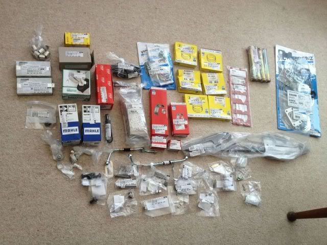

Right, the Pelican parcel landed in the UK the other day, collected it from my regional depot yesterday, handing over a sizeable VAT and import duty cheque in the process!
It certainly felt pretty heavy!
Christmas ptII....all the stock rebuild items. Gasket kits, rings, hardware kits (who can resist new nuts?....erm....), heavy duty chains, new clutch slave cylinder, pressure reg, filters, etc, etc.
I have to confess...it was a tad underwhelming laying it all out..."not a lot" for your $2.5k!! It certainly caused my Brother to raise a disbelieving eyebrow in true Roger Moore fashion!
Isopropyl Alcohol and a new thingy of Loctite 574 turned up this morning (not bad, as I only ordered it at 8pm the evening before), so we're looking good to start dummy building and measuring this weekend.

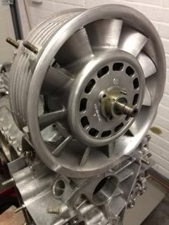

Fan, alternator and fan housing all cleaned up, along with tonnes of other items that I'll be re-using....fan shroud, oil lines plus all the CIS stuff that I'll be selling once I'm a bit further into the project....whoever buys it will be getting some great kit, it looks just like it's come out of factory packaging!
Couldn't resist plonking the fan back on top of the crank case
Am tempted to keep the fan looking as-is, but have heard that if left uncoated, the magnesium will deteriorate, so will get that done in gloss black to match the valve covers/timing chain covers.
Everything seems to be in "go slow" mode at the moment, just a whole lot of cleaning and prep work in readiness for the big build.

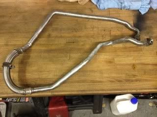

Questions....
Three questions guys:
1) This may be a really dumb-ass question, but does anyone know what the temperature rating of the braided piece of hose in the middle is? Ideally I'd like to get the hard pipes powder-coated to get them the best protection I can; they're a little pitted from rust, not to the point of being thin, just not factory fresh. My Powder coating guy does take a lot of care to mask stuff up, using heat resistant tapes, so I'm not worried about getting "over spray" onto the braiding, just whether it'll stand up to the coating oven, which I think is about 350degC?
2) The nut at the end of this pipe is absolutely locked solid on my pipe...is this how it should be? I'd normally expect this to be loose to allow alignment when tightening it onto the crankcase adapter....or is mine rust-locked? I haven't tried REALLY hard to undo it, for fear of bending the pipe, but did leave some WD40 on it overnight, and made no difference, so assume is brazed in place?
3) Anyone know the length of head stud that protrudes above the top of a cylinder? Any excuse to get on a lathe, I'm going to turn up 6 cylinder holding tools, I just need to know how long to make 'em?

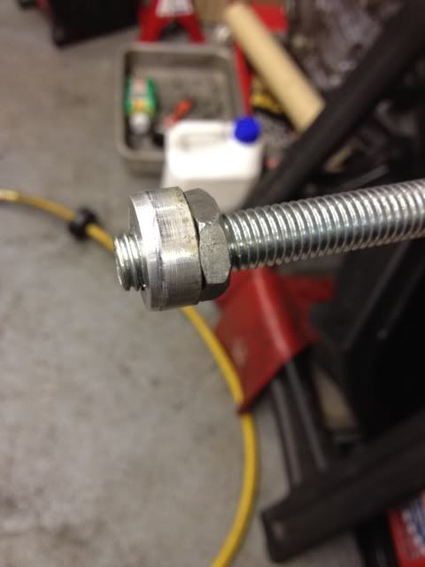

Slight change of plan this last few days....decided that I can't "unlearn" the stuff I read about pulling the plugs in the case halves and cam towers...sometimes ignorance is bliss, but I guess tres-expensive! I wasn't planning on pulling the plugs, just flush through with cleaner and air (there's been no catastrophic failure, and the a complete lack of oil sludge inside the crank case, but if I didn't do it, and then got premature wear or a spun bearing, I'd be seriously pi55ed after all this effort.

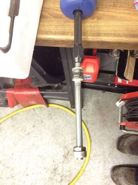

So, off to Machine Mart...again....at lunchtime to get a slide hammer. Also popped into my local bike shop who apparently had gun cleaning kits (...don't ask...), so bought a nice kit of brushes, wire and felt.
Made up an adapter to be able to use an M8 bolt in the case plugs. Brave pill time again, drilled and tapped, slide hammer mounted but it got too late to start wanging it about this evening; all ready for a flying start after work tomorrow evening.

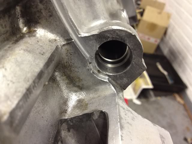

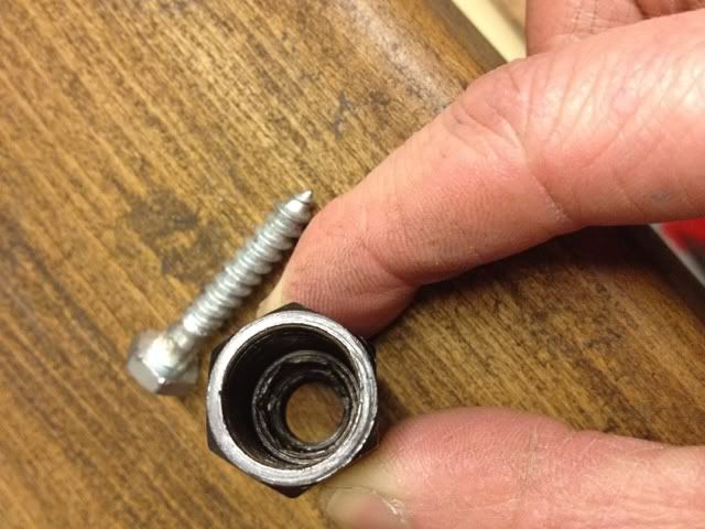

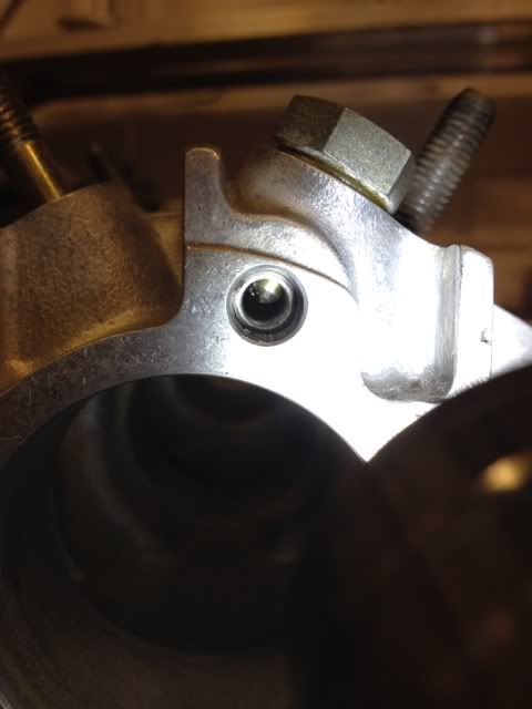

M8 bolt mentioned above was a complete waste of time, threads pulled straight out....in hindsight, very obvious but no harm done.
Bought a set of decent tap wrenches to allow me access to the bung with an M12 tap. Redrilled, tapped, made a new adapter to mount an M12 bolt into my slide hammer.
Plenty of heat with a hot air gun (paint stripping gun), 2 whacks and it's out. Used an nice long rod to punch out the other end (flywheel) from the inside. Easy.
Spent even more time re-cleaning the internals of the case halves. Used a can of this -->
...to clean up the last bit of powdery residue; it wasn't about to come off in a hurry, hence this can of aircraft spec cleaner/protector was needed to get it off, but glad I did, now very clean inside --->
Used the gun cleaning kit to run a set of wire brushes and felt cleaners up the high pressure oil gallery, then cleaned each of the crank journal oil feeds. Did the same to the pressure relief valve gallery, and the #7 & #8 journals (although flushed these out rather than removed the ally bung from the case).
Glad I did it for peace-of-mind. Although I didn't find any gunge up there, there may have been the odd bit of detritus, I'll never know, but if there was, then it's out now. It would have only served to scuff the new bearing shells, so a good investment of time.
For those that are searching for info on removing these bungs, once out, this is what you'll see.
Note the taper 7-8mm in the bore; this mates with the chamfer on the leading edge of the ally bung.

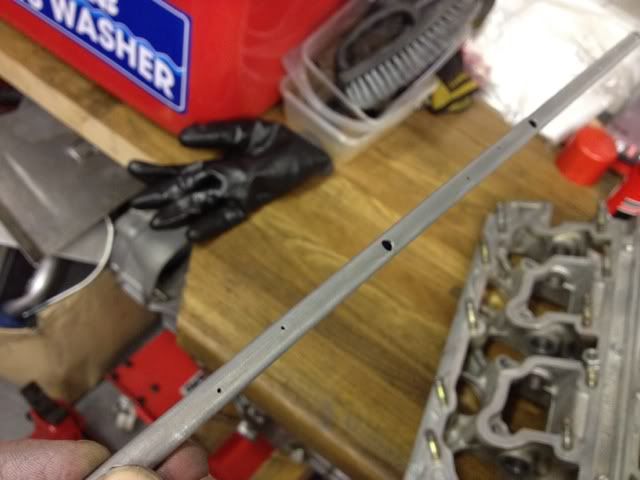

So, today I went about cleaning the cam spray bar in the cam towers. Not wishing to repeat my earlier mistake of tapping/using a bolt with a fine thread to remove the bungs, I used a "self-tapping" hex headed bolt, that sits nicely in the slide hammer adapter.
Drilling a hole slightly less that the OD of the bolt still allowed plenty of purchase, and of course the thread pitch is nice and coarse. Again, plenty of heat from the paint stripping gun to soften the retaining compound, and they came out very easily as well.
Undo the hex blanking plug that is the locating pin for the bar:
...and then a parallel punch to gently tap out the bar from the housing. A little tight in places, but came out pretty easily with some duck oil being squirted down the outside of the bar.
All pretty clean again, but repeated the procedure....gun cleaning wire brush down the bore (exact fit) and fuse wire through each spray hole. Noticed a few high spots on the OD of the bar, that probably didn't help with the removal....gently used a very fine needle file to polish them out, then some fine Scotch Brite to remove some oil glazing. Final spray with brake cleaner, blast through of air, and ready to refit.
Took the opportunity to drill out 3 x sheared off M6 bolt/stud remains from various places on the housings....somebody over the years has obviously had a go at removing them from the outer edge and the "roof" of the cast, sheared them and then just left them in. Now all drilled out and re-tapped. Good job done.
Another cleanup of the oil-facing surfaces inside the castings, and then refitted the bars using new aluminium crush washers on the oil feeds/locating plugs.
For the time being, I've just taped over the holes where the new bungs need to be installed....am contemplating using 1/8th NPT bungs, as described here, but unless things go horribly wrong, I don't plan on needing to remove them again for a long time.....turning-up a few bungs on my mates lathe will be a very simple and quick job (along with new bungs for the crank case halves).

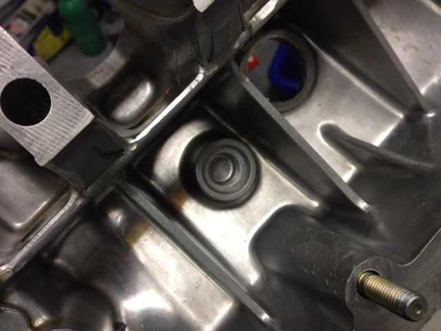

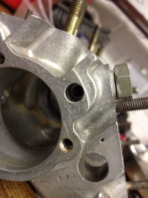

Made some new oil bungs to replace the seven I removed; 2 for the high pressure oil feed on the RH crank case, a smaller one nearby that is for the #7 and #8 bearing journals, plus the 4 x camshaft oil spray bar plugs on the cam carriers.
All now installed, spray bars installed into the cam carriers (in the correct orientation!), and the oil feed boss & blanking plugs all torqued up - my first dab of paint-pen to mark everything that's tightened!

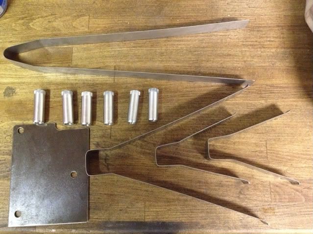

Whilst waiting for parts and machining work, I made up some of the tools I'll be needing:
Rod & chain holders are all in stainless...nice and clean and no need to paint.
Am using a magnetic stand for the DTI for the cam timing, so made a good thick mounting plate that slips over 3 of the valve cover studs.
Finally, complete indulgence, found some scrap ally stock and turned-up a set of 6 cylinder holders.....guesstimated the dimensions, hopefully they're about right! M10 thread goes halfway down the holder, the first half being 10mm clearance to save endless screwing-on.

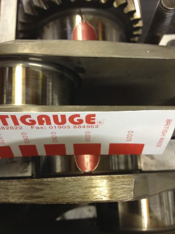

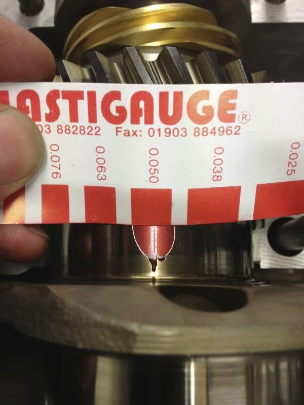

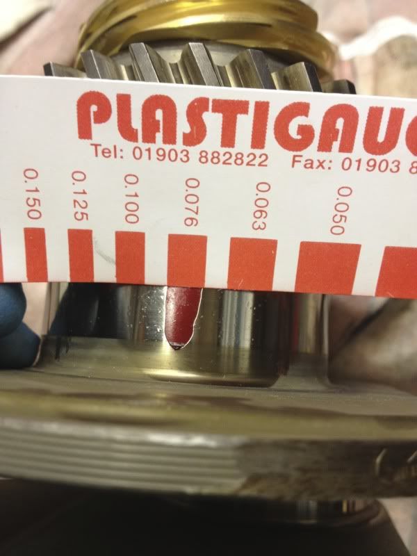

What I can do though, is to check crank bearing clearances, put the new seals on my new #8 bearing and get the head studs cleaned and inserted. Time to also sort out all the stuff that needs re-plating and powder coating - get ahead of the game with this so I don't get held up later on.

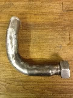

Ok, little bit of progress this week.
Bought a set of 9 x sprays from a nationwide parts shop here in the UK (UK guys, the CarPlan assorted spray set from Eurocarparts, about £20....very good...used 2 of the sprays so far with 100% success)..included in which is a penetrating spray - of which I'm usually very sceptical, never had much luck with them.
Thanks to a reminder from Chris @ TK the other evening (had completely forgotten this as a "job to do"), I carefully mounted the 90deg oil pipe (above) into a vice, and sprayed penetrating fluid into the top of the nut, left it overnight, came back to it this morning with the trusty 36mm spanner. It didn't take much persuasion at all to free it up - can't believe it was rusted on that hard, I swear it almost appeared as though it was designed to be fixed in that position (again, thanks for the guidance Chris )....so the marketing BS on the spray can, "graphite this" and "graphite that"...seems to live up to the mark!
With regards to the larger oil line in the above pics, I think I'm probably going to replace the whole line with some uber-braided lines, using AN-16 JIC and Metric fittings where needed. Went into Think Automotive (linked in prev post) - really helpful guys, know their stuff. Either going to use the relatively cheap(er) push on hose fittings, well proven, pressure spec'd well in excess of this kind of use...or push the boat out and use some very light and flexible TFE hosing with either swaged on or re-usable olive fittings...same stuff race teams use, has a far tighter bending radius than "standard" TFE hosing. Plenty of options, all of which are far cheaper than buying stock parts from Porsche, but will firm up a plan nearer the time.

During the week, I also set about checking the crank journal clearances. Without wishing to open a holy-war debate about bore gauge vs Plastiguage, I've gone with the latter. Mainly due to lack of dexterity to be able to insert gauge down the flywheel end of the crankcase, with stand mount in place, and feed it down the bore towards the #8 bearing, whilst holding it through the cylinder spigots and STILL try and use it in a way that I could get consistent and accurate readings. Wasn't going to happen, frankly.
So, I'd ordered some Plastigauge in the kit of stuff from RS Components a few weeks ago, time to use it.
Interestingly, the guys @ SBD only use Plastigauge for their crank journal clearances - they do a lot of Suzuki Hayabusa tuning, not just tweaking but full on bespoke internals and rebuilds for race spec....the Suzuki rebuild manual states that Plastigauge must be used to check dimensions. SBD also use this method for their Ford Duratec race engines; again, worth noting that Duratecs run far tighter clearances than these aircooled lumps (like "off the scale" on the Plastigauge key).
I guess another benefit to Plastigauge is that on the crank it'll give you information about relative problems between adjacent journals...a bore gauge measurement won't, it'll only give you an absolute dimension, the adjacent journal could be completely out of kilter in terms of alignment, but still clock-up as "ok", and you'd know nothing about it until the crank binds.
Anyway, I digress....not good results on the first check with the new Glyco shells (all "STD", btw), but not helped by me forgetting to fasten the stud in the timing chain housing. All case through bolts apart from this one, were torqued up in the right order, but the clearances I was seeing ranged between 0.050mm and marginally larger than 0.076mm. Straight away, out of Porsches tolerance of 0.072mm.
Hmmm....time to dig out the "old" shells, which not only did I keep but also bagged and labelled each for it's location. Cleaned them up, put them back in and re-did the test....this time remembering the timing chain hsg nut, but also doing the peripheral nuts (not that it *should* make a difference, but just for peace of mind).
Straight away getting far better clearances...on 84,000 mile old shells....go figure. This time seeing fractionally tighter than 0.038mm on some journals, but generally just a bit tighter than 0.050mm.
So, quickly grabbed the micrometer to measure the very edge of the new shells and the old ones, and there's consistently a 0.01mm difference - new Glyco's being thinner. Double that up for the diameter, and that 0.02mm isn't helping matters.
For completeness, re-assembled using the new Glycos, everything re-cleaned and fresh Plastigauge in place. Torqued everything down, again remember to do all through bolts and the perimeter nuts. Marginally better this time, mostly they're around the 0.063mm range, some a little tighter, and one or two are 0.050mm.
Not a great set of results, and not that happy doing a fresh, full rebuild and starting off with clearances that are looser than when I started!
The plan is to go up to Richard Chamberlains, and we'll swap shells with new ones he has, on a per journal basis, to get it closer to the 0.010 clearances....he prefers to run a "looser" crank on his own race engines, as they're always rebuilt after 24hrs (max) use.
Glad I took the time to check this, and not just trust the fact that I'm fitting new Glyco shells as being "OK".
I also found out that if you go to Ford for new shells for the Duratec, you get one choice of size....go "aftermarket" and you get 3 x fractional sizes for each nominal dimension, so straight away you can blueprint the crank build, per journal, as I'm going to be doing...modern engines, eh?!

Clutch plate has now arrived with TurboKraft - hoping that the second shipment of parts will be leaving Arizona very soon to turn this dismal last few weeks around.
Nice set of new Omega pistons sitting in my office, boxed and ready to install.
Various parts are with powder-coating and plating shops. Other parts have been vapour blasted and look very nice.
But, frankly, I'm completely f*cked off with how this is all going....taking a tedious amount of time to get anywhere and wasted a complete weeks vacation last week, which I'd hoped to have a timed-up long block finished.
Keep telling myself that the good news is that I'll (eventually) have a great spec engine using brand new parts from my "wish-list".
Hopefully all my new parts from TurboKraft will arrive shortly - that'll put a bloody great big smile on my face.
