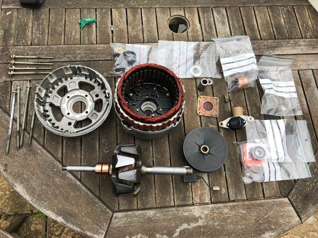

Update Part 2 - Alternator/Fan Refurb
In the last few weeks, it's been a case of sorting out the snagging jobs list. A few remote sessions with Sam to iron-out a few things I;ve noticed while driving, and to also enable the water cooling circuit for the turbo.
I bought an IR Pyrometer a few weeks ago, so that I could use it's laser dots to aim at the very little header protrusion from the cylinder heads, and get an idea of exhaust temps individually rather than at the collector for each bank. Quite interesting, insomuch that Nos.3&6 were running a good 70-80ºC hotter than the middle pair. The front pair, 1&4, were somewhere inbetween. With some quick adjustments to the duty cycle of the IDX1000 injectors, we've got them all a lot closer now. Whether that transpires into something we needed to be worried about, I don't know, probably not but it can't harm.
I still have a missing tach signal, which is an annoyance. More work needed to trace the wire in the harness and make sure it correlates to the correct ECU output.
If you remember back to a few posts ago, I thought I heard bearing rumble on the alternator or cooling fan. To this end, and to correct something I didn't do the first time around, I stripped the assembly and replaced all 3 bearing; 2 in the alternator, 1 on the fan. In addition, I also refurbed the commutator copper contact slip-ring, and bought a new set of brushes and regulator. I did also buy a new slip ring in case mine was too far gone and needed to be replaced; it wasn't, and being a soldered on part, I left well alone.
I must give credit to Pelican'er JWPATE who took the time to write-up his refurb project, here
This made it a far quicker process; although absolutely not difficult, knowing what will fall out of place next and potential sticking points where extra tooling may be required, was invaluable.
So, some pics of the stripdown and refurb of the slip-ring on the lathe.....
Not too much to add to this, all self explanatory and described very well in the above linked post.

Update Pt3 - Alternator/Fan Rebuild
All very straightforward on the reassembly, no tricks or gotchas....
The only pain in the bum, was that the nose bearing on the cooling fan is a right sod to get out. No traditional circlip here, instead Porsche have used a split ring that's nigh-on impossible to get out. I had a go, but damaged the waterseal on the ballrace, so a whole new assembly it is from Porsche....
All back together and in the car, and things sound smoother.
