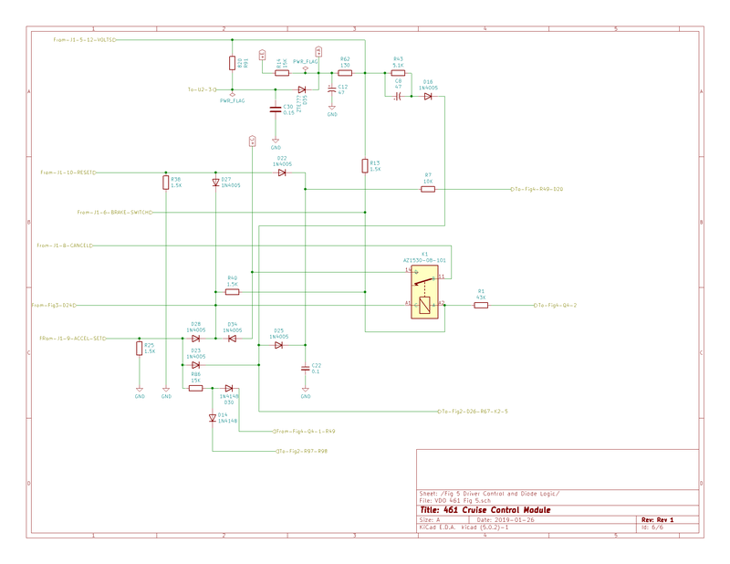

I have recently spent a lot of time working on the Tempostat Cruise Control Module for my 80SC in order to be able to understand it and hopefully repair the system. My cruise control would engage but not hold speed. In other words, as long as I held the Set/Accelerate switch up the car would accelerate but once released it would disengage. Researching this site and the internet provided a lot of useful information along with information that was not accurate for the module in my car. The Cruise Control Module in my 80SC has the following stamped on the case: 10.79, 12V, 412.203/1/10, and 928.617.127.00. The circuit board is a VDO 461 module and it does not match with any of the schematics that are available via the internet. Granted, there are several failure modes with suggested solutions so a schematic is not really necessary if you can locate certain parts on the module that are known to cause problems due to age of the components such as the electrolytic capacitors. I did all of the basic tests for the external switches and only had to adjust the clutch switch. I also removed and bench tested the tempostat servo motor with a 12 volt power supply and a vacuum pump. The servo motor checked out under vacuum and the servo solenoid engaged. So the only thing left was the tempostat cruise control module.
This is a picture of the tempostat cruise control 461 module from my car.
It is very noticeable that this module has two Quad Op-amps in the circuit where the available schematics for a similar module has only one Quad Op-amp and one single Op-amp along with a variety of components in different locations on the board.
Since it is a 40 year old module that is no longer manufactured and no detailed tech data available we are left with not many choices for replacement or repair. Granted, there are several places that will for a very reasonable price will test and repair the module. As a DIYer my curiosity got the best of me so I set a goal to create a usable schematic and board layout for the circuit in order to troubleshoot and repair my own board. Yes, it would have been easier to send it off and have it repaired but there is no fun in that.
I used a program called KiCad, it is a free software suite that features an integrated environment for schematic capture and PCB layout. Naturally there was a learning curve with using the program. The schematic capture requires that you manually add the components to a blank schematic and add the point to point connections of each component. Once the schematic is completed then the PC Board layout of parts and wiring ratsnest has to be done.
It should be noted that I am not a design engineer so the schematic may not be laid out in the most efficient manner. Also, the KiCad program verified that I do not have any open ended components and it found no errors. The PC Board layout is not exact since the footprints are generic and not specific to each component. I was only concerned with getting the layout close to what the actual board looked like. I believe that the schematic represents the actual circuit board but I am the only one who reviewed it so their was no peer review. If you do notice an issue please let me know.
I tested all of the components that were removed from the circuit board and only came up with three components that needed replacing. The two electrolytic capacitors C8 and C12 did not charge to the 47Uf capacity. Also the C20 capacitor is a small 68PF capacitor that I thought was iffy so I replaced it. All of the other components transistors, diodes, resistors and relays tested good. The module is now working and will set to the desired speed. It initially will cycle by about 2 miles below the set speed and then level out and maintain speed.
I do have one issue with the zener diode D35 I cannot read the rest of the part number after ZTE, so if anyone can provide that part number it would be appreciated.

Great work! Any chance you could photoshop a red arrow pointing to the three components you replaced on the picture of the module. With the small print it's real hard to find the components on your board layout,
especially C20 (found C8 and C12).

I have labeled and put red circles on the two electrolytic caps C8 and C12.
C20 is the 68PF cap that I was unsure if it was good (did not get a good reading on a capacitor tester).
I have also highlighted cap C19. This cap is attached to MOSFET transistor M1. I have read that this cap becomes the standard voltage against which the cars throttle is controlled through the servo amplifier. I did not replace the C19 capacitor because it tested good.

My only goal was to create a schematic for the sole purpose of troubleshooting my module. In order to create that schematic I had to reverse engineer the physical circuit board using the KiCad program and it took many hours over many days to complete. The KiCad program has the capabilities to create the schematic and the design template for the actual PC board that can be manufactured. With additional work on my files they could be used to create a new PC board so I will not be willing to share the actual KiCad files. I can convert them into a PDF file that would be usable as a schematic for troubleshooting and would be willing to email that to you.

a well readable PDF would be fine! I am just trying to fix my CC module as well (see post here ), had it working for 5 days, now it's back to 'not engaging'.
I have been trying to do the same thing (I have 2 faulty modules) for my '85 Carrera, not trying to produce copies. After a year of working on the car to put everything back to original and in 'new' working condition, this is only one of the two problems I am left with (the other one is one headlamp washer not working) and I am sticking to doing all the work myself.
BTW, I will open my spare box this evening to see if I can find out the label on the ZTE diode...

As you can see in my earlier post ( here ) I am trying to fix my board myself. I am putting my car (85 Carrera) back to full original and after one year of working I have 2 'faults' left : the VDO cruise control not engaging 'on some days' and one headlight washer not working. Trying to do all the work myself, including the electronics.
So a PDF with somewhat higher resolution (readable numbers) would be just fine for me !
