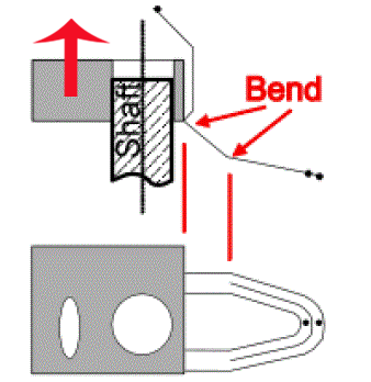

Just noticed something different with the 964 AFM, although I don't know if it's
really that important. Had the cover off my 964 AFM and noticed it has a set of three contacts on the copper wiper unit instead just two on your 3.2 AFM. I know the two units are interchangeable, but there is that subtle difference.
Three contacts surely offer better redundancy than two.

It's not just the lack of noise or spikes in V out, but the correct linear rise of voltage as the door opens, that was originally calibrated by Bosch when the meters were made. Your voltage curve is likely very much out of spec, both from the curve change from the track wear, and possibly a someone messing with the spring tension. From experience, what you have is responsible for a lot of problems such as you're having. You can try renew it, it only brings it back or closer to original spec, and certainly can't be any worse than it is now. The width of the wear spot on yours is alarming though, 3x thicker than what is normally seen, as the tips of the wiper are just a needle's width in contact. Either the wiper was moved around before, or the tips have flatspotted. If that's the case, you practically need to recalibrate the whole thing by monitoring AFRs while driving the motor under different loads and rpms to bring the whole thing to where it should be. In any case, if you decide to renew it, best is to reposition is as illustrated below:
Move the tip inward maybe about 1mm, and angle the wiper tip to maintain the same angle it had originally to the carbon track. Also adjust the wiper pressure so it has just enough pressure to maintain contact, so as when it just makes contact give just enough pressure for the wiper to deflect another 1 to 1.5mm of pressure. Too much pressure accelerates wear of the carbon, which you don't want. The arm should be positioned a couple of mm higher up on the pivot hinge than before in order to allow the tip to come inward. If you have a contact enhancer, lube and treat the track with it. I always use a DeoxIT pen on those. But your meter could be at the point of no return. It's also a bit questionable that half your wiper tip is off track completely, as if someone loosened that philips screw and repositioned the angle more clockwise to address a rich issue. They usually should not be that far off track, and most of the time are usually all on the carbon track when parked.
Porsche superceded the AFMs on the 3.2s to a 964 part number. A few years ago, Porsche offered replacement AFMs on an exchange basis for something like $700. No idea who redoes them for Porsche. The 964 units do all have a triple tip wiper tip, along with a reduntant wire from the wiper arm to the copper wiper bridge contact above it to reduce noise and resistance. The triple tip AFM can be found on some of the later 89 3.2s. These units do seem for some reason to exhibit less wear over time then seen on the 3.2 units, most of the time they look really good. Whether the calibration is the same, I'm not absolutely sure. The last 964 unit I tested seemed to have noticeably tighter spring tension than the one on my 86, and the throttle response also seems to be not as sharp. I ended up recalibrating it, loosening the tension to be the same as on my 3.2, I forget but I think by about 4 or 5 teeth, which brought the response to where it was equal.
Autobahn is where a lot of the Singer parts get sold to. You could contact them directly and speak to Mike who's in charge of those parts.

The width of the wear spot on yours is alarming though, 3x thicker than what is normally seen, as the tips of the wiper are just a needle's width in contact. Either the wiper was moved around before, or the tips have flatspotted. If that's the case, you practically need to recalibrate the whole thing by monitoring AFRs while driving the motor under different loads and rpms to bring the whole thing to where it should be.Autobahn is where a lot of the Singer parts get sold to. You could contact them directly and speak to Mike who's in charge of those parts.
I agree - the strip wear seems to be thicker than every other photo I've seen of them. Seems likely that someone already messed with this, and moved it to a new spot (which is now possibly wearing).
