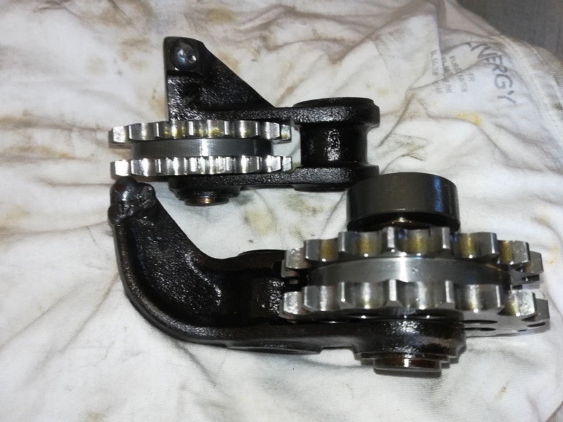

here some genius helped himself with a stretched chains...welded some extra on the arms to cover the space...oh ya the chain was rubbing on top a little..That was 911 imported from over the pond.....
Ivan
[IMG][/IMG]
