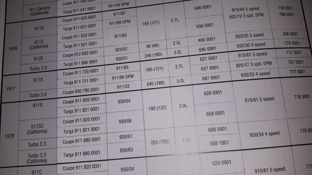

Porscher 01-29-2015 10:45 PM
According to this it's a 911S engine, not really sure what that means.
[IMG]http://i42.photobucket.com/albums/e3...psd976f325.jpg[/IMG]
JJ 911SC 01-30-2015 02:10 AM
The good new is that you got a match as it shows seem it was also fitted in the Coupe. Your VIN would confirm that:
911820001- on: Coupe
911821001- on: Targa
As for the S, they seem to be missing the C.
The first line for the 79, seem to be missing the S...
Which book is that?
Have you been on Porsche Simond site?

Porscher 01-30-2015 04:44 AM
Which book is that?
No it's the "Joma parts and reference catalog", think it's company from Belgium.
Anyway thanks for the info, i thought there were like 15000 made of my SC, now is "only" 2500 :) that's good news.
