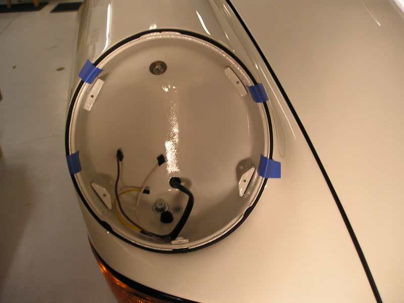

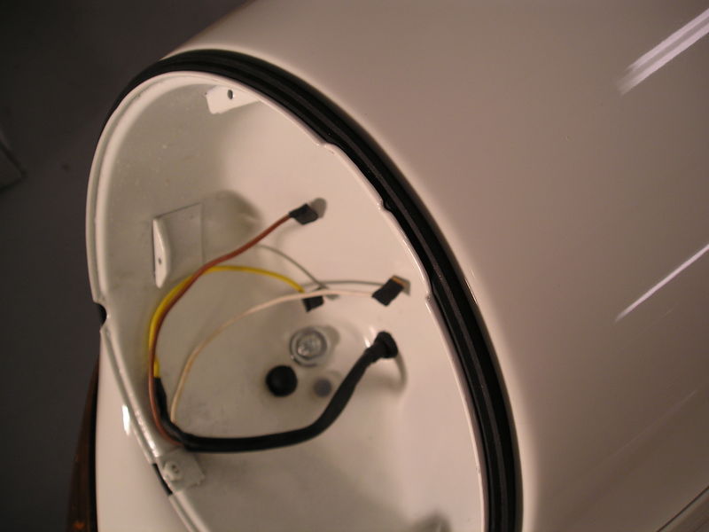

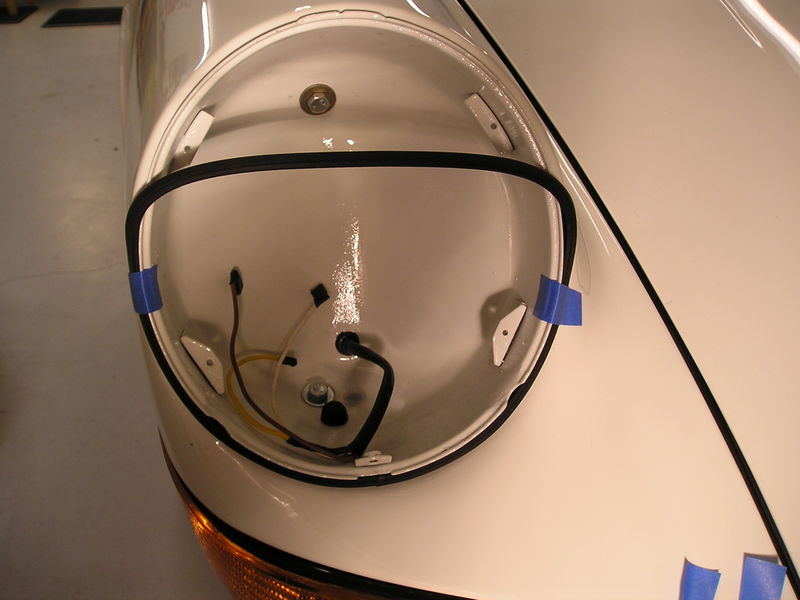

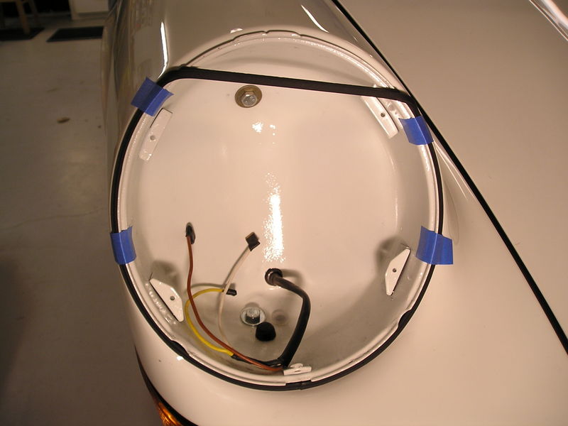

Per Draco & Nine9Six replies, these pictures may help.
Tack the seam to the fender with a dot of weather srtip cement in the six o'clock position and work your way around the circumference, taping as you go. The first two tape placements isolate the seam from the stretching. Also, note the correct orientation of the seal in the last pic.
Good luck

Thanks to all. Was able to reglue and install, gently this time.

Sorry for silly Q, but what this pic represents?
Thank you,
another tidbit
"Y" <- My favorite question...
+ '68 911
+ Helping your business to get more business: http://myWWWapp.com
Old 09-02-2012, 06:05 AM
Fleabit peanut monkey
Bob Kontak's Avatar
Location: North Canton, Ohio
Posts: 20,675
Not quite sure but if you look at the white car pic you can see the edge on top of the bucket that the headlight ring had to go over to get hooked into place. At least that is what I remember when I replaced my rings. I had reproductions from S t o d d a r d and they were fatter than original. It was a pain.
Old 09-02-2012, 06:22 AM
AutoBahned
RWebb's Avatar
Posts: 55,993
the pic is a cross-section thru the seal, aka gasket
the J lip below it is the mtl flange around the headlight
BTW - these seals have only a partial join at one point and that is where they break - maybe it was purposeful to allow water to drip - who knows
