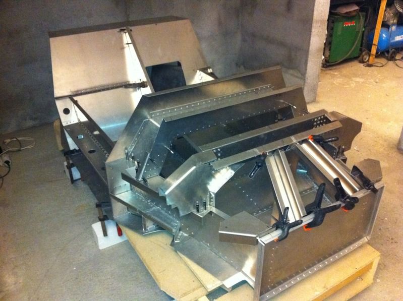

Hi guys,
Just got an update from my friend (Proj_962_Norway) who is building this 962.
He sent me an updated picture of where he's at in the build.
Trond R.

Sub'd this is epic!
Beautiful fab work too.
Has the builder had any other significant Porsche race car ownership/experience? Is this his first total ground up fabrication of a historic race car or has he done others Porsche or otherwise ?
Thanks for sharing !!
