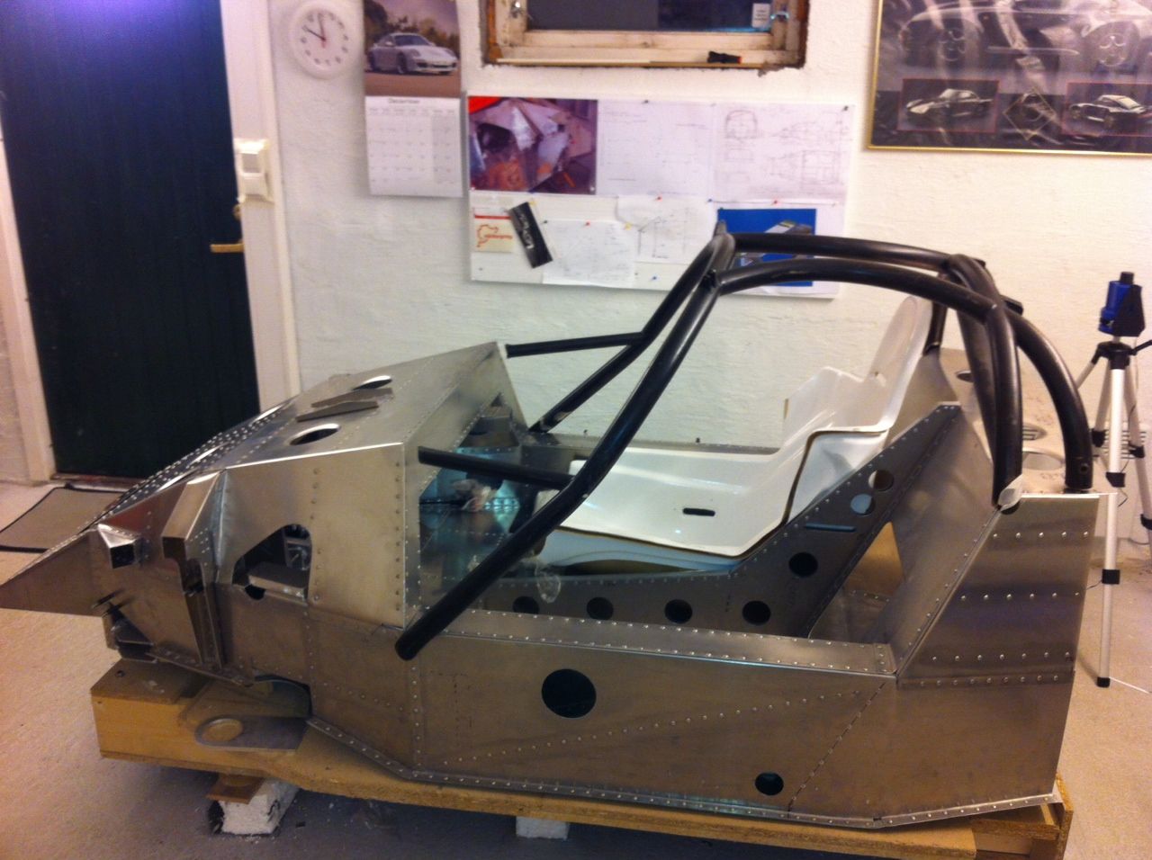

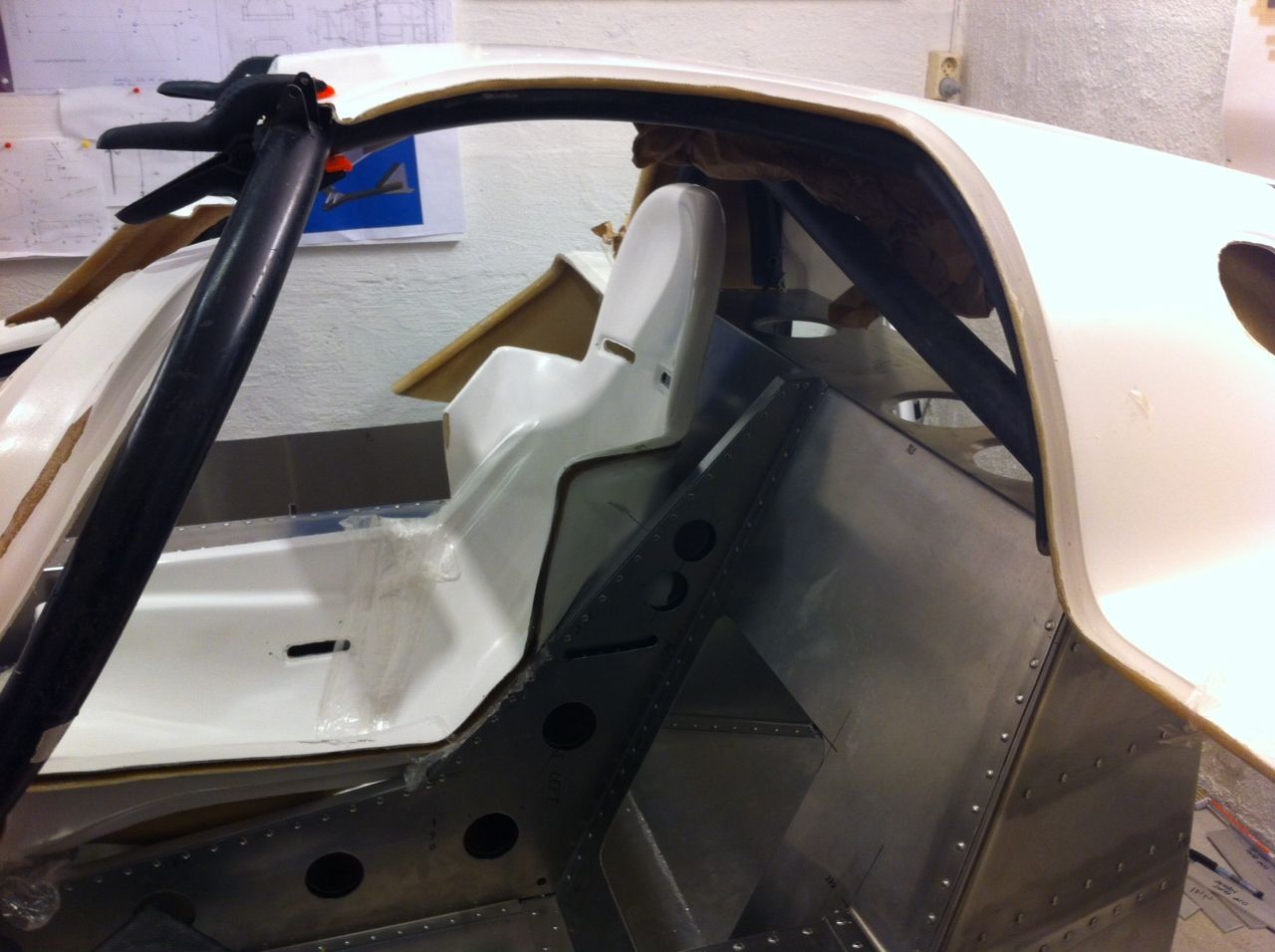

Some updated:-)
Roll cage and some fiberglass parts
The fiberglass parts for the mid section is in place, minus the doors.
Has drawings/files for front section
Trond R.

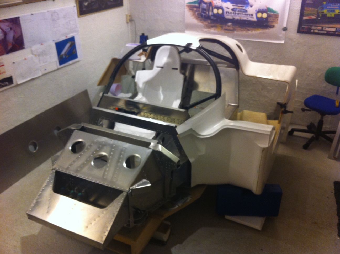

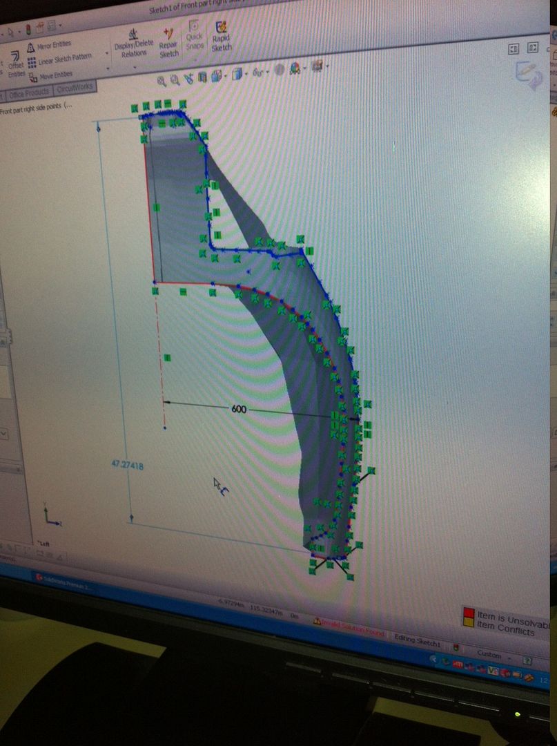

Here is another cool project :-)
Still some hours designing before done
Can you see what this part will is for?

Bell housing with suspension mounts.
You got it :-)

Rocker arm rear suspension bolted to the ends of those arms and inboard coilover shocks were on top along with an adjustable antiroll bar. That reduced unsprung weight in the rear suspension and got the shocks out of the air stream going through the ground effects tunnels on each side.

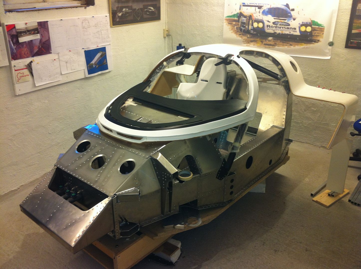

Time for some more update on the 962-N001
Rollcage has been partly fitted, and mid section trial fitted.
Now it really starts to take shape :-)

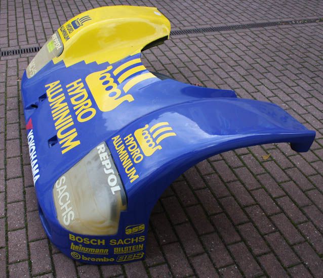

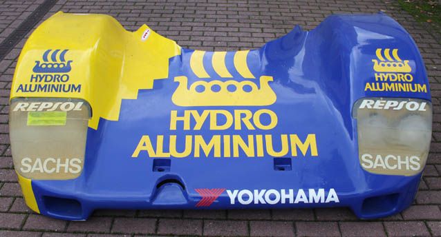

New front arrived:-). This comes from 962-128 that was raced LeMans 1989
