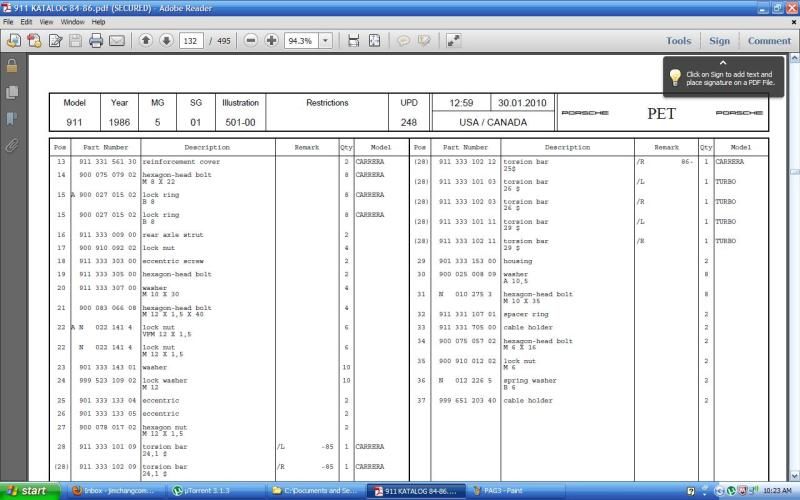

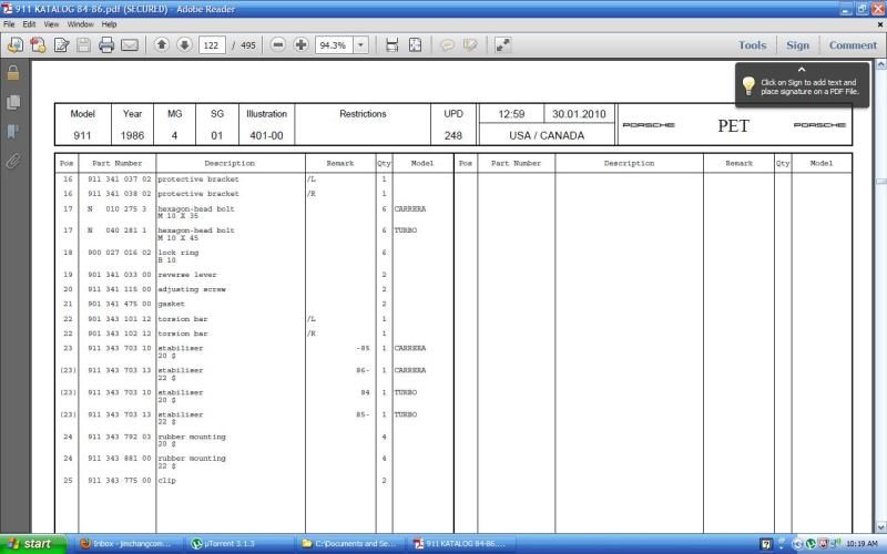

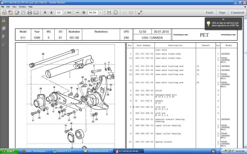

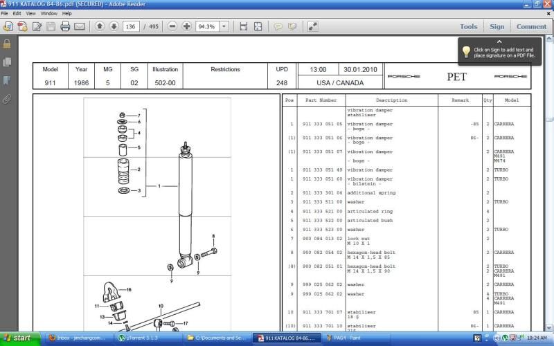

Maybe this will help:
So OP, which is it?
