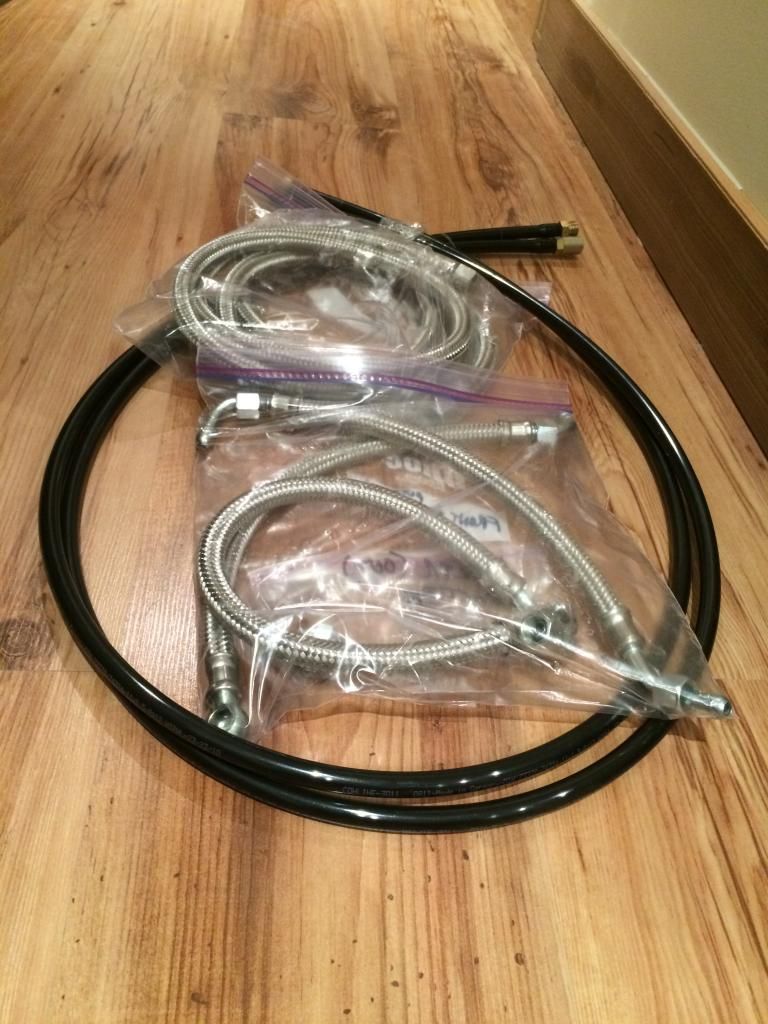

New fuel lines from Len!

Len really knows his hose and fittings. Great resource for people to refresh their oil and fuel plumbing

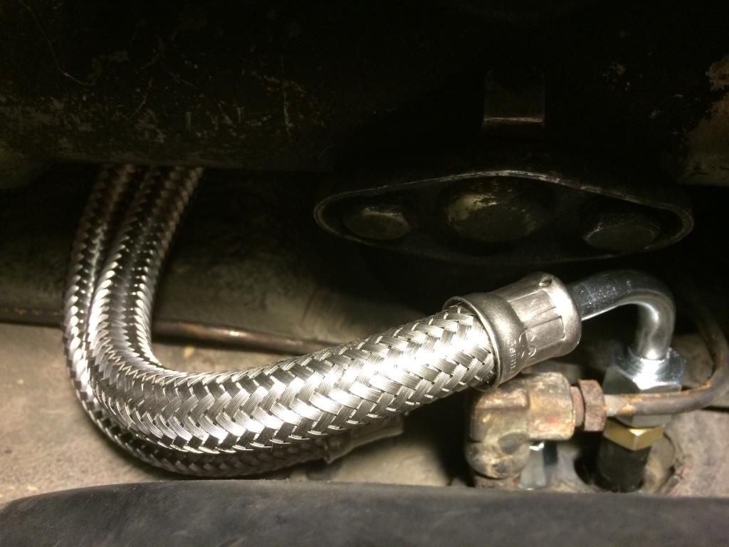

Worked 6 hours straight today, no breaks.. removed all the AC/heater components in the boot and installed the fuel tunnel lines and new fuel pump. Didn't get a chance to install the rear fuel lines. Found out I don't have the grommets for the tunnel lines so ordered those today along with a new fuel tank.
Must say, Lens lines are wonderful, and the adapter he includes makes pulling the lines much easier. One tip though, I read in another thread to just push the grommets into the tunnel and get them later. Did that, but one of them ended up being in the way of me pulling the line.. had to spend a lot of time fishing it out and getting the line through.. but the job was very easy since the engine, transmission and fuel tank are all out
Next step is to rebuild and pedal cluster.. I didn't like the way the wiring looked so I might try to clean that up as much as possible and then repaint the boot area
