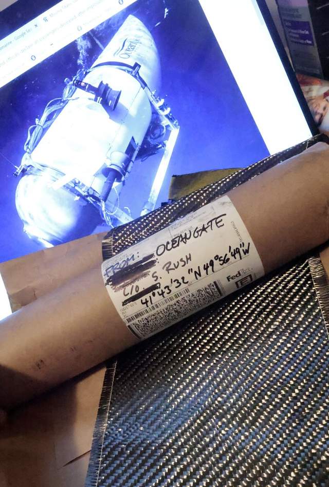

Update on my chainsucked damaged carbon fiber diverge:
This certainly looked like chainsuck, but had just enough going on to make me wonder if I'd started a stress fracture.
Anyhow- Look what came in the mail today!
I got a screaming deal on some carbon fiber. And the owner swears by it.
Second- This got me sanding the frame. I don't think there's any deep cracks/damage. (good news) I will sand some more paint/ filler off the periphery and will get to carbon fibering for bonding. it is interesting to see the different directions/ and filler used on a CF frame. I will overbuild this area, as it will eventually have more chain encounters.
more pics to come-assuming the repair looks good. If not, then no pics.

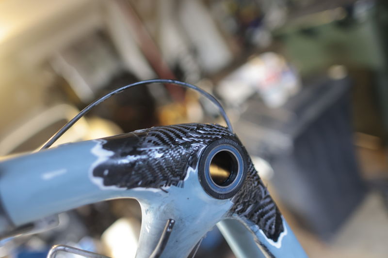

Carbon Fiber update 7/20/23.
Carbon on. This stuff lays finicky as all getout. Not as sexy as I intended with carbon fiber weave orientation, but I realized this is tricky territory. The CF immediately starts to separate. Needs to be canted against itself for strength and not to fall apart on the spot. I am not a carbon fiber expert. This does not behave like your father's fiberglass. I am abandoning any future submarine projects. I should have watched youtube videos before starting. I should have had a way to compress the CF against the frame. But- this is not really structural, it's more protection. Assuming the epoxy dries (it's slowly getting tacky- so hopeful...) I will sand this flush and be done with it. It does barely pass muster with my "looks good enough to post to ppot" criteria, although I am not happy with the lay of the weave across the bb. At that point, it was a matter of survival, not being sexy. I do think the final sanded portion will provide some meat for future chain drops and give me confidence to bomb doubletrack. That's about 3 layers thick at the areas trashed by chainsuck.

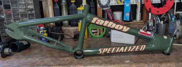

Not mine, but for sale on a BMX forum that I am on.
Looks like a cool project for someone.
To compress the cf, lay it on and while wet wrap the area as tightly as possible with blue masking tape. Really. It'll provide compression and comes off easily, more or less, after the resin cures.
Thanks Greg!
I was also watching some videos on using heat shrink tape. In the end, I wussed out because I was having a hard enough time aligning the cf over the convex shapes of the bb, and, after all, I was really looking for sacrificial layer to protect the factory weave- but next time, I'm going to spend more time looking into compressing the patch. I did sand it out and it looked semi good, and left it naked, shot a layer of clear, mounted the cranks and motored on. Will be hitting "lost river" gravel ride next weekend in WV.
