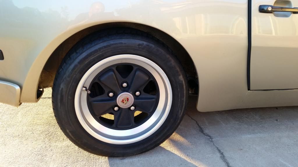

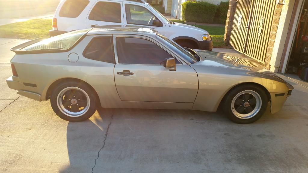

I put these on today finely put the 951 wheels on I have a bad fuel damper, so I ordered a new one from our host.

JAXTURBO your car looks amazing! !
Your'r getting close POPS,well almost
I was just thinking of you today young man! How is life treating you? Did you notice my Escape behind the 944? I hope you,your family and your health is doing good.
