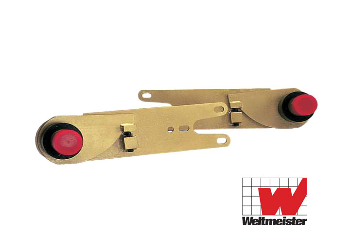

Is the ride height eccentric bolt Jeff / Chris / Jimbo references #18 in the diagram above?
So, let us ASSume "something" is frozen that the race shop couldn't budge, as either A) things were really frozen, or (more likely?) II) they wanted to sell me some stuff and/or didn't want to be bothered w/ such Tomfoolery (if it were Joefoolery I'm sure they'd have made an exception).
What's frozen? The bar / splines? So... if so... what's the DIY Fecal Touch solution?? Torch the tube and spray the beejeebus out of it best you can??? And then???? (NOANDTHEN!!!!)
I am already bumpsteer'd up front, thanks for the mention tho.
I definitely don't want to slam it, just want to dial in some SQUAT like seemingly evvvvvvvvvvveryyyyyyyyyyone ELSE manage's do rock - as seen har:
DAYUM ^that^ is just sexxxxxxxxxxxxx... >shudders<. I'm tired of my 'rake' and it'll look tits AND nipples w/ the Profil 5 18s... once the proppah ride height is achieved. Despite the ignoramus maximus of, well... you now.
ps. Ronalittle... what can I say? Chics dig me.
OK, realistically my fewlish wife didn't know any better at the time when we got together she was 17 and I was rockin a Westybus. 24yrs later and I've got what my friends refer to as "Devil's Spawn"... which is odd as they are (thankfully) really amazing kids and are nothhhhhhing like I was (is) growing up (shiithead). Phew.
Old 03-05-2014, 05:59 AM
Join Date: Jul 2006
Location: S. Florida
Posts: 7,249
Yes it's #18 and the head is super thin and there's no room for a regular open end there because the chassis is so close to it there. You'll see if you look at it on your car.
Also, if you loosen it you may not tighten it enough afterwards and it will come loose. It takes an extra thin open end to acces it and mechanics I know won't touch it, they adjust ride hight by reindexing torsion bar splines.
Along with all this I have Weltmiester adjustable spring plates so I can adjust rear ride hight or rear corner balance in seconds with an 8mm allen head wrench... it's so nice.
Got them on sale for around $300 from a u t o m o t i o n 6 or 7 years ago and sold the stock springplates quickly on pelican classifieds.
Old 03-05-2014, 06:14 AM
Banned
Location: top of 3rd
Posts: 4,336
thanks Jimm'er... $375 shipped today
Soooooo... "just" (famous last words) remove mine, slap those on, and dial away? No initial clocking of the tbars required? While sounds too good to be true... it looks like that setscrew just dials that cam... so... giddeup!
Soitenly not worth dickin around the caveman way then, uh uh. Look pretty simple to install, no? (even for me!)
*their site says fitment for '69-'86... "won't fit an '87".... uhhh, guessing that's wrong?*
How fekk'dup will my alignment be after (yeah I know it'll "change" touching anything, but if it can be 'mostly preserved' until $$$ permits an eventual CB/align - that's what I'm ax'in). If I marked things up etc. OK, I know the answer to that question... just sucks to go have to spend that assload of crink on that - again.
Recall what you sold yer bits for? I'm alllll over ze horse trades, fersure...

When installing the weltmiester spring plates I indexed the splines so there would be a 1/4" gap where the allen bolt is when they are installed at my ride hight. That way I have plenty of adjustment range left.
Use an angle gauge on each spring plate before removing them and when all the bolts are removed and install the new ones at the same free angle.
There is no eccentric cam bolt on the weltmiesters.
I sold my original springplates with the rubber bushings on them for $75. 6 or 7 years ago. I could have gotten more for them, especially these days. I see them sell for around $125 now, maybe a little more if you wait it out.

I'm not quite getting it, but did a shop actually tell you it was frozen?
If you can get one side out you can pound out the other side by inserting a bar (thinner OD than the inner splines) and hammer away. If it is in fact "frozen" it's prob because it's rusted in there which would be advisable to get them out anyway and relube everything. Last thing you want is for them to break while in there. As for getting out a stuck one, you just need to grab on to it and keep working it, leverage with jaws , anything, pound in a bit to break lose , etc.
Removing and replacing the spring plates will really mess up your alignment. Adjustment is with the eccentric bolts 25 & 26 above. It's really hard to mark them and try to get them back where they were.
