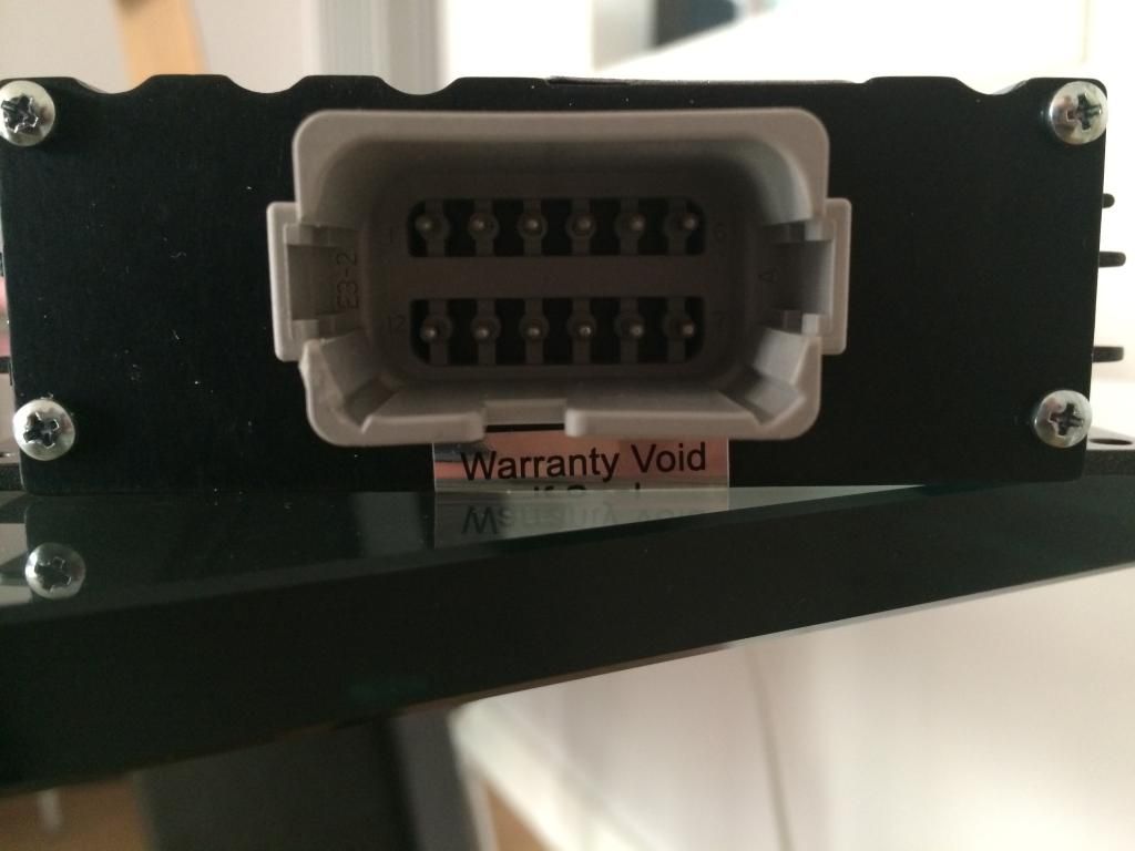

  • Wiring loom. Moving forward, revised quote received, now awaiting revised CAD drawings, but looks like another 6-7wk wait once the drawings are signed off.

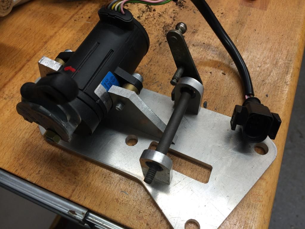

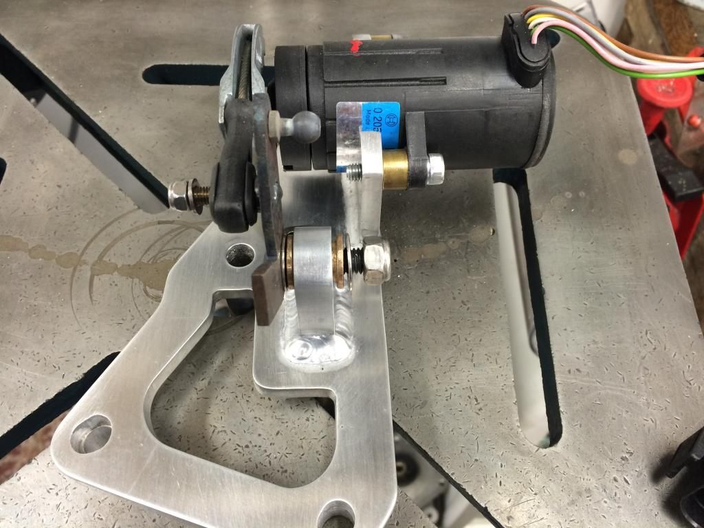

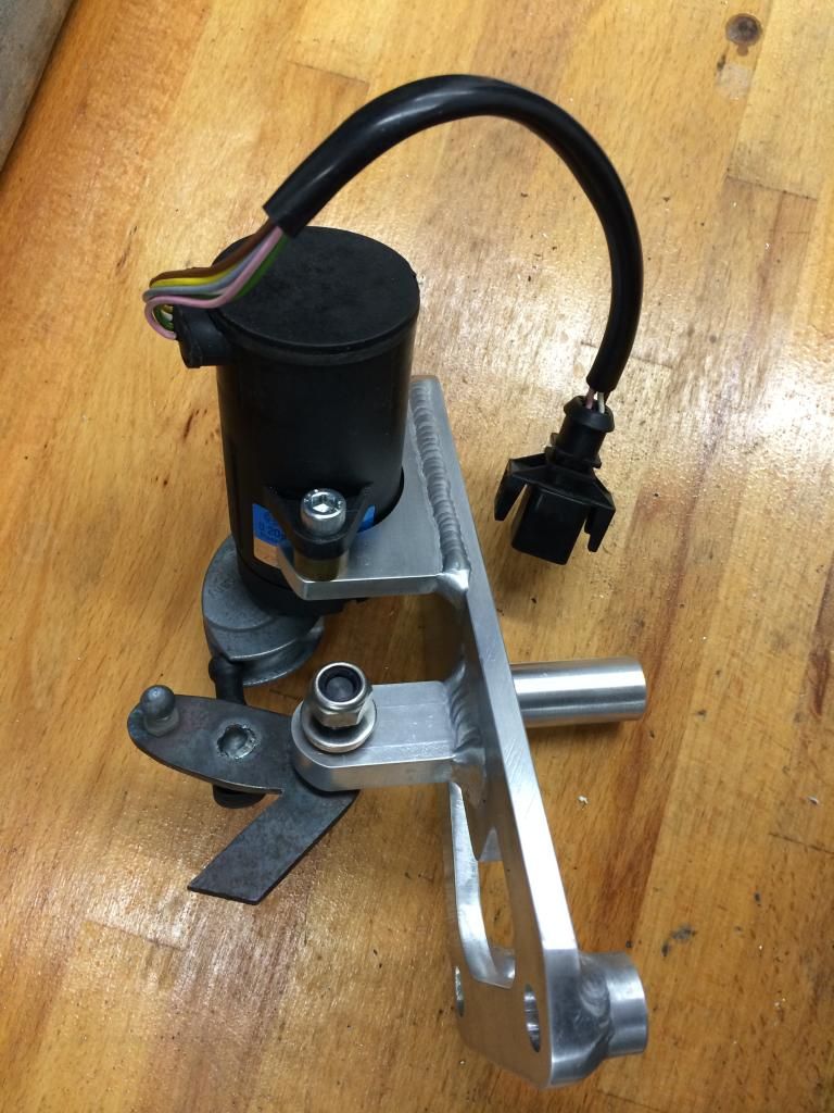

Some pics of the throttle linkage -->
Component parts are obviously just balanced on the bench, but you get an idea of the approach I'm taking. Ignore the rectangular hole in the middle; that was from Plan A when I was thinking about making a plate that sat on top of the original unit. Not going that route now, but when all welded up, the centre section will be milled out to remove that rectangle (and make it fractionally lighter!)
Trying to keep as many of the dimensions and geometry the same as stock, to ensure that there aren't too many variables that could mess things up later on (i.e., not getting full throttle travel)
The spindle in the pics won't be used - I'll make a similar one, maybe out of stainless, that'll run in oil-lite bushes. Another reason for keeping the stock dimensions, even for teh pillars, is that the vertical plate on that spindle has a throttle return stop that butts up against the pillar on shut throttle; will incorporate the same technique on mine.
All looks remarkably simple, but making sure that all the angles and travel lengths are right is quite a time consuming exercise. Fingers crossed it pays off.

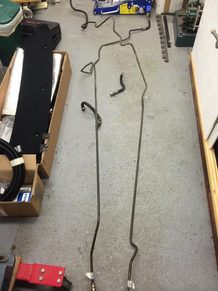

Here you go guys, the post in Robs thread I was referring to with regards to new fuel lines -->

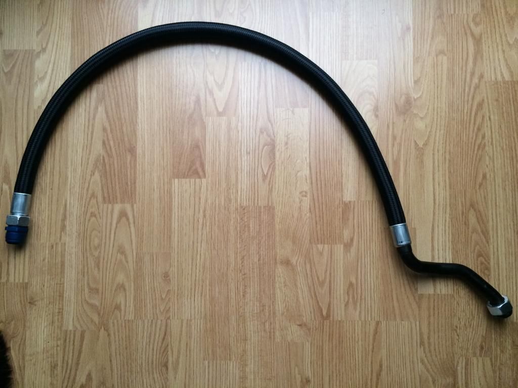

Hi Chris, and thanks!

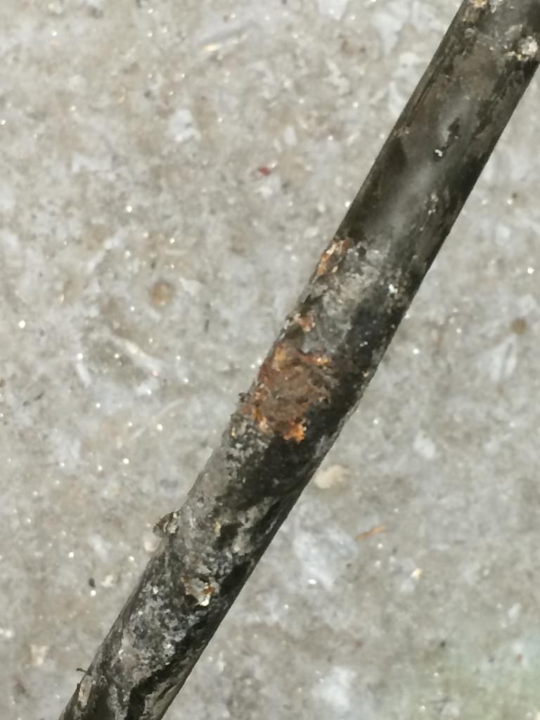

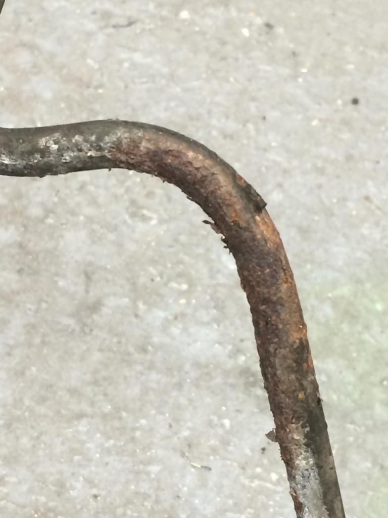

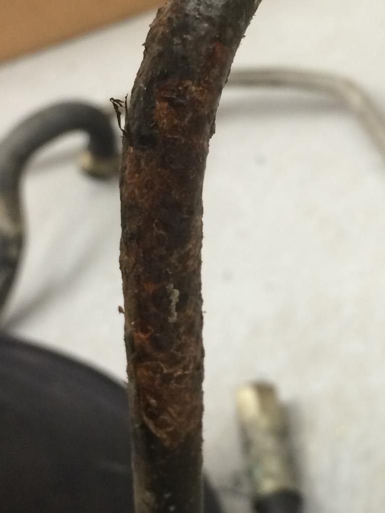

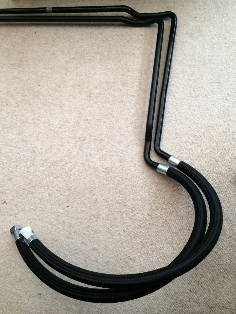

Decided today to go with -6 flexible lines, the same material as I've used on the engine; minimises the number of junctions, and with some decent stainless/rubber P clips, I should be able to tether it along the length of the tunnel.
Progress this evening!
The old fuel lines are now out - a little bit of a wrestle to get them past the LH suspension (the car is still up in the air on the floor lift, the frame of which does hinder the space under the car a little)
Glad I didn't re-use them; found a few spots where rust had set in quite badly. Overall, my car's in very good condition rust-wise (for the UK)....when I compare it to some of the challenges that Rob had with his resto (linked above), eg, the fuel pump cubby hole, mine is mint condition with a lot of the Dinitrol brown waxy stuff still on there...but even so, the fuel lines had started to deteriorate, so any UK guys reading this, thinking that their cars are equally rot-free, please do have a very good look in all the hidden, inside bends of those lines.
Fittings from Think Auto are sorted; a fair size bill but still cheaper than replacing the OEM lines like-for-like (about half the cost)...just need to order the 2 hoses that link the tank O/P to the pump intake, and the return line back into the tank.
Looking forward to getting the pumps and filters in place, then hooking up the lines and fixing it all in place, and finally putting some stuff back ON to the car (fuel pump hatch cover)...probably won't be this weekend though - time to take a brave pill and remove the front clamshell from the Exige to (pre-emptively) replace the (known weak) radiator....am journeying down to Le Mans to see Porsches return to the top class, and sods law dictates that the usual queueing at the tolls, in the inevitable scorching (!) weather, will cause the brittle plastic end tanks to let-go...so, time to fit a nice new thicker core ally unit and silicon hoses. Gulp.

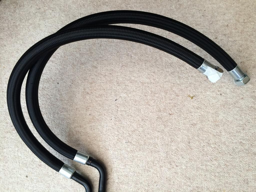

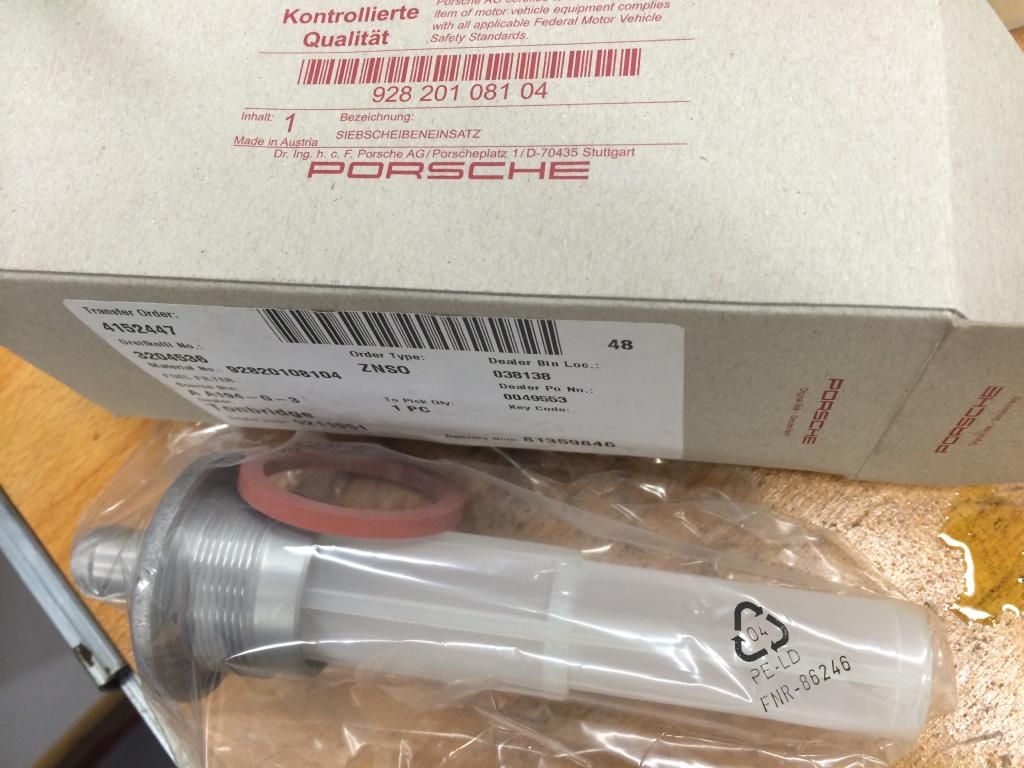

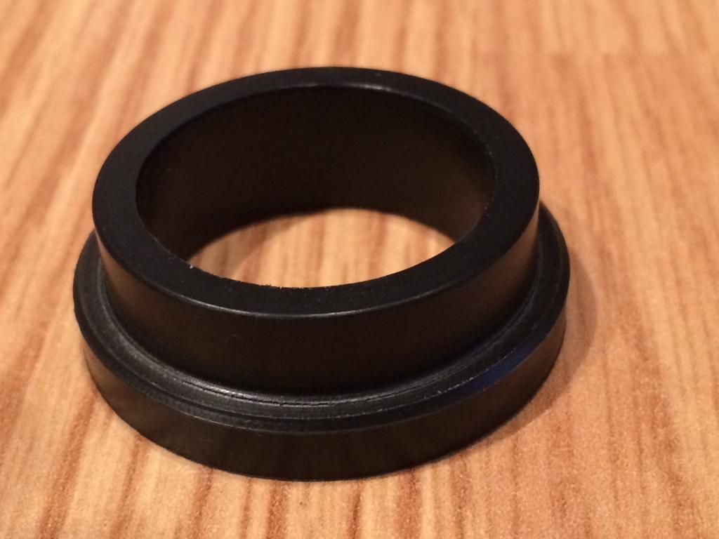

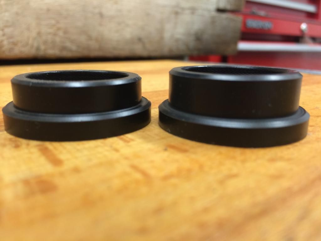

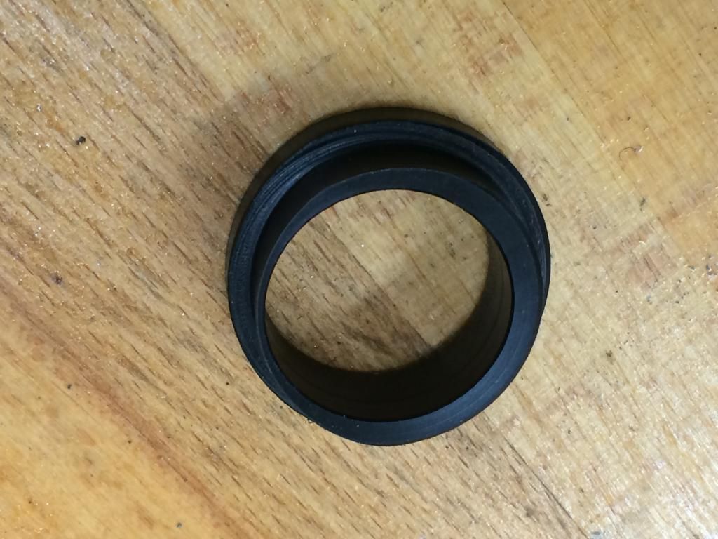

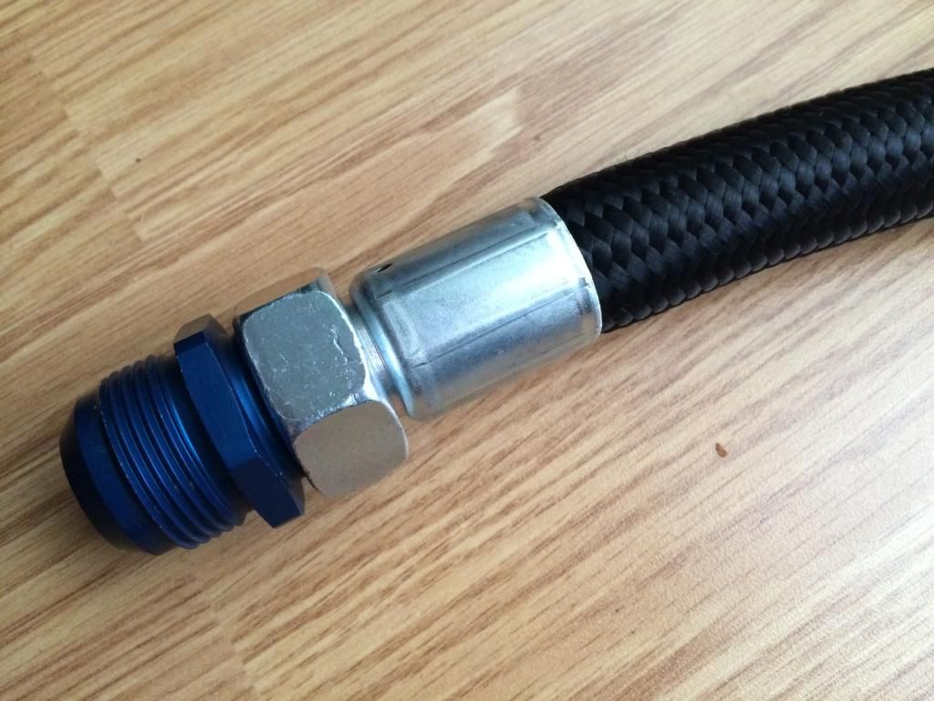

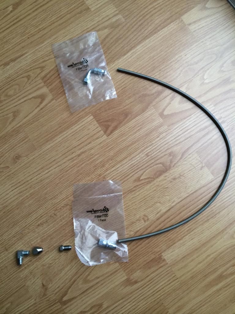

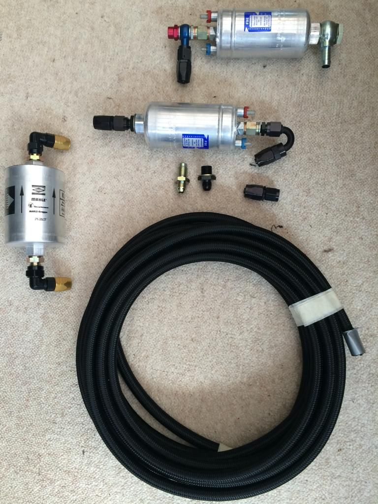

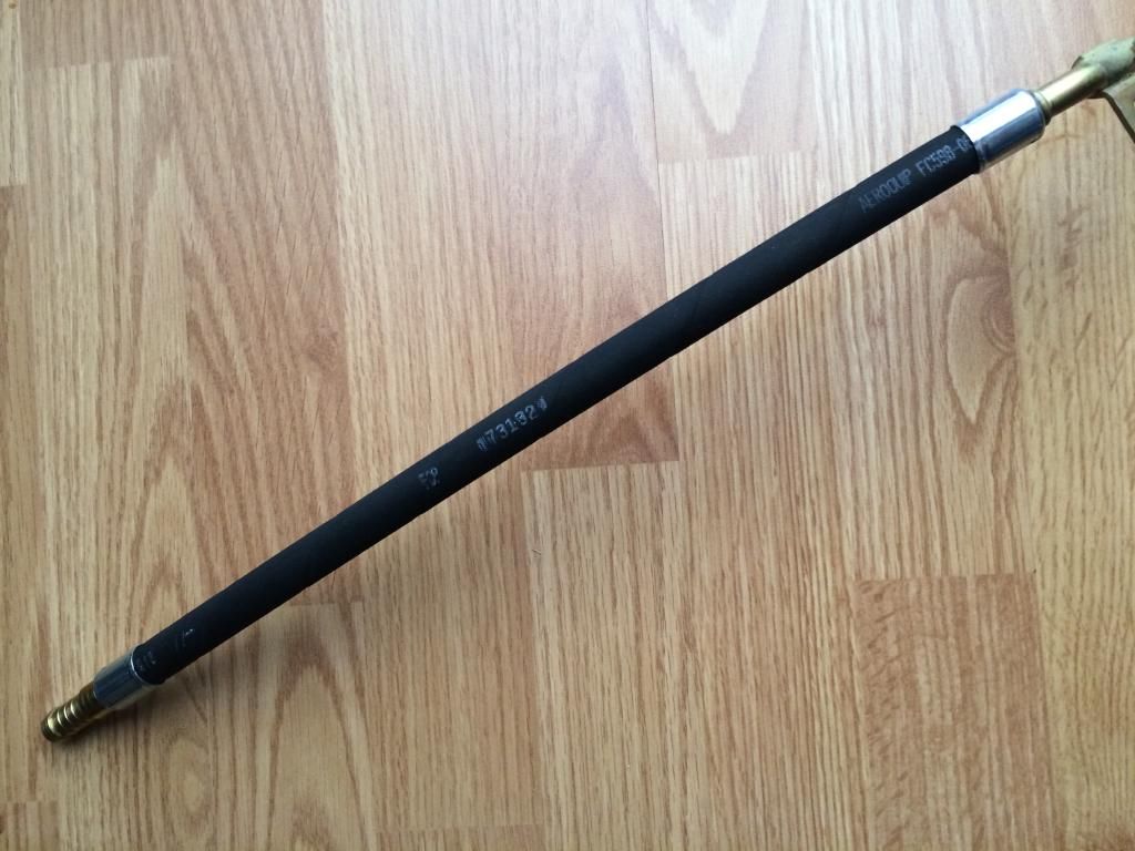

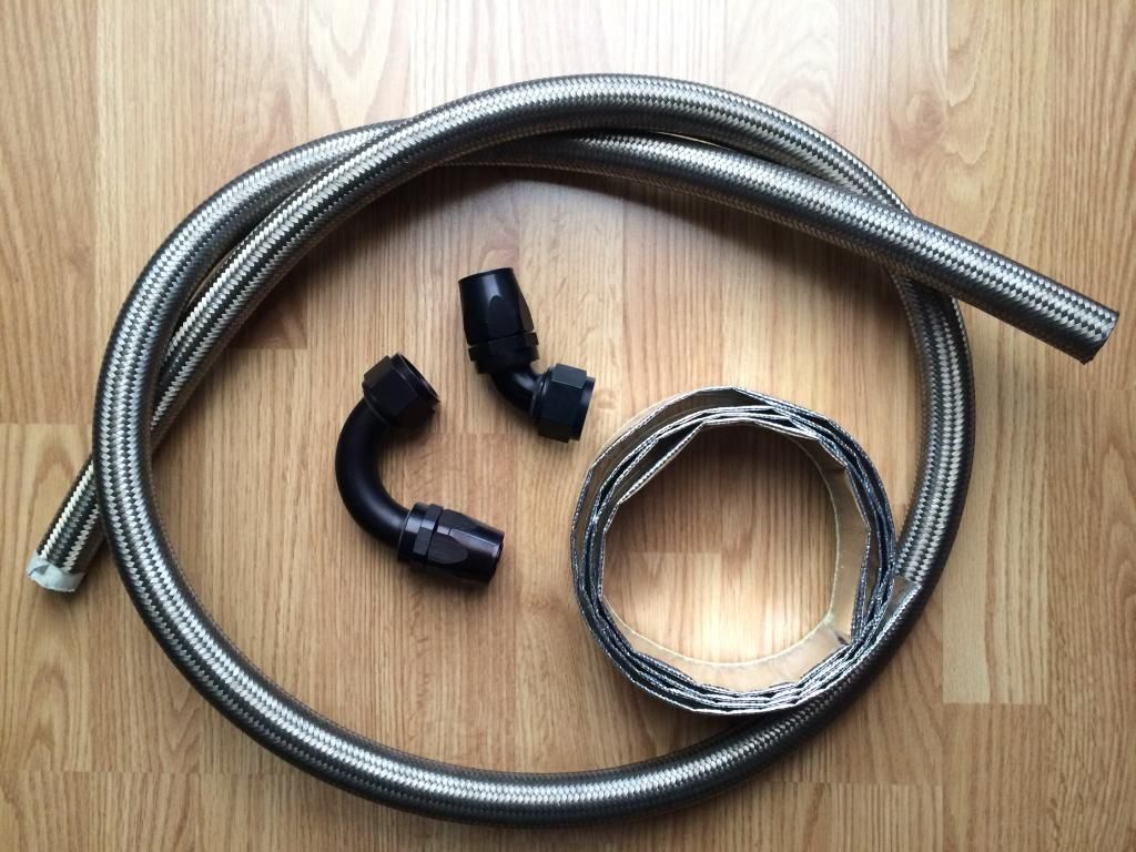

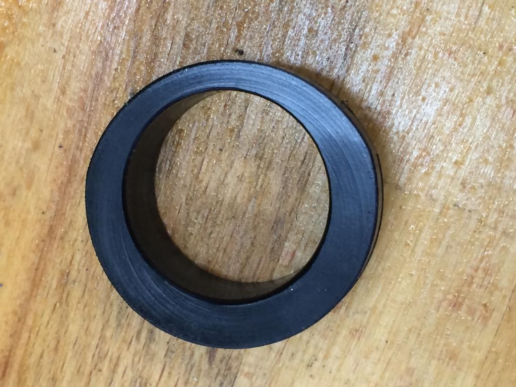

Fuel system fittings....
A quick pic of the parts from Think Auto for the fuel system....just need to order two new hoses that interface directly to the tank (outlet>pump#1 inlet.....and then the return line > tank)
However, one of those hoses is now NLA.....how can only one part of the whole system be made NLA, its a simple bloody piece of hose with a swaged on metric fitting!....the same as the rest of the system!....daft, nevermind, plan B time; will just need to order some -8AN hose with a -6 interface to the line that returns back from the engine.
Still amazed at what you don't get for almost £230! (I already had the 2x 044 pumps and the filter)

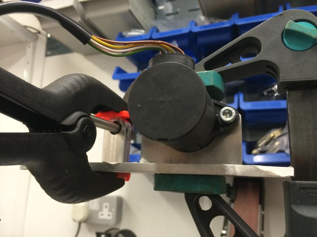

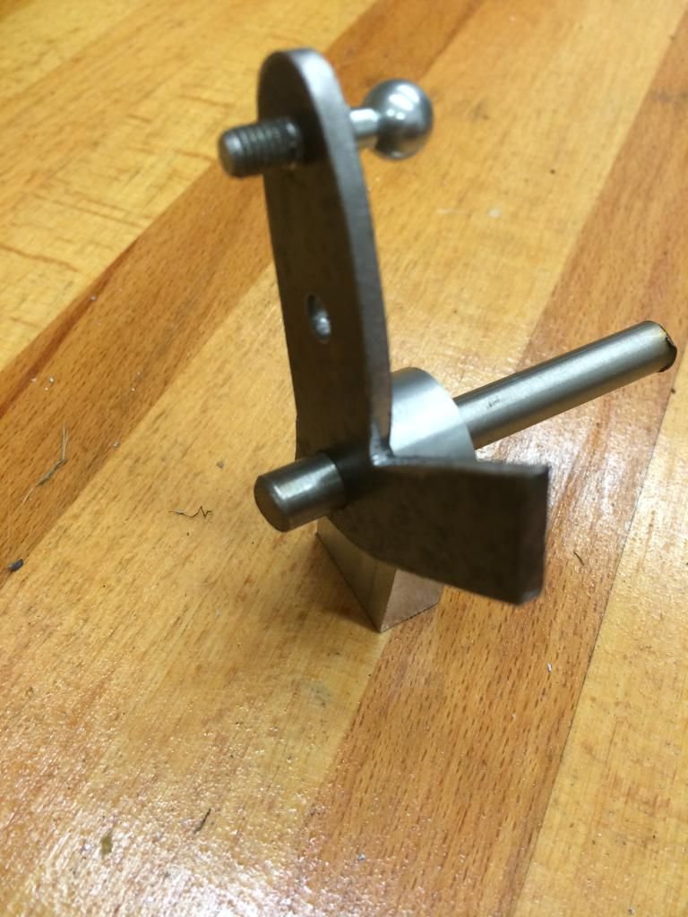

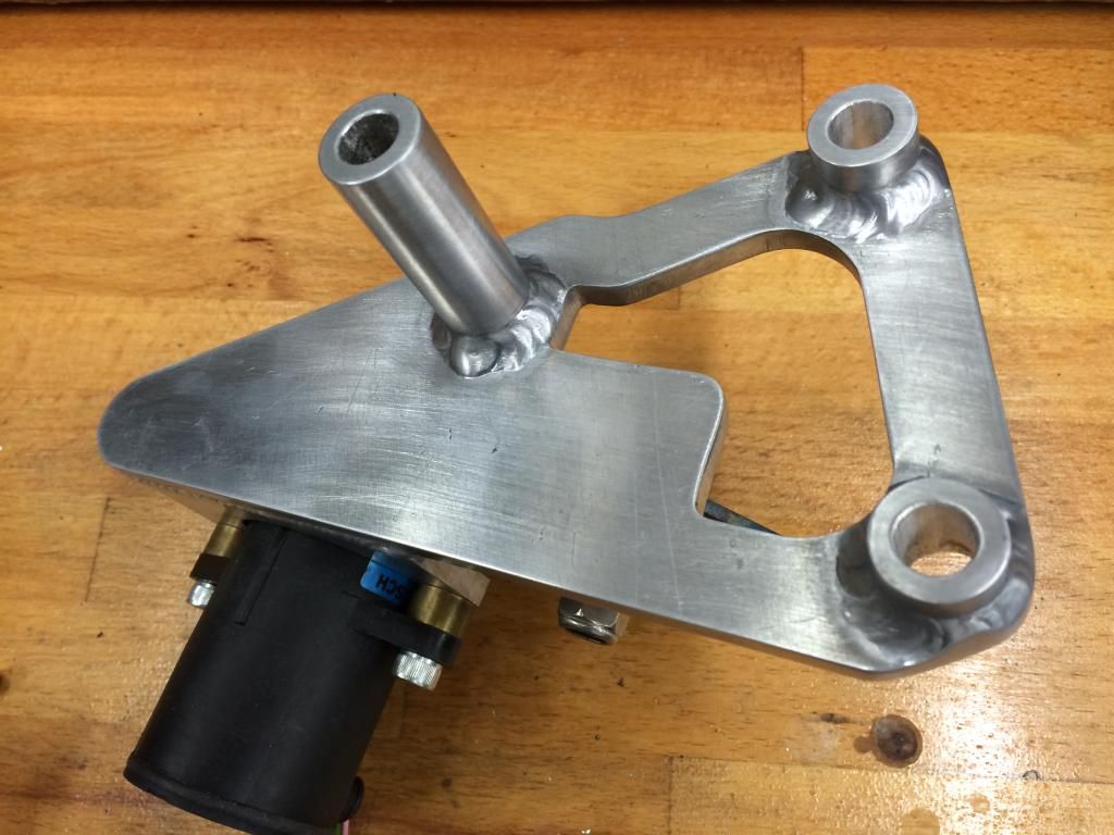

Throttle Linkage
Evening all,
Time for a check-in. Great weekend's progress....distinctly average weather and a weekend to myself allowed me to lock myself in the workshop to crack on with the job I've been naffing about on for ages...the throttle linkage.
It's another case of "I can't believe it's taken this long, with not a lot to show for it". After a significant amount of time spent pondering, measuring, experimenting and generally not getting very far, I ended up Saturday evening a little miffed that another progress-light weekend was about to happen.
BUT!...today, with the replay of the MotoGP (Assen) and watching the Le Mans 24hr coverage I'd recorded (yes, I know....very sad to have both gone there, and also recorded it, but you know how it is....) on the TV as background entertainment, I've almost finished the linkage.

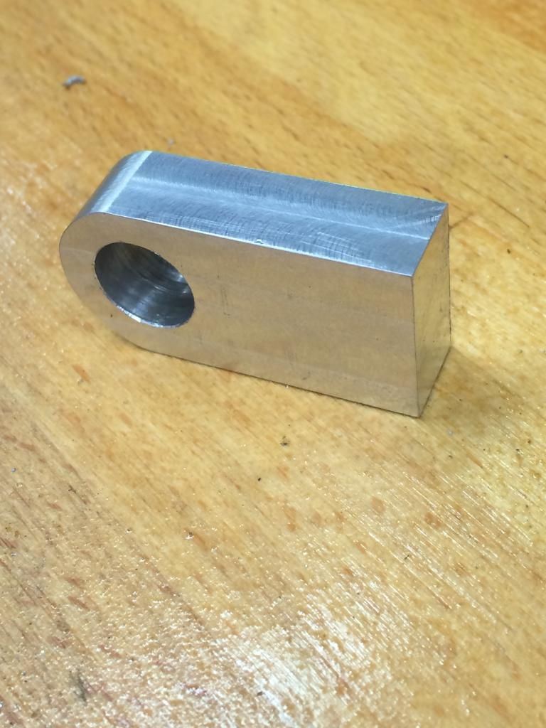

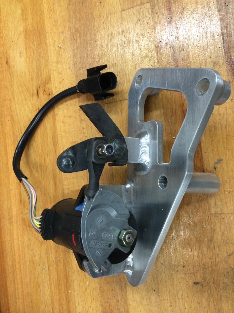

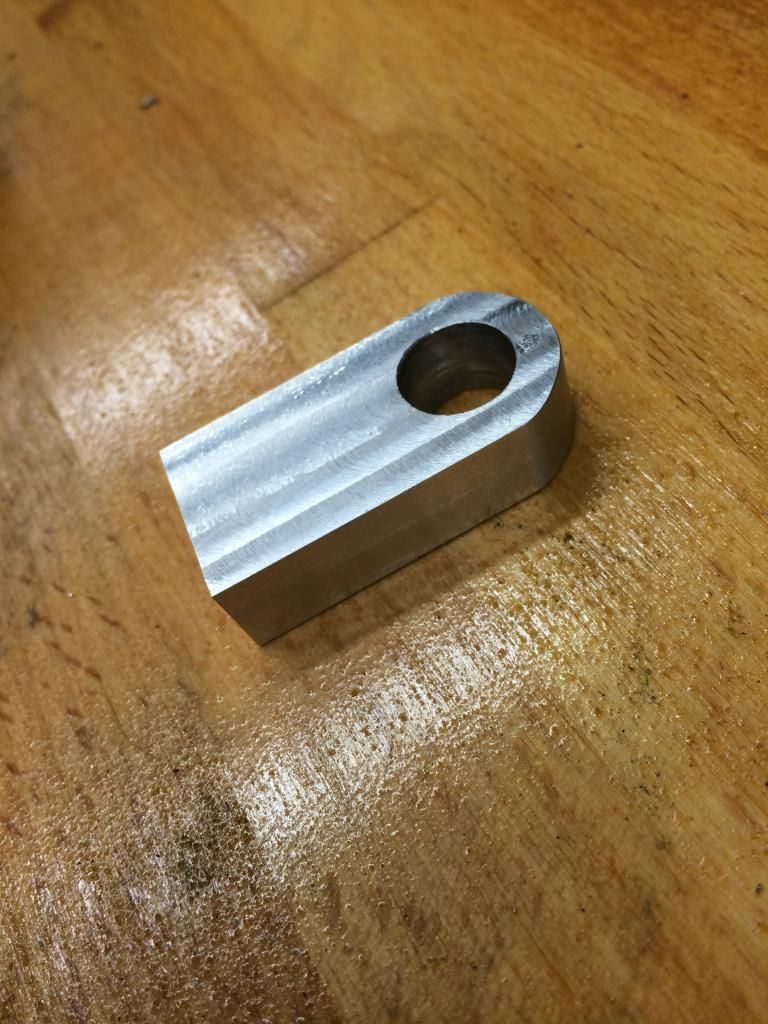

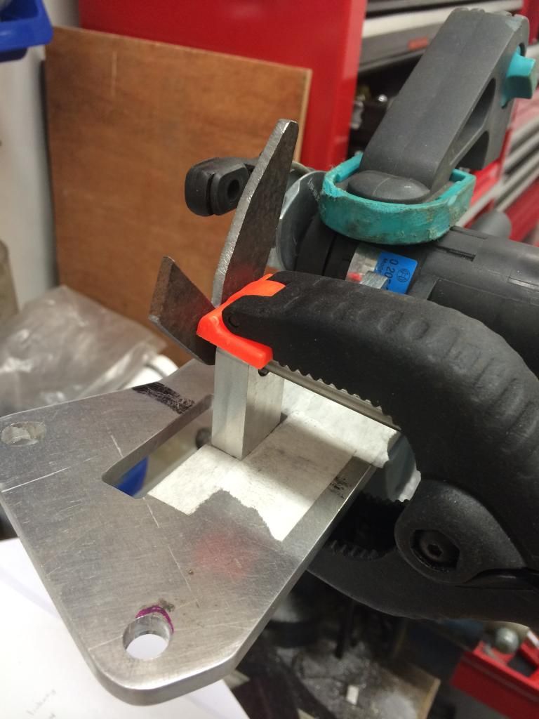

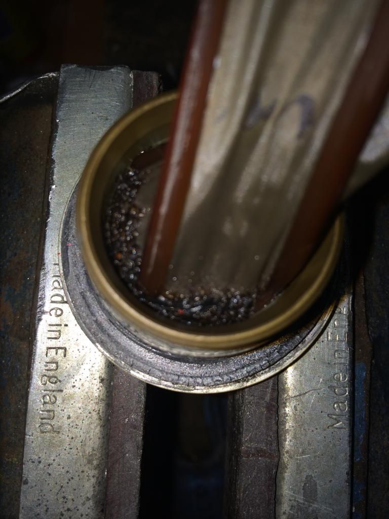

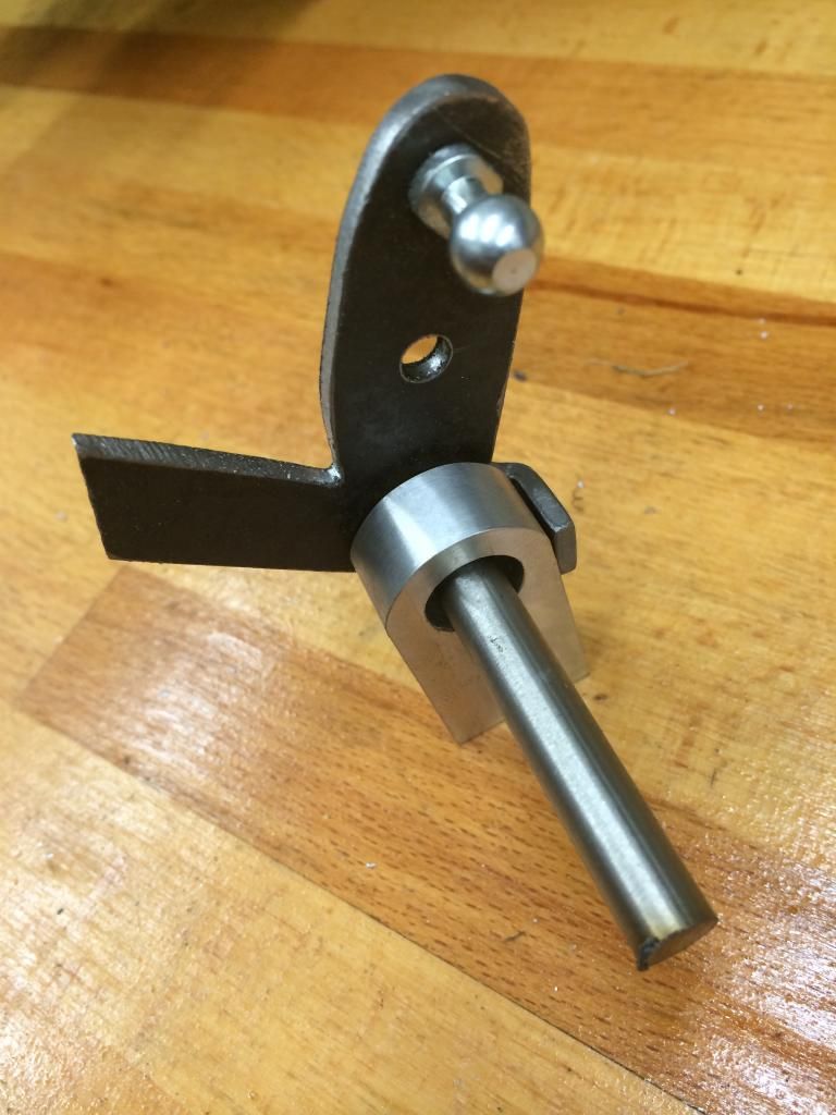

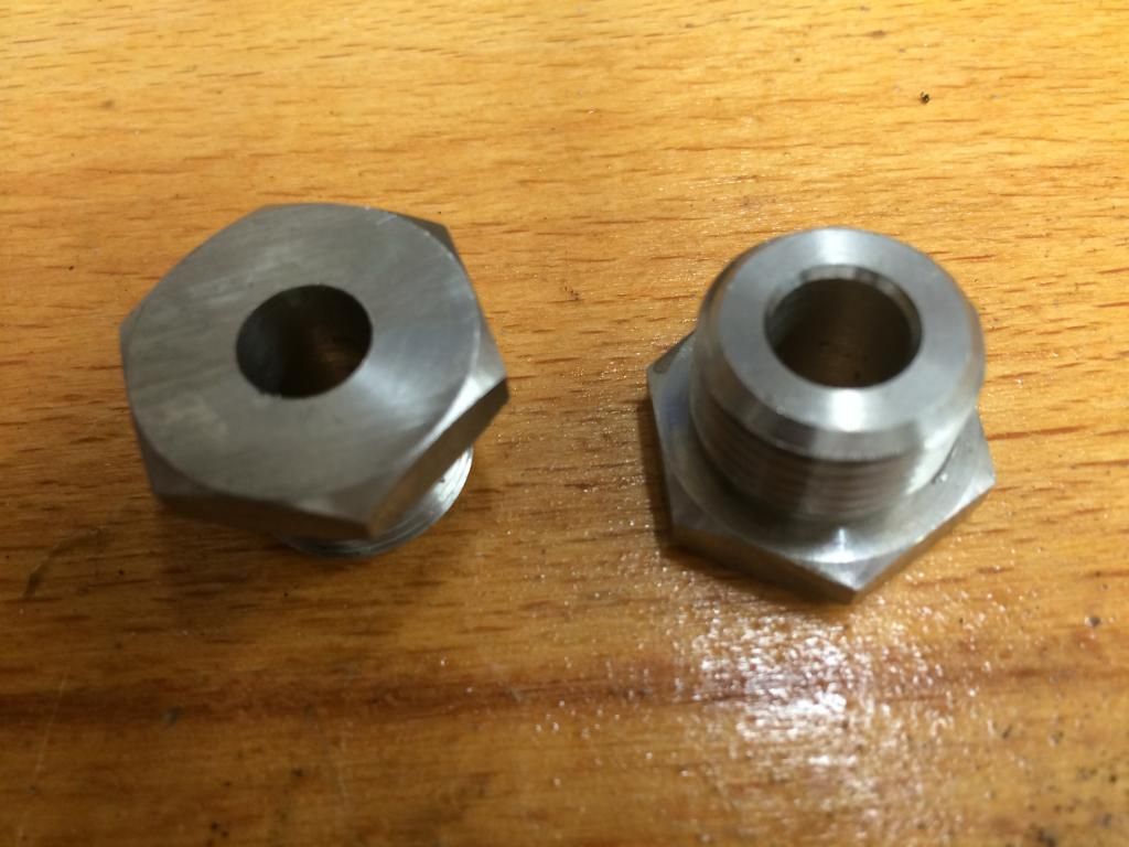

For the first time, I rigged up my pillar drill as a lightweight mill. I have no real need for a dedicated mill, I don't do that much hardcore milling (although that'd never prevent me from justifying getting one in the workshop), so I bought an X-Y table a few months back. With some rigging up, I was able to machine the redesigned central pillar for the pivot bar, ensuring that everything's square:
It worked really well! Obviously I didn't take big cuts, and the speed selection is rather limited by the 5-spd pulleys, but pretty chuffed how it all came out.
Also made some adjustments to the potentiometer mount, specifically I trimmed it down a little, got the edges square to ensure correct alignment when we weld it.
Finally, replicated the pivot arm that the original linkage uses, except reversed. This is the sort of thing that takes the time, ensuring that the dimensions are the same as the OE unit, thus full throttle travel is still OK, but also then working out the max travel of the potentiometer, doing some trig, accurately marking it up and drilling. Also had to ensure the throttle stops were identical....almost finished, got the throttle cable ball joint in (new), just need to turn up a shouldered spigot for the potentiometer to mount on, make the pivot bar itself (the one in the pic is just a piece of 8mm stainless I happened to have).
And this is how it's going to all mount:
So, there you have, an unfeasibly small part of the overall project taking a disproportionate amount of space in this thread! But if eThrottles ever catch-on with these sort of EFI conversions, hopefully somebody can find this design useful.

Ok, another minor update - spent some evening hours getting the throttle linkage ready for welding on Saturday morning; all went well, another sterling job by the boys at Fabweld!
Then last night, time to start lightening it a smidge, polishing it a little ready for final finishing. Still undecided as to whether to black anodize it (favourite option), vapour blast it to try and get it looking as OE as possible, or just leave it polished per below (but may look rubbish in years to come, without any protection on it)
Clearly the actuating arm needs plating; I'm not convinced I've got this part *quite* right just yet, insomuch that the max swing movement of the original lever is 55mm and the new one is only 45mm. Now, whether I can accommodate this with the rest of the cable setup, I need to evaluate, but may need to resort to trying to modify this one, or if I can be bothered (!), make a new lever, pivot shaft and eThrottle pivot shaft.
The throttle-stop also needs to be made, however I decide to do it. The oil-lite bushes also need to be shortened to accommodate the width of the single pivot pillar.
All-in-all, very happy with it though; no flexing, twisting or anything funky that's likely to screw-up mapping due to unpredictable actuation.
On another subject, hoping that the wiring loom guy can come over this coming weekend to have another look-see; we agreed the other day that it's over 1.5yrs since he originally visited to make the mock-up loom; I'm now a lot further along with the build, he's made changes to the way he manufactures and branches the loom out, and we *may* be able to route the harness slightly better through the tunnel aperture, rather than drilling a bloody great big hole in the seat-back bulkhead.....applying the principle of 2 heads are better than 1, then hopefully he can kick this straight off into some manufacturing activity.

Forgive me Spencer, but if the max swing of the throttle arm is shorter by 10mm, won't that limit the power setting? Seems to me you want it to be identical to what the factory did. Why is the arm L-shaped, is that a stop? Will the stop be adjustable?
I definitely would not leave it bare metal given your mediterranean climate. Anodize would look good and it would also help in the areas most likely to corrode-- under the bolt heads and in the holes, when the dissimilar steel bolts start working against it. I don't expect you will be splashing much water up there but it's one less thing to worry about.
Looks GREAT! The last 10% takes 90% of the time. Glad to hear of progress with the wire harness. These jobs are simply a matter of making a bit of progress every week. Trust me, you won't want to go back in there when it's driving.
Hi John, no, other way around...I can get max travel of the eThrottle but by only using 45mm of travel on the lever...the effect of which would be a throttle pedal in the cabin that doesn't move to it's full travel, plus the throttle would be too sensitive. An old "trick" that TVR used on their "Blackpool Bullets" (Cerbera) was to make the throttle travel longer, so it wasn't so hair-trigger like. Same here, if I don't change the linkage, for any given %-age movement of the foot pedal, the corresponding amount of rotation of the eThrottle will be too great.
Am going to either make a new linkage or modify the existing one....now that I have a new set of carbide tipped lathe tools (which arrived this week), I may be bothered and make a new pair of spindles.
The L-shaped part is there for me to then bend into position as a stopper, or cut to length, or.... All undecided at the moment, and stupidly, I'd forgotten all about the steel support bracket that holds the throttle cable in place, which in turn mounts onto the old ally assembly. So, I've now got to cut and modify that (it'd already been re-plated, prob over a year ago and sitting in my box of unlabelled parts!). The steel bracket, however, may also double-up as part of the throttle stop assembly.
Mediterranean?! Haha, I wish!.....Agree, the climate here does mean everything needs plating. It'll look as stock as possible when done; gold passivate on top of BZP.

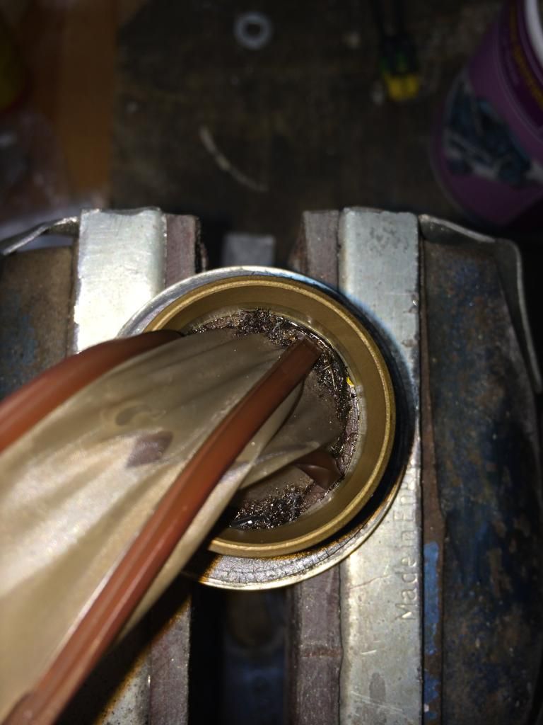

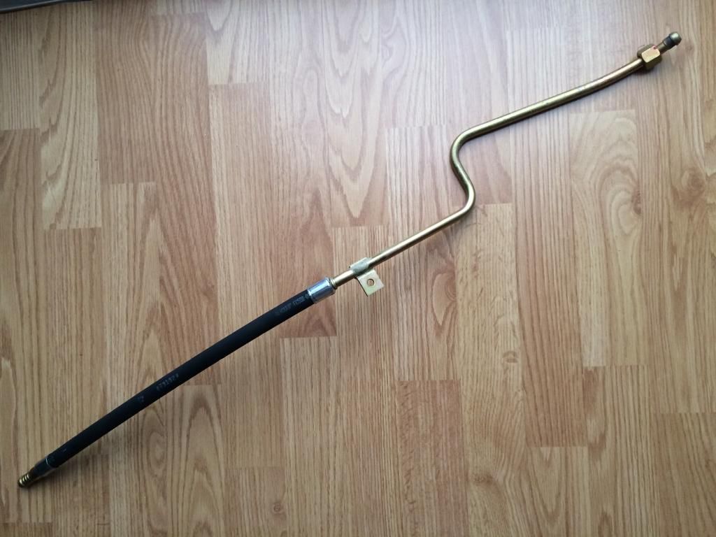

Oil pipes etc
Have now got a lot of the pipes I'd taken off the car re-swaged with new hosing by the guys at Think Automotive...another top-job.
The turbo oil scavenge pipe:
The oil thermostat > engine pipe that sits in the RH wheel-arch:
The 2 x oil lines that go form the thermostat > oil cooler:
Plus, I've got the kit I need to make up a new line that interfaces the engine to the above wheel-arch/thermostat line. The original line is a 3-piece affair, with fairly complex bent rigid lines joined by a 8-9" flexi section, which routes it's way around the engine, under the heat exchangers, etc. When I cleaned up the sorry looking line a couple of years ago, it was very pitted and had what looked to be a poorly modified bend that goes into the crankcase - insomuch that the 90deg bend had looked to be collapsed on the inside of the bend, with some ad-hoc welding...deffo not original Porsche, and limiting oil flow.
A new line? £342+VAT!!!...plus, there's no guarantee that it'll actually now be correct for the new engine; e.g., the old one passed over the exhaust valve cover on one side. However, I'm now running 2 plugs/cylinder with coil-on-plugs, so, could easily have found that the rigid part of the line now fouls them, or maybe even runs where I've made my new oil catch tank for the turbo drain, or any of the additional items on this build.
The answer? Buy some -16AN Aeroquip with some very nice angular fittings, and make the line as a single piece, routing and mounting as appropriate to clear anything that's now in the way:
All the rubber hoses from the dry sump tank to the engine will also be replaced; there a siamese hose that returns from the chimney to the top of the tank on the 964 Turbo which is an annoying £250 but the rest are between £15 and £30 each....still extortionate for a lump of rubber hose; funny how you get used to Porsche pricing to the point where £30 for a hose seems reasonable!
Turning my attention back to the fuel lines, there was one hose I had to partly destroy to get it off the tank; the fuel return line > tank is a short rubber line with a swaged metric fitting to join to the rigid fuel line that comes from the engine bay....it's the only hose of all the ones I need, that's NLA from Porsche. Terrific. Not to worry, another solution from Think Auto, using some wrapped heavy duty 10mm rubber hose with a Metric > -6AN fitting on the end that'll then link up to the -6AN line that'll run to the back. This seems to be a good option; the -6AN fuel line is too small to go onto the tank inlet (10mm), plus by maintaining the Porsche way of doing it, and not having the return line going directly onto the tank, I can then remove the tank easily by just uncoupling the -6 fitting under the car, rather than fight the a clamped on connection up in the fuel pump/tank recess.

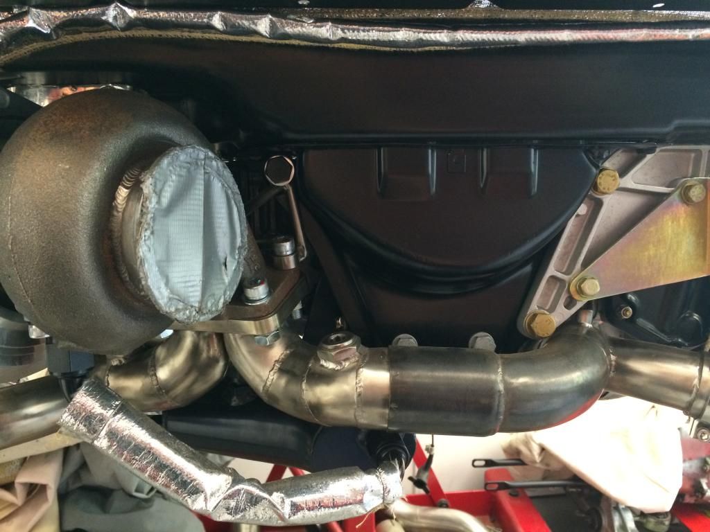

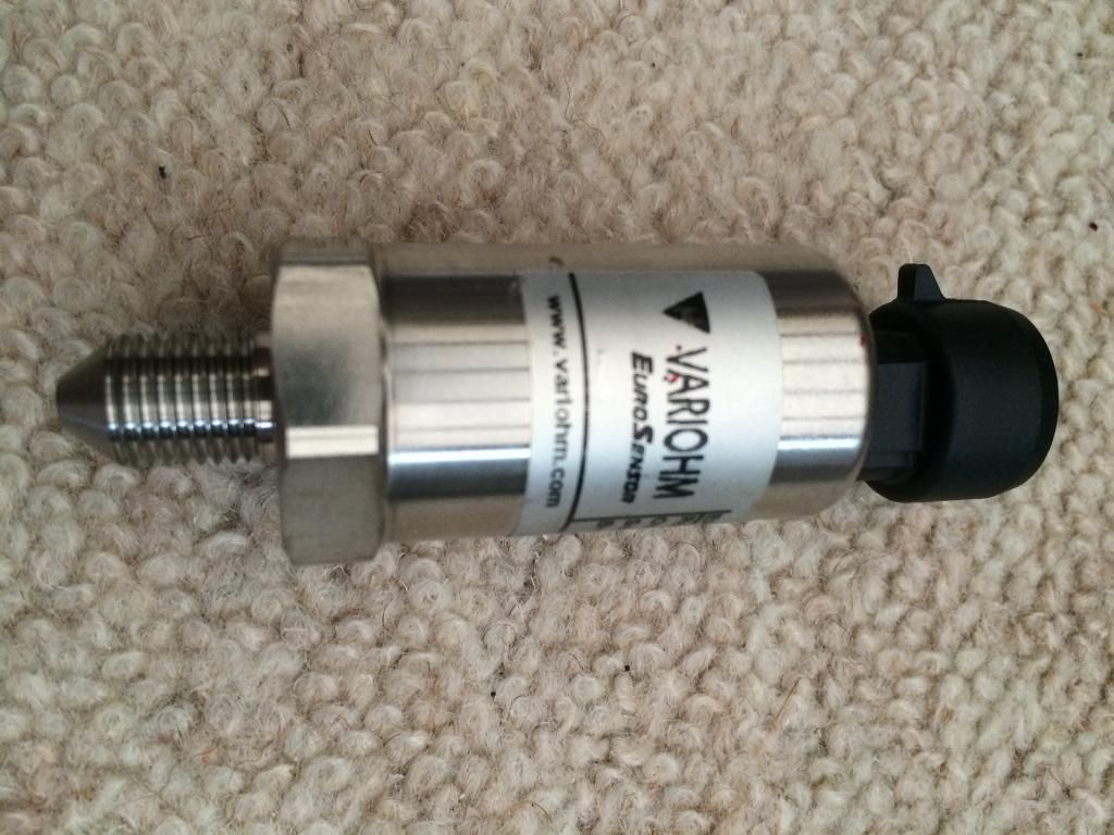

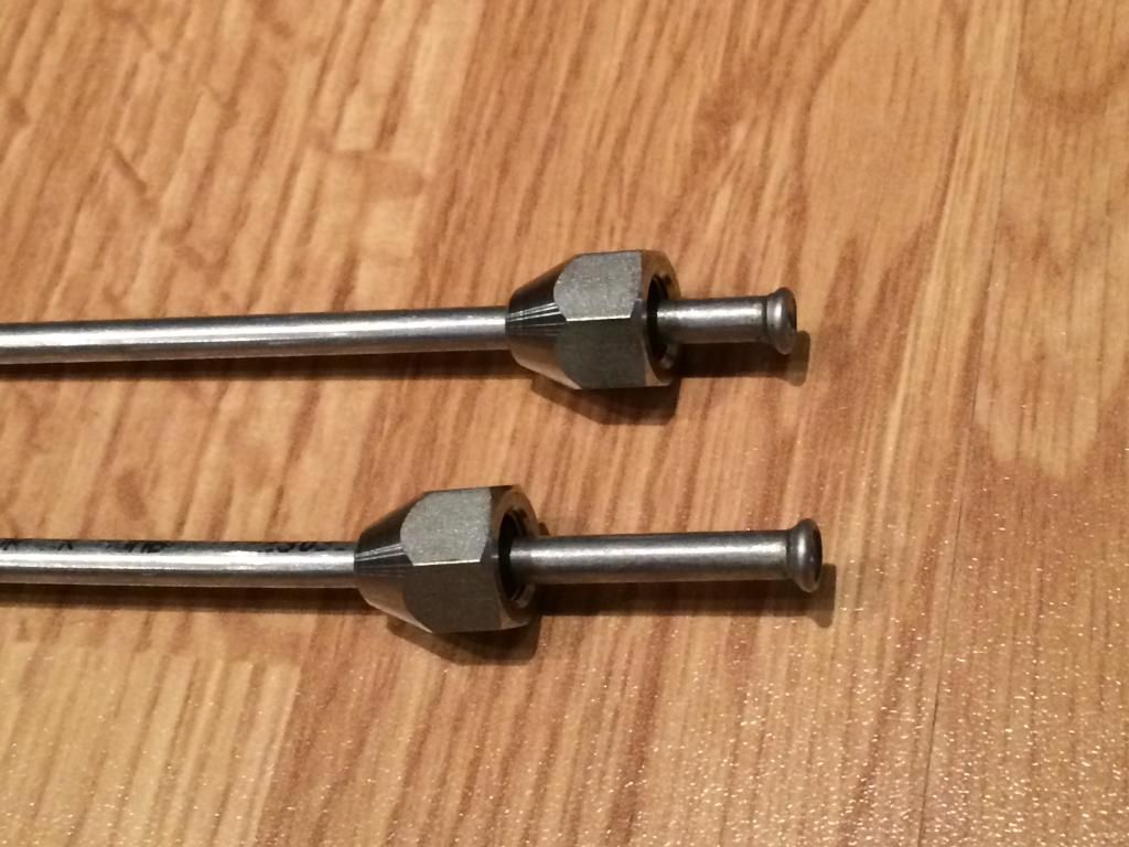

Exhaust backpressure monitoring
Another inclusion to the "rolling lab" is something that Chris @ TurboKraft had mentioned a while ago was trying to include the ability to monitor the exhaust backpressure (EBP). To be honest, I'd not turned up too much when looking for sensors online, so had mentally parked this idea for the time being...and then...
When searching around for a suitable interface to feed the ECU with exhaust gas temperature (EGT) readings, I also found that AEM do a kit that remotely mounts a high quality pressure sensor away from the manifold, using a combination of rigid and flexi lines. However, their kits are $260 each plus the shipping, tax, etc, and of course, I'd need two of them.
Time for another plagiaristic apology; having access to a great plumbing and fittings supplier, I reckoned we could make our own for a lot less. Sure enough, Think Auto had some -3AN (3/16") stainless steel tubing, the Teflon lined flexi piping plus all the -3AN fittings to take a feed from the manifolds to a pair of F1 grade sensors from SBD that match the oil and fuel pressure sensors used elsewhere on the engine. These are proven sensors that are completely linear in their operating range (0-150psi), something that's extremely hard to do (and generally never delivered against in lesser sensors); thank goodness for commodotisation (sp?), as these used to retail for in excess of £400 each a few years ago - now comfortably under £100.
A mate who owns a car garage down the road will use his professional grade brake pipe flaring tool once I've got the rigid lines cut to length. I'll get a cheapy pipe bending tool off of eBay to put some light bends into each one, running from the front of the engine along the top of the exhaust valve cover. The flexi lines will then enter the top of the engine bay via holes in the tinware (there's already one in the left hand side), where the sensors will then mount at the back.
The rigid lines will be 450mm long, the flexi lines will then be 600mm long; the AEM kit uses -4AN fittings, as their sensor has this male thread; mine are -3AN; the smaller diameter should help reduce any accuracy lag in that section of pipe versus the manifold.

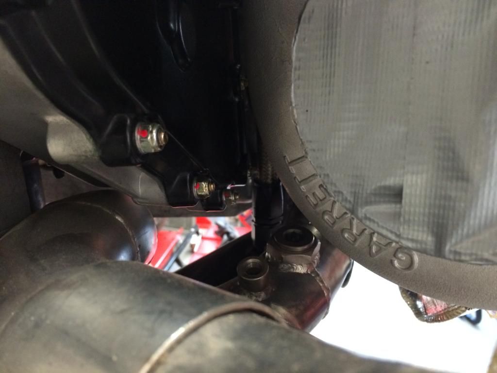

In terms of taking a feed from the manifold, I've been able to re-utilise the erroneously fitted 2 x Lambda bosses. The original plan was to run 2 x Lambda probes immediately before the secondaries enter the turbo flange, but we decided not to do this (instead mounting a single Lambda between turbo exit and silencer input). The 2 x "wrong" Lambda bosses were going to remain plugged with screw-in bungs - which irritated the hell out of me, being Mr OCD - but now I'll use some new hex head bungs, drill and tap as 1/8" NPT and use them for EBP.
The left hand one runs very close to the turbos compressor housing, so have got a 45deg fitting to try and clear it.
The electrical feeds for both sensors have now also been incorporated into the engine wiring loom....time to crack on and make these couplings and get the sensors mounted.

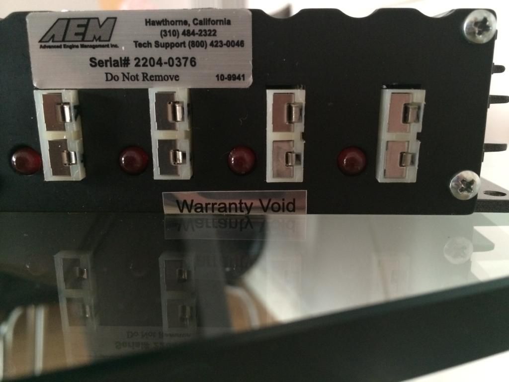

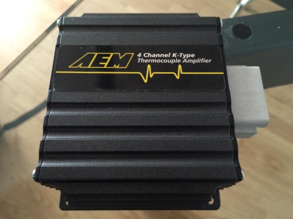

Exhaust Gas Temperature
On another subject, a very quick purchase in order to expediate the wiring loom manufacturing; I confess to not having pulled my finger out to research how we feed thermocouple sensor feeds into the ECU, before we needed to finalise the loom design.
The EGT sensors I'm using are fairly standard K-Type units, but there are complications with how you interface into them; only a mechanical connection (nut and bolt with ring terminals, or friction fitting using a pair of blade connections) is permissible. Soldering another lead onto the sensor is definitely a no-no, as the solder joint creates a cold junction in the circuit, therefore completely changing the temperature reading. Any wire that you use must also be suitable for K-Type thermocouples, ie., solid core....thus, not something you ever want to include into a loom like the one being made - solid core wires being a recipe for future headaches. Also, the heat transmission along the signal path to the ECU is something to be considered.
So, an interfacing solution is needed. Some Googling revealed that AEM make a unit that both amplifies and cleans up (processes) the signal for up to 4 x thermocouple inputs. Some clever A/D conversion, signal processing and then I presume some D/A conversion back again gives a 0-5v analogue output which can then be used to feed an input into the ECU. RS-232 is also supplied, should anyone have the need to interface this way.
I had to move quickly with acquiring this unit, in order to get Simon @ Sileck (the racing wiring loom guy) to build in the power and signal feeds into the harness. Final drawings were almost completed, so was keen not to keep going back-and-forth with unclear requirements and constant changes...sure-fire way to p*** anyone off.
The EGT thermocouples will run as a separate harness to the cabin, and not included in the main loom (per above reasoning). The AEM unit will sit alongside the MBE ECU under the passenger seat.
Think it's safe to say that we've almost run out of sensor inputs to the ECU now!

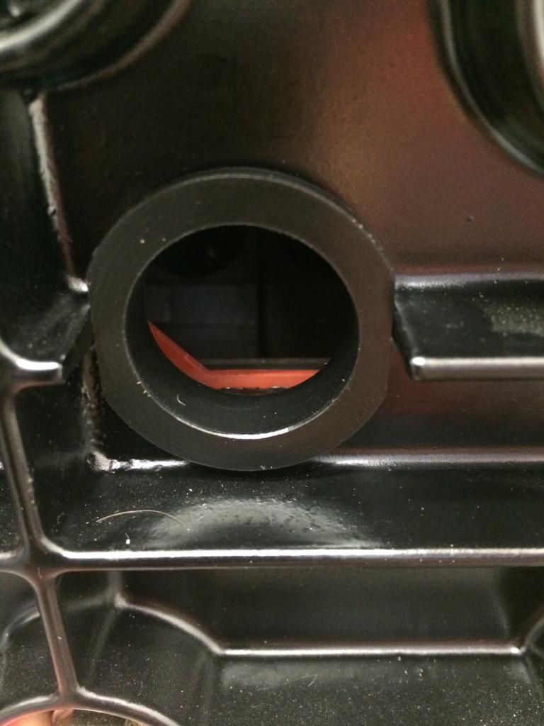

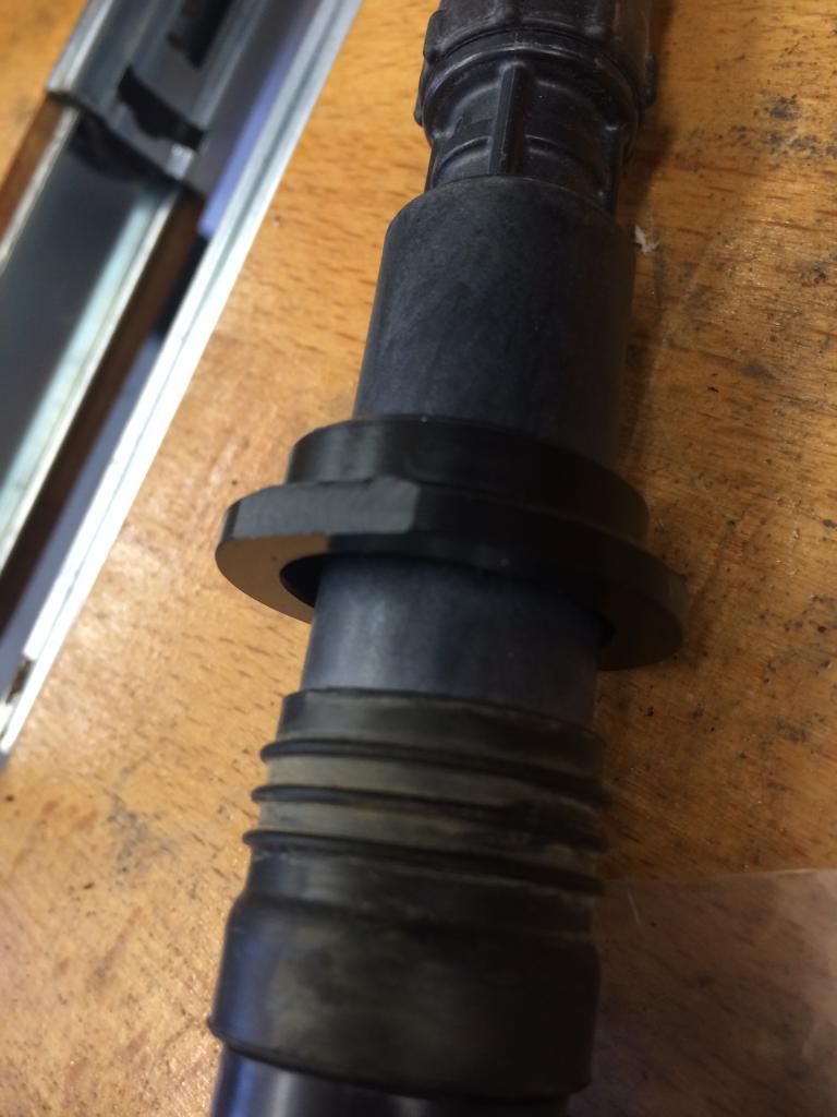

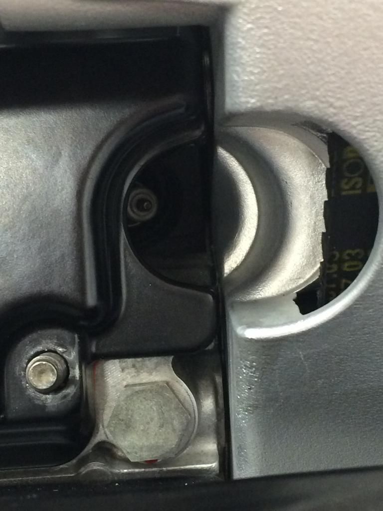

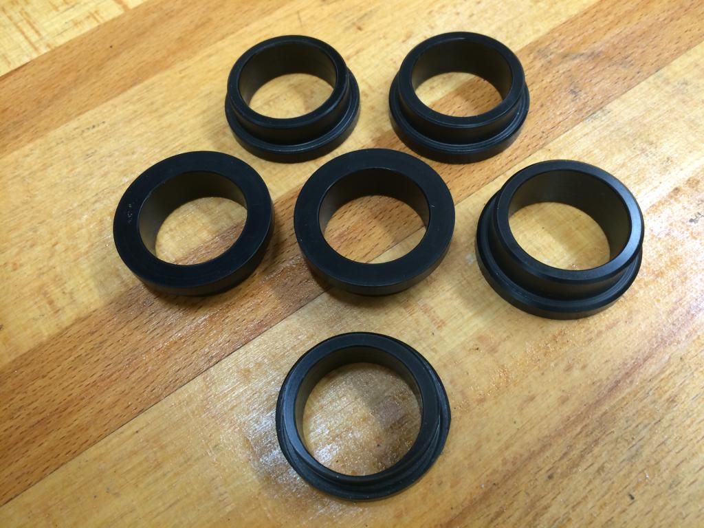

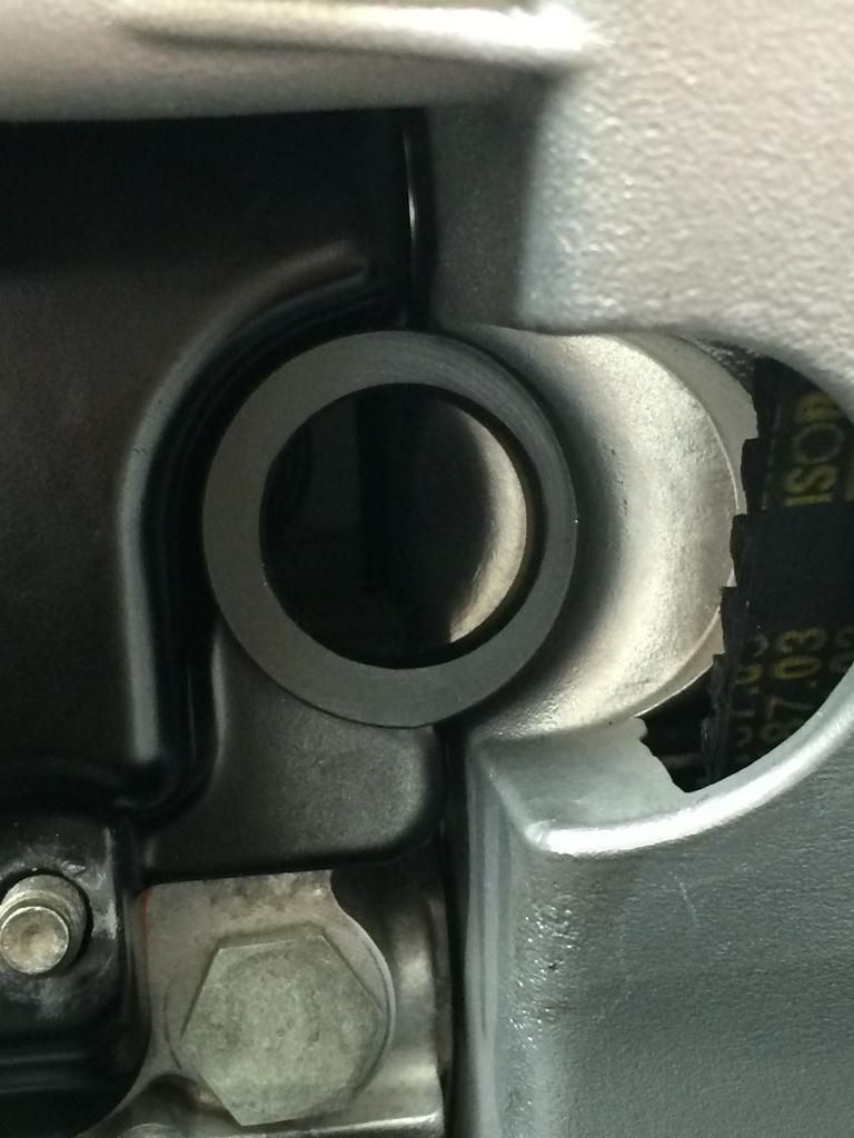

Coil-on-Plug collars

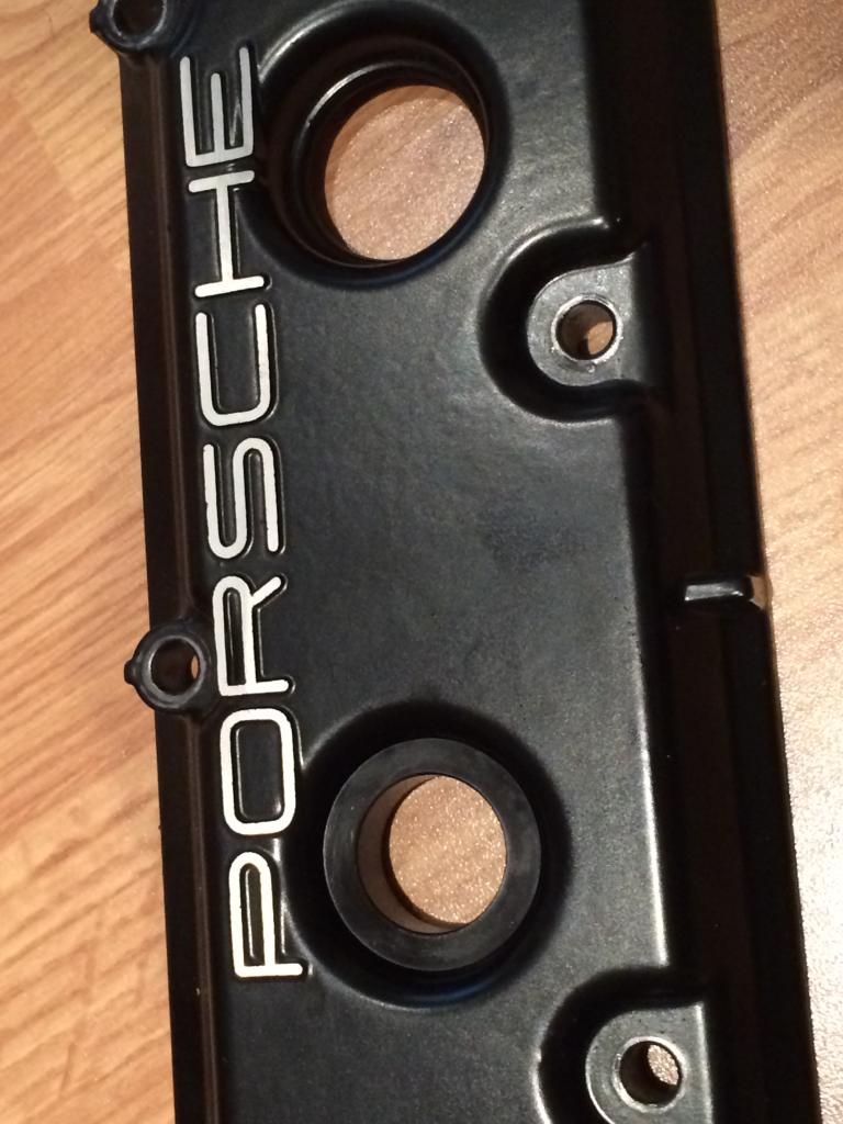

A couple of very productive evenings, spending some "quality time" on the lathe to get the top bank of coil-on-plug collars made.
Four of them are easy; cylinders 2, 3, 4 & 5 are all the same, the CoP sitting fully in the valve cover in whole-holes.
The #1 plug is pretty easy too, but because the valve cover has a semi-circular cut-out butting up against the timing chain housing, the depth of the smaller OD needed to be deeper; +2mm works nicely.
Number 6 is a different ballgame! This is where the semi-circular valve opening then butts up to the casting from the power steering pump assy, which appears "squashed"; its semi-circular shape not being concentric to the valve cover. -->
Now I'm glad I bought that 4-jaw chuck last year
Mounting the bored material, with both OD's turned but not parted-off from the bar of stock material, I remounted it from the 3-jaw into the 4-jaw with a 4mm offset.
Some careful machining later -->
And now a set of 6 ready to go --->
For the bottom bank of CoP's, per previous post, I was going to use RSR style stainless steel fingers to sit on top of the coils, but it was niggling me that all they were doing was preventing a unit from making its exit from the engine.....in reality not something to worry about, as the ratcheting mechanism on the coils is very strong. What the RSR fingers wouldn't stop is the CoP's wobbling about in the (albeit smaller) valve cover cutouts.
So, with plenty of plastic stock left over, I've now designed some similar style collars for the bottom coils, but smaller in diameter; four will require 2x milling operations in order for them to fit inbetween the strengthening ribs on the cover. The other 2 should work as-is, without any machined flats on the larger of the OD's.
Have made 3 collars so far....stay tuned, possibly more on this tomorrow night.

Only had one day over the weekend to get a few odd jobs done, but quite productive nonetheless.
All of the coil-on-plug collars are now finished, very pleased with the lower CoP collars that are a very nice snug fit inbetween the strengthening ribs of the valve covers; there's just enough squash in the rubber sleeves to allow the coils to engage the plugs at the correct angle - of course, they're not perpendicular to the heads.
I also ordered some cutting fluid for the lathe the other week, some nice Supercut 4000 which is far less prone to bacteria build-up, non foaming and translucent, so a lot easier to see the work you're machining versus the cheaper milky solution. As a result, I've now prepped the 2x Lambda bungs (exhaust backpressure feeds), ready for when the 1/8" NPT tap arrives (hopefully tomorrow). These are 302 grade stainless, and I have to say, they machined beautifully....none of the shenanigans that you sometimes get with stainless:
The fuel return hose mentioned previously, is now fitted onto the tank. A new tank filter also installed; was amazed to see how much detritus was captured at the base of the old filter!

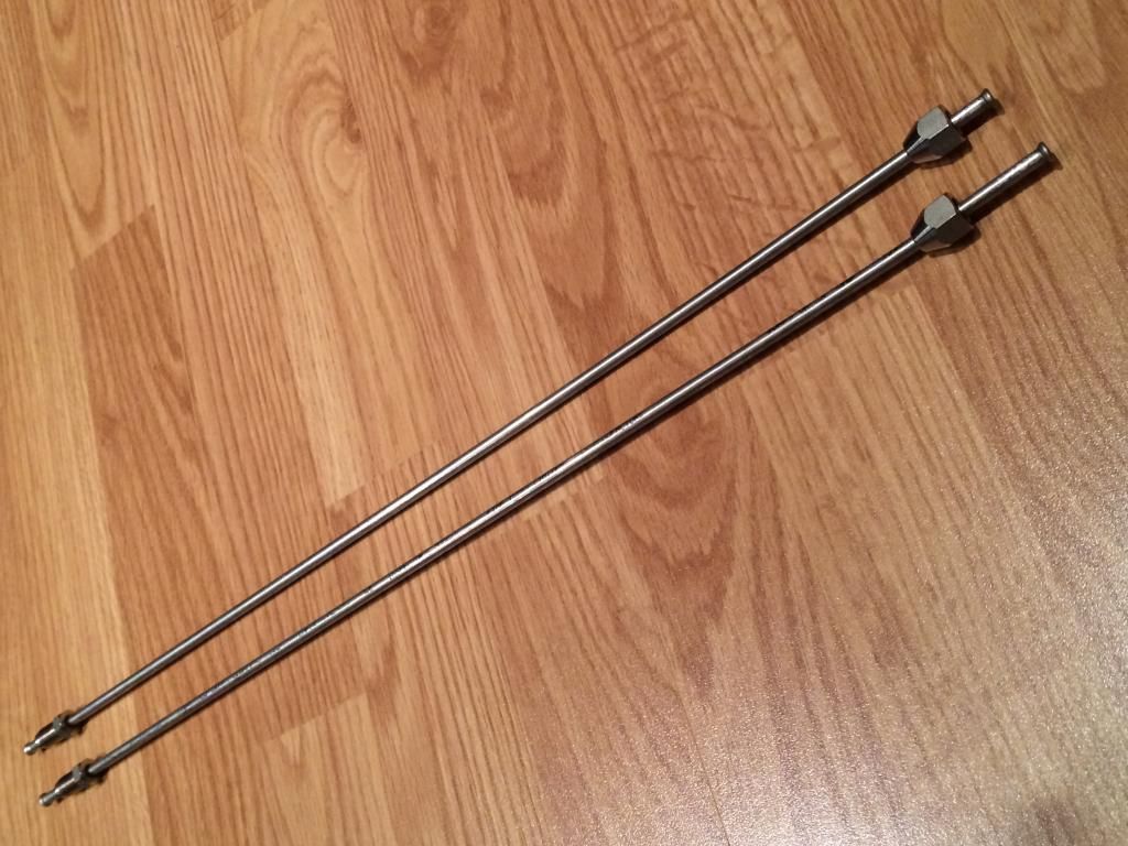

The exhaust backpressure sensor feed pipes are now made; 3/16" CDS stainless with stainless fittings, now flared with single and double flares, ready for hooking up to the flexi lines. Tomorrow lunchtime I'll nip out to collect the Laser pipe bender I've reserved at a local tool shop. If the NPT tap arrives in the post, then I can then get everything hooked-up and start routing the pipes around the sides of the engine.
I also had a go at modifying the throttle linkage, trying to correct the position of the ball joint....not convinced I want to continue with my modification; feel like I'm short-cutting instead of making a new linkage, so may well make new spindles and plate...now that I've got new coolant and decent carbide tools. Bit annoyed by this part, it was "only" 4mm out, but it makes all the difference.
