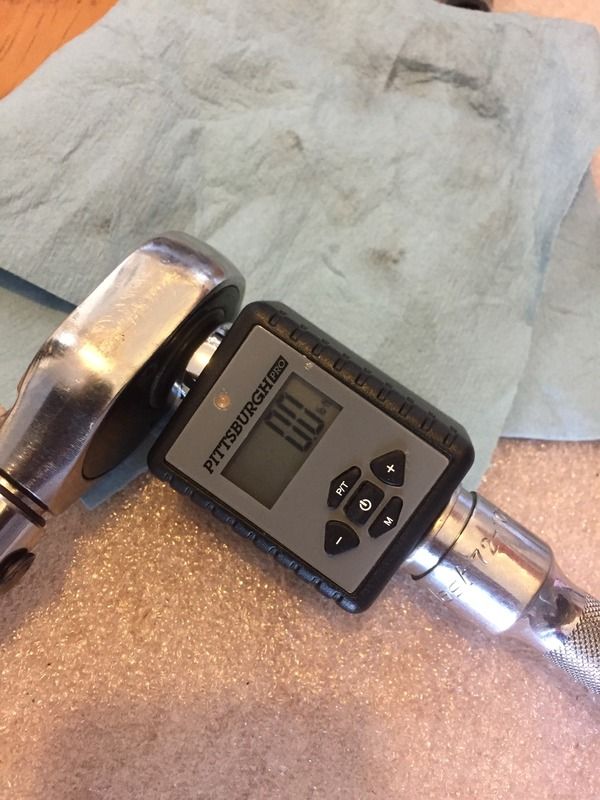

Bought this toy to verify my torque settings, works very well considering it is from HF

I would really consider a bolt-stretch gauge for the rodbolts.
Mine were all over the place final torque wise.
Beg, borrow, or steal one.
Our rod bolts are the weak link being smaller IMO.

Yeap
Will redo with gauge Master KTL lent me

Verified:
0.0105"
Surprising, for a POS HF unit, but it wasn't typically cheaply priced

Posts: 9,195
You're stretching 10-thou? Forgot it was that much!

Yes sir, ARP spec states .0100-.0105" or 40 ft lbs
