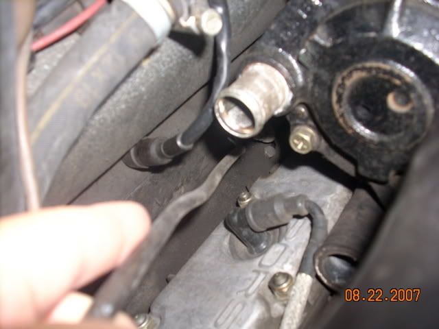

Most smog techs aren't used to looking at a flat-6 shoehorned into a rear-engine Porsche. Their confusion works to my benefit. I've never had an issue with the "visual" inspection.

I got through smog last month. My car is stock (as far as I know, though the boost gauge pegs out at 1.0 bar, I've noticed). Nevertheless, headers, cat, and muffler are stock. Motor's never been open, again, as far as I know. 80K miles.
California has 2 parts to its smog certification. One is the actual emissions part. My smog pump is disconnected (though it's still there), and the car passed the sniffer part of the test, as it has in the two other states I've lived in, as well. But California also has a visual test, where the mechanic doing the exam looks at the engine bay to see if everything's OEM. Somehow, he must have missed the fact that the pump wasn't connected. It wasn't for lack of effort on his part, though, as he spent a good 10 minutes looking all over the place with a flashlight. The other mech standing next to me and shooting the breeze noticed it and quietly mentioned it to me. So whether you get called on the air pump issue will depend on luck of the draw.

That is phenomenal! So just to clarify... have you also removed all the other hoses associated with the smog equipment?

Yes, I sneak through (but I never thought much about it). My CAT was fried, so I purchased a brand-new one a couple years back. No problems with that thing bolted on the back.
Personally, I'd look for a car that has proven itself to pass California smog before I'd buy it. You can really get stuck with a big bill if that thing won't pass and you are holding the ignition key in your possession.
I wouldn't take the current owners word... Can they run the "California" smog tests on it in another state to see if it will pass?
To protect my innocence from the internet police, I haven't done squat; it was the PO's fault. Nevertheless, while the hardware is still there in my car, it's certainly disconnected, as is the O2 sensor.
